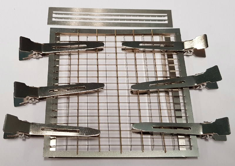

After the windows and lamps I dealt with the fan and the fan grille.
The individual parts for the fan grille are separated from the etching plate.
The slats are rotated and erected around 90.
The 0.5 mm wires are indented and the combs of the teaching are inserted. For soldering everything is held together with brackets with the soldering I can start so in the middle.
109 soldering points later, the grid is soldered.
All the bars and the frame are separated, everything is cleaned.
