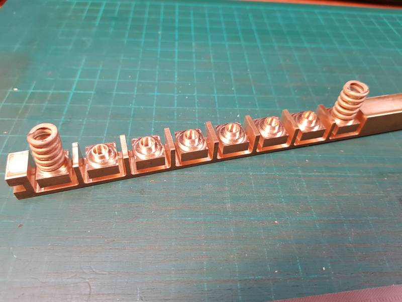

we continued with the springs for the axle swings.

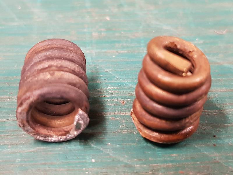

These are 2 out of 8 axle springs of a brass handmade V100 that I had once bought. You can tolerate some attention.
These feathers, like everyone else, can tolerate some affection.

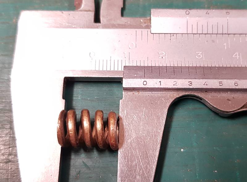

With a round pliers, the spring is machined to the extent that an M5 screw fits in.
Then the springs are pressed together with an M5 screw.
Now the right spring already has a cylinder shape.
Bogie08 (Helmut Schmidt)
After that, the ends could be plange-cut on both sides.
Bogie10 (Helmut Schmidt)
Control with the measuring slider and the 14mm height are achieved.

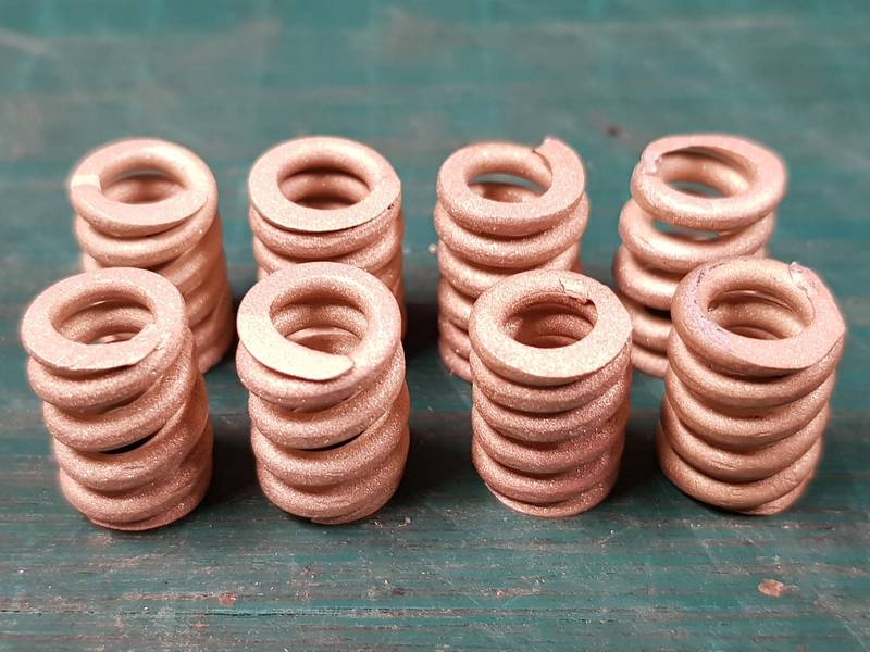

No comparison to before, isn't it?
8 pieces of finished working springs made of 2mm MS58 round material.

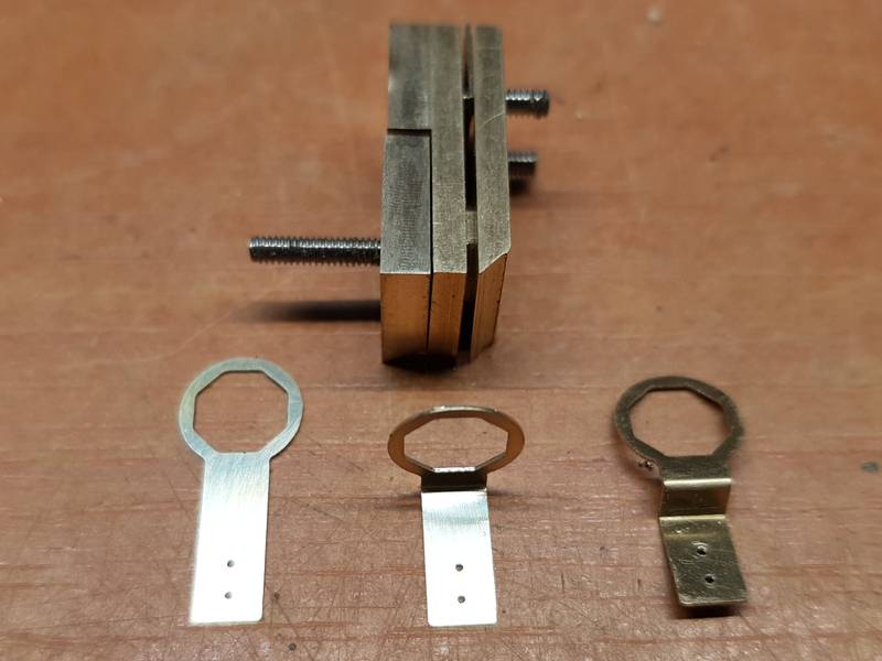

The bolts, of course, require the appropriate fuse. The locking plate fastened with M0.6 screws can be seen on the right bolt. The mounting holes can be seen on the left bolt.
I bent the fuse plates in 2 steps in the homemade bending gauge. The fuse plate itself is milled out of 0.3 mm MS 63, because it can be edged off very well.
In order to precisely bend the fuse plates in 2 steps, I designed and built this bending gauge.
Both bends can be made one after the other, in a voltage.

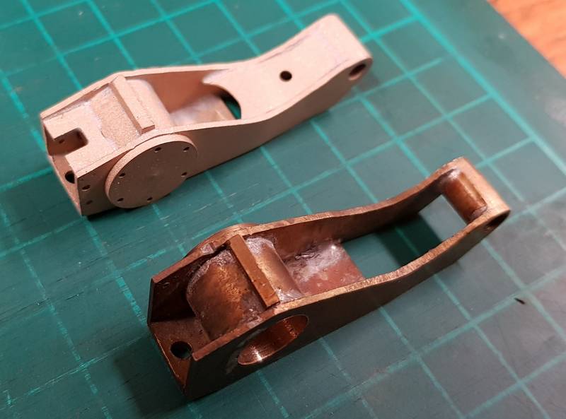

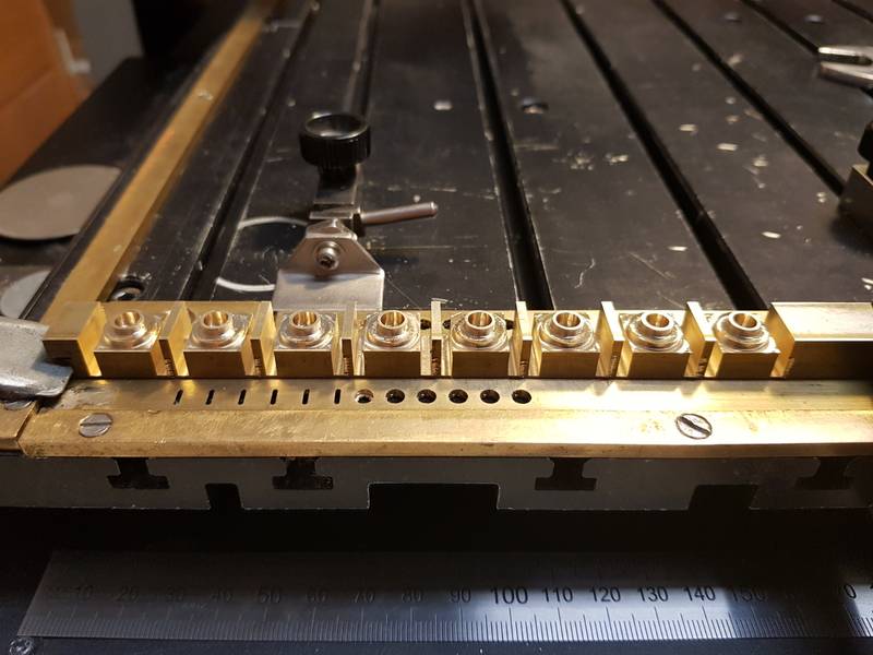

After I have reworked the springs for the axle suspension, I have noticed that the spring abutment also does not correspond to my ideas. So I tried my 2D CAD software and redrawn the part and sent the data to my milling machine. That came out of it.
The abutments were created from a 12 x 12 mm MS58.  Now they have to be separated out, which I just did on my circular saw.
Here on the left you can still see the old abutment on the left. The cone on which the spring actually sits is missing. On the right I used the new abutment with pins for the spring. When soldering the old abutment much unfortunately the end off, because it was insufficiently fixed. I realized that I also design this part best and create 8 new parts.

It continues with the refurbishment and improvement of the V 100 bogion frames.
Comparison of reworked and supplemented support arm to the original.
Support arm with lateral guide. The axle bearing cover is screwed with 8 pieces M0.6 X 3 model construction screws with SW 1mm.
Now the support arm has a lateral guide like the original.

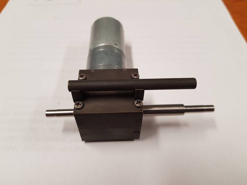

The axle gearboxes are fully assembled and the gearboxes are blackened.

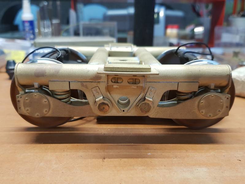

The bogs are making good progress.

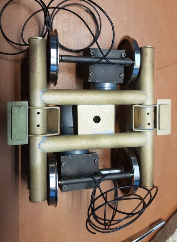

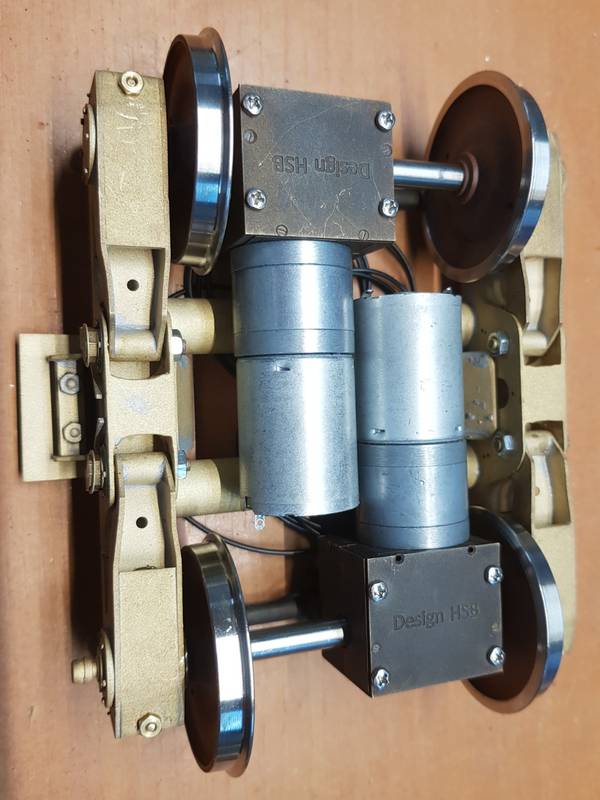

In the meantime, two drives could be installed in a bogie. This allows me to design and adapt everything else.
View from above are the Munz ball contacts, for the current consumption recognizable.
From below, the position of the drives can be clearly seen. Now only wiring is missing and another bracket for support on the engine then there can be the first test drive.

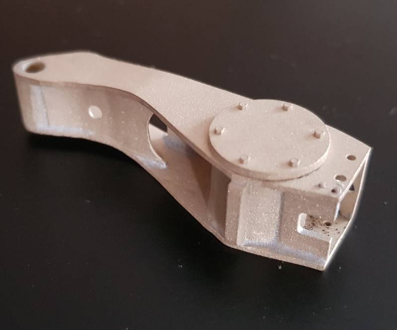

Haug, unfortunately I can't say who exactly made the pressure. I took part in an action in Germany where the components were ordered together. The printed parts came from China in excellent print quality. Unfortunately, with personally in the construction of the printed parts are too many deviations from the original. The model was originally designed for a 5 inch garden runway and was only scaled down. For example, the distance between the buffers is too small because the total bottom frame is about 6 mm too narrow. In addition, the longitudinal beams of the frame are completely missing. The bogs are actually only apertures and also very simplified. The drive gears are not encapsulated and therefore they are very much to be heard.
