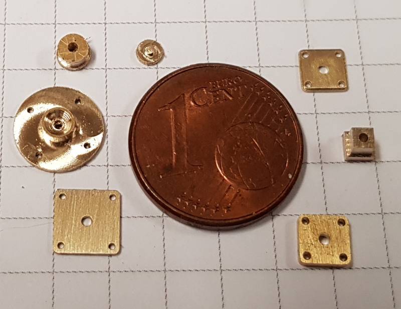

We continue with the construction of the speedometer generator.
The first parts for the speedometer generator are ready and are later attached to the 2 axis on the left side of the locomotive.
In the meantime, the missing parts have been completed and the speedometer has been created from them.
Wing arm swing with speedometer of the 2 axle front left, my V 100 BR 212 in scale 1:22.5. The speedometer is composed of 11 milling parts with 8 pieces M0,6 and 4 pieces M1 with a washer.
I'm building on a BR 212 and I've already reported on it.
An example would be the speedometer generator.

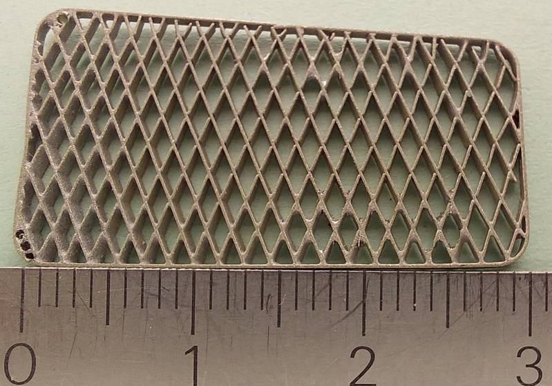

Film drawn on the computer for diamond grid steps. Format 200 x 300 mm.
The finished etching sheet made of 0.15 mm nickel silver sheet with a format of 200 X 300 mm.
The etched parts held in a frame for a diamond grid.
The stripes are turned down in the left grid frame and up in the right grid frame to be able to plug them together.
Thus, half of the strips are put together, since the 1.2 mm height of the strips, because of the small distance, had to be distributed over a total of 4 frames.
Prepared is the next frame, again with each 2 strips to fill the gaps.
After putting it together, the last frame is ready.
Now the grid is put together and the frames are fixed on the outside with solder, so that the part can be further processed.
Before separating from the frame, all nodes were soldered by the grid at the cross points. This was done with a lot of flux, a large soldering iron with a wide tip and very little solder.
View of the finished grid with a coin for size comparison.
