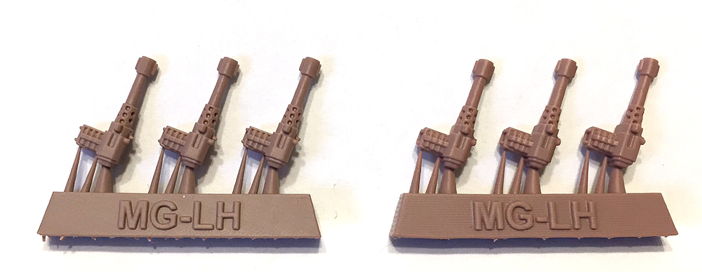

Posts: 1020
« Reply #104 on: April 23, 2015, 07:10:05 AM »
lousy photo of the water cannon. It would be better primered but gonna send these off to they guy I made them for 'as is'.
