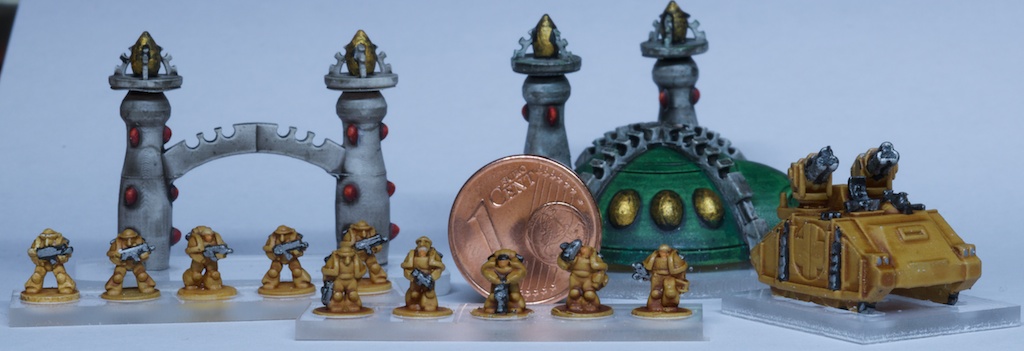

But there are some modellers.
This one is N scale:
1/300 scale
Bexley
