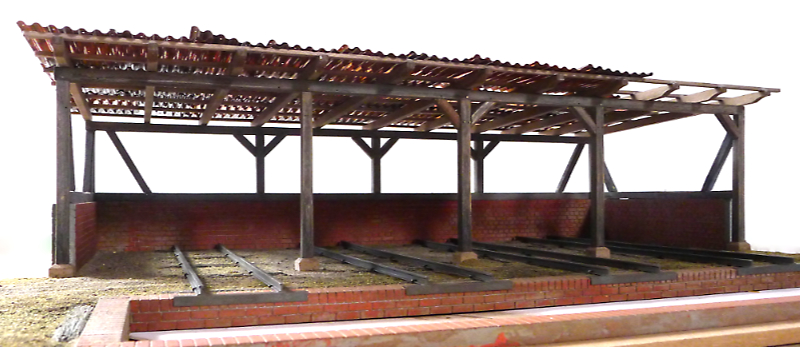

A little bit of progress has been made on my loco shed, so the previously loosely laid tracks in the shed were fastened with Old Pullman nails.
Dreh-Schiebebuehne_116 (fspg2)
To do this, holes had to be pre-drilled with a 0.8mm drill, otherwise the small wire pins would bend immediately. I used to have the same nails of a significantly harder quality!
Dreh-Schiebebuehne_117 (fspg2)
The angle profiles that are soldered on lie on the edge of the wall. They still have to be fitted with small hexagonal screws.
Dreh-Schiebebuehne_118 (fspg2)
Dreh-Schiebebuehne_119 (fspg2)
All tracks and their nails will later be significantly aged.‚
Dreh-Schiebebuehne_120 (fspg2)
The wooden beams have been pretreated with various stains and have so far gone through several stages of aging with pastel pencils and various stone powders ...
but more powder is scattered. I sprayed the intermediate steps with the landscape and construction glue every now and then.
Likewise, some diagonal struts have to be installed and further imitation wooden dowels glued in.‚
Dreh-Schiebebuehne_121 (fspg2)
Dreh-Schiebebuehne_122 (fspg2)
The corrugated sheets were placed here loosely - as an experiment - in order to get a small preliminary impression.
Dreh-Schiebebuehne_123 (fspg2)
