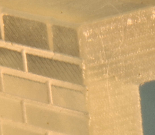

John. Nope. Nothing with the 'detail' of the rivets. I'm curious to see whether it will print well enough. The biggest problem with the lower-resolution (but affordable) printers seems to be the layer depth. I just took a photo of a column for my coke oven .. trying .. to get a good look at the detail. This was printed in FUD by Shapeways .. so you can get an idea. The mortar lines are .008" wide
Here's a close-up of that pic .. best I could do
JohnP
For brick and stone a little texture and a small roughness on the edge of a course should be OK. A smooth surface with hemispherical shapes will be different. And that depends on how magnified any viewing will be. Spray filling and abrasive smoothing are probably out as rework options on riveted surfaces.
