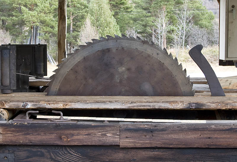

Blades for the saw. Chemical blackening, then polished with ground pencil graphite. Need a bit more shine as the model will represent an operating mill. But research has shown that this type of sawmills have pretty dark blades, even if they are still in operation. Suggestions for getting a bit lighter and shinier finish, anyone?

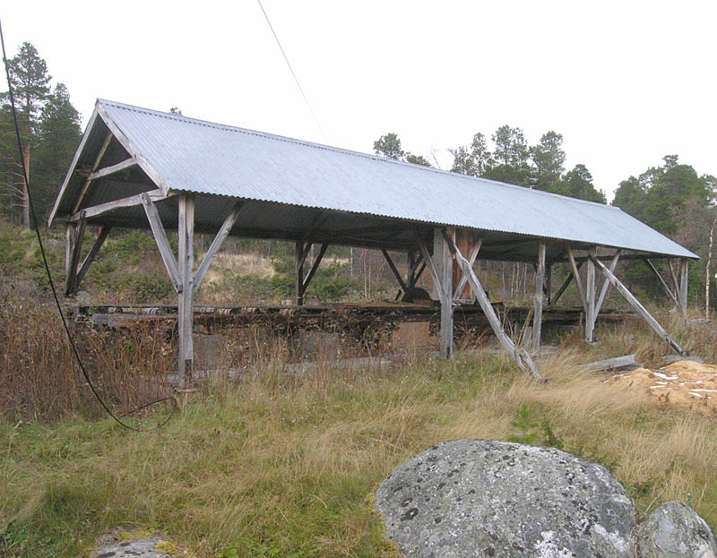

A couple of prototype shots:
I am taking some liberties with the prototype, I want a rusty roof instead the wooden roofing, and I will probably use an stationary steam engine to power the saw. My model is going to be set in the thirties, so the prototype´s electric motor is not very appropriate.

Don´t postphone taking all the pictures and measurements you need! I came back for some more pictures and measurments, an this is what I found:
This picture is taken from almost the exact same spot as the exterior shot above.
Grab that camera and yardstick *now*!

Your comment about dark blade metal in a running mill is a little perplexing.
any Circle blades I have seen running polish up in a hurry when sawing logs.
Perhaps a different metal alloy?
Attached is a couple shots of a double circle mill ( all steam power by the way)
The one picture shows the lower blade being run and the upper blade static and covered with sap and saw dust thrown up by the running blade.
The other picture shows the upper blade being put into operation (log size) and starting to polish up.
Even though the saw teeth are wider than the blade the sawdust spilling from the tooth gullets into the cut acts as a polishing agent and soon buffs off the rust and tarnish.

I might have underestimated the length of inactivity between cutting sessions. What I have been researching is what we in Norway call "Farm Sawmills" as opposed to commercial sawmills. These small saws can probably sit idle for months between cutting any wood, and I guess that is plenty of time for the blades to go dull. Many of these saws were crude affairs with little protection from the elements.
You cant get more basic than this one placed in a mountain reigion here in Norway:
But back to your first comment, I do think my blades needs quite some more shine.
Regards, Håvard H

I am with Chuck, spin the blades to polish some "lines" in it.
Yes, I am definitively going to try that.
Here is a closeup of one of the blades in the "open" sawmill I showed above:
Not as dull as my first efforts, but neither a shiny chrome finish!
Suprisingly many shades of color  in that blade by the way.
