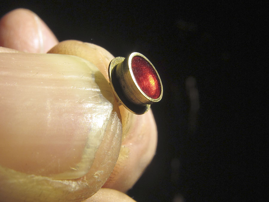

A little progress this night. I have for a long time wondered how to fit lenses/glazing into the headlamp and markerlight. I decided to try acrylic rod. For the marker light I used a red acrylic rod.  Turned it down to a few thou above the headligh opening. Pressed the rod into the hole, parted off as close to the brass part as I dared. Polished with wet and dry 3600 to 12000. I think it worked out pretty good:

Thanks!
If you have access to a lathe, the process goes surprisingly fast.
The most time-consuming part is polishing the cut surfaces up to a glass shine. And you can not just spin the lathe and put the wet&dry against the rod. You will get a center that is poorly finished.
I used the following grades of W&D: 1200, 3600, 4000, 6000, 8000 and 12000. Finished off with a buffing block.
By the way, the pictures gives the wrong imression. The "glass" is absolutely flush with the brass.

Nice job, Havaard. -- Russ
Thanks Russ.
Small step for mankind, and not really a big one for me either! But I give myself a little backslap for giving up the idea of casting clear resin directly into the brass turnings and instead finding a much simpler solution.
Very nice indeed, regarding polishing acrylic I made a series of lenses for a science centre exhibit that was dealing with refraction and I used brasso on some card as a polishing compound worked like a charm.

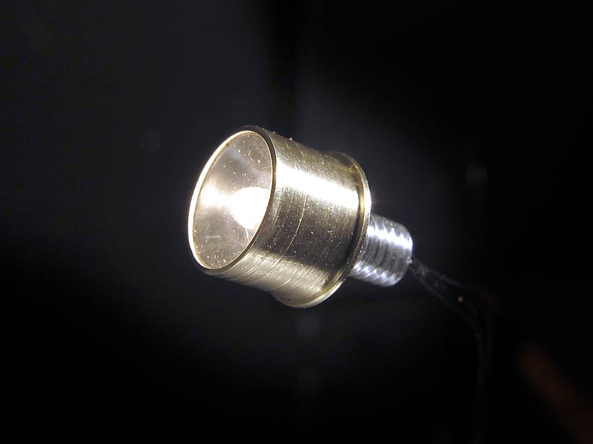

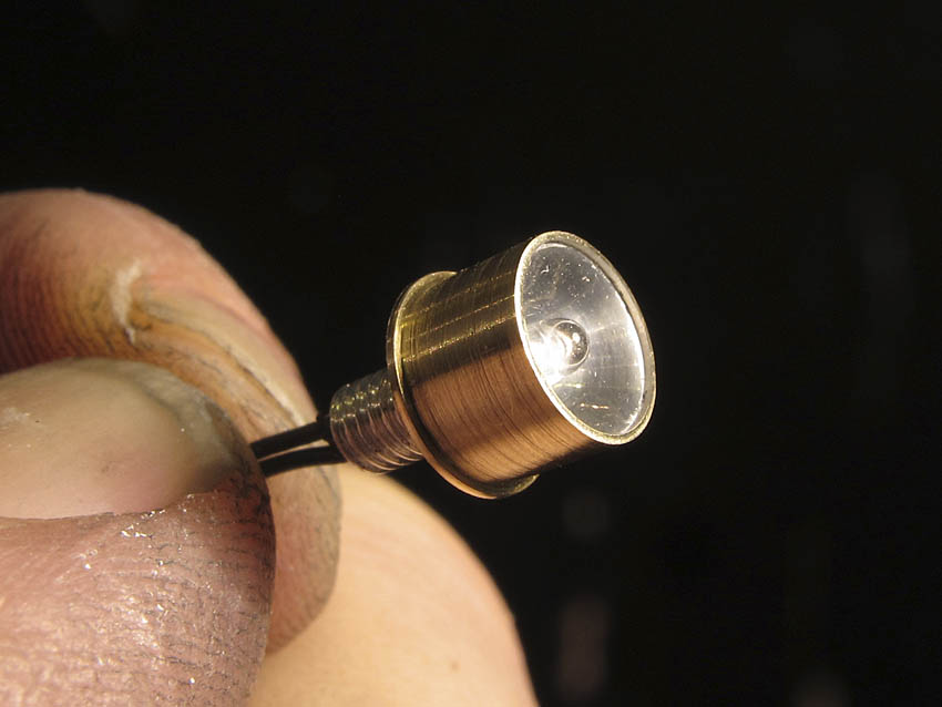

Finally I tackled the main headlights .

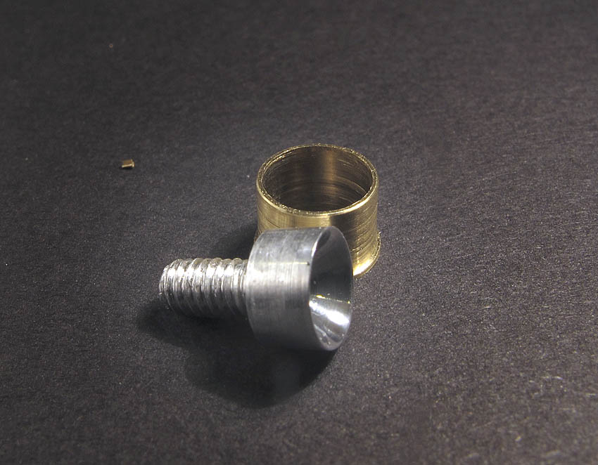

After trying to paint the reflectors with alclad metallic paint, I decided to turn aluminum inserts instead. Made a form tool with a convex shape to make the reflector concave. Polished them the same way as I polished the acrylics.
The surface of the brass is a bit rough, I should have used a fresh cutting bit in the turning tool. But the enlargement is merciless, placed on the engine it will probably look just fine.

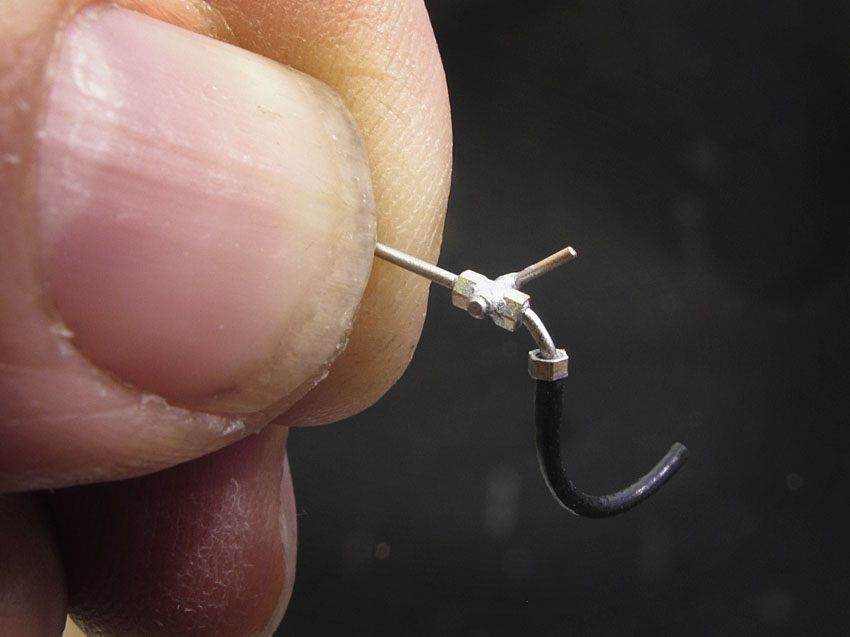

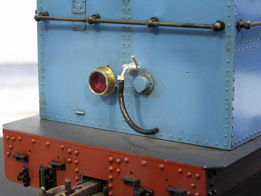

A little progress:
This is my first attempt at a Westinghouse airhose with valve. The connectors are still to be made, but that will have to wait untill tomorrow. The hardware will also be blackened and weathered before final installation.
