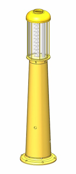

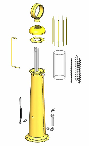

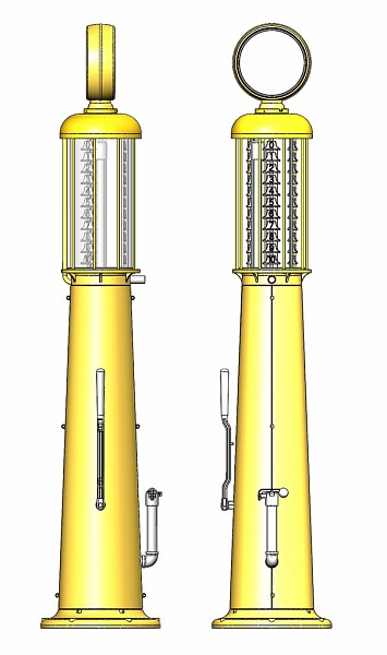

I finished the pump design up to the hose and nozzle:
Re. the drawing: Wowsers.
Re. an article: DEFINITELY!!!!! This is something I really want to pursue in print. Money is no object; I'll have my cats print up some new hundred dollar bills for you at once.
Ideally I would try to incorporate the experience and information from you, Havard, and Marc in one very comprehensive article. If everyone is up for that, we could run it in the December 2011 book. I would place no limit on its length; whatever it takes to tell the story. At the very least I want a full report on your experience with PAP and any other service bureaus you try. By that time the entire diorama may be complete and we could do a separate article on it in the same book.
On a related topic, maybe I could do a sidebar article with Dave Krakow on how he's pushed the envelope with lasers, concentrating on his brickwork and those amazing wrenches and gears.

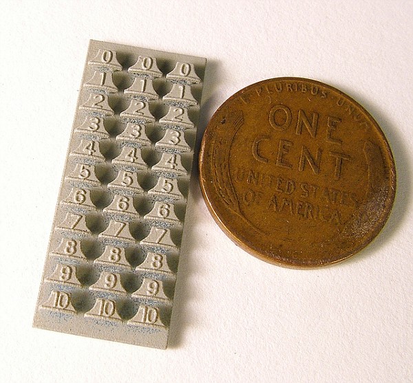

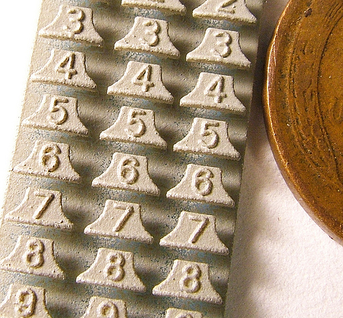

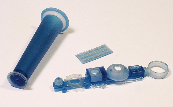

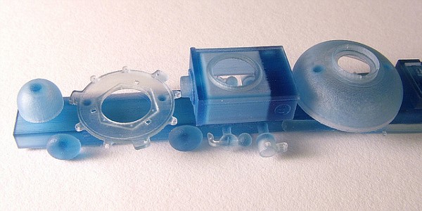

I received my gas pump "kit" yesterday (the square-ish parts are an electric meter). The pump body is just under 3" long and is hollow to use less resin.
I gave the gallon indicators a quick spritz of primer; I should have cleaned them first so there's a touch of wax residue still on them. Wayne pumps had 3 sets of cast aluminum indicators so there are 30 tiny bits to keep track of.  They are .010 thick, .07 high by .125 wide. The numbers are .006 thick. It looks like maybe a good cleaning and a coat of Mr. Surfacer (gotta get some) should take care of these without further sanding. These sit on tiny sprues and are very fragile...high marks to PAP for cleaning these without dislodging them.
Looks promising!
That is impressive and a fine advert for your drawing skill as well.
Look forward to seeing this one develop through construction and paint .... was thinking of doing a UK pump of the 1950's but think I may be getting out of my league, or two !
#494

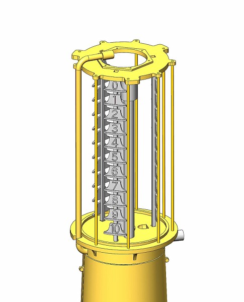

Your drawings look great and glad to see the resolution on the tiny parts came out so well.
Stupid question:  the gallon markers are numbered 0-10 from top to bottom ... I know that's correct (after looking at proto pix to try to sort this out) ... but never seen one of these old pumps working and it seems counter-intuitive.  If you put a gallon of gas in a 10-gallon cylinder, there should be a gallon of gas at the BOTTOM of the cylinder.  Did they use some sort of floats for the counters or ... howzat work?  ???
On further thought, maybe that's the gravity-feed aspect ... if they had to FILL it with 10 gallons and then mark off how much is drained from the cylinder, then the top-down numbering makes sense.  Still, since at least a couple of you guys actually KNOW things about these pumps, I'd be curious about an actual explanation to replace the guessing to understand the fine modeling going on here!  ;)
