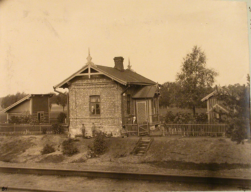

For a prototype the lineman house Saint Petersburg–Warsaw Railway was chosen:
Общий вид типовой каменной одиночной будки [у станции] by Dmitriy Kudryashov, on Flickr
Общий вид типовой каменной одиночной будки у станции by Dmitriy Kudryashov, on Flickr

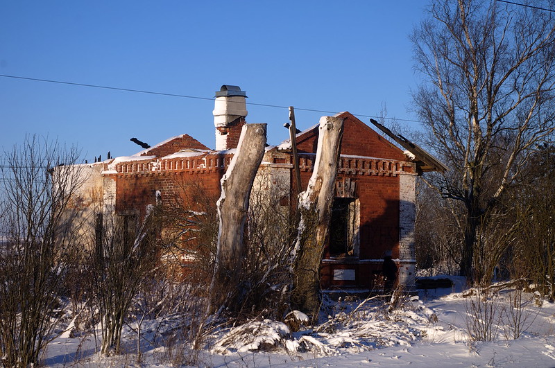

At least, one of such lodges remained, the truth represents very "a pathetic show":
IMGP7784 by Dmitriy Kudryashov, on Flickr

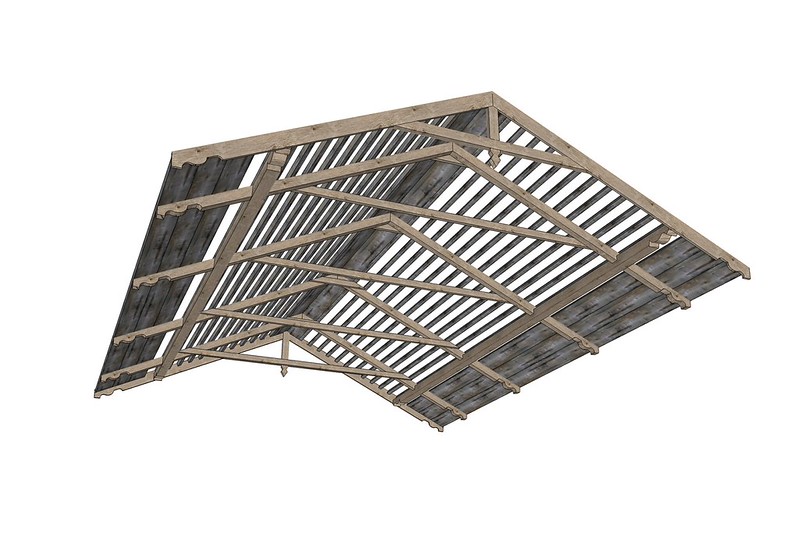

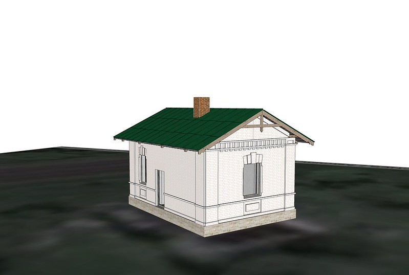

In view of lack of drawings at me by this railroad, it was begun with natural measurements and "drawing" of a 3D model by means of the SketchUp program is more narrow on them:
Сторожевой дом №32, с севера, 2016.02.13 by Dmitriy Kudryashov, on Flickr
Almost current version of a 3D model can be "twisted" here.
It is possible to look at history of "drawing" in a photo album on flickr.

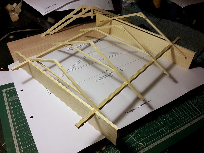

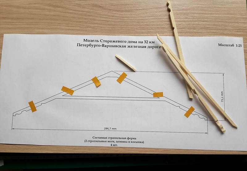

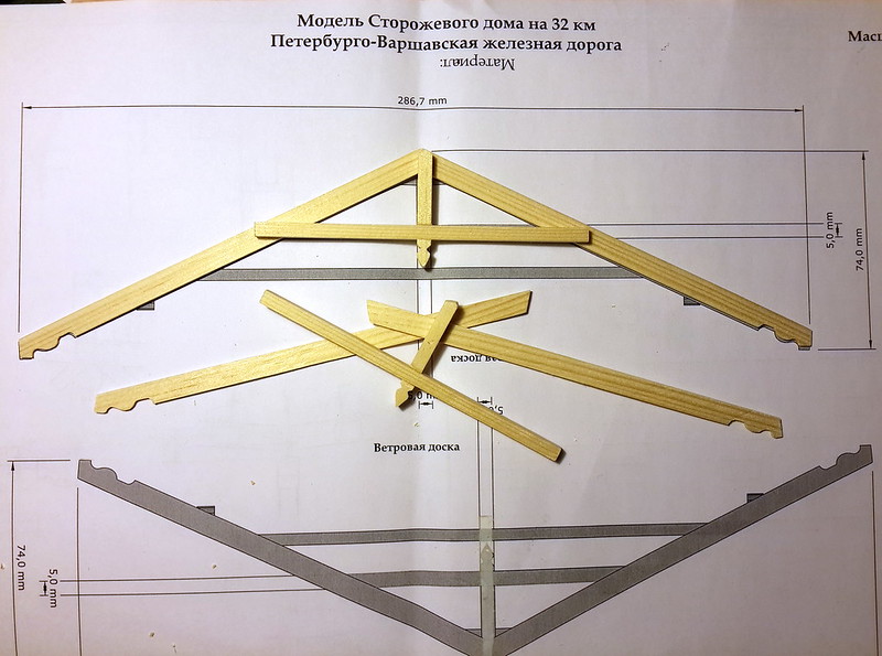

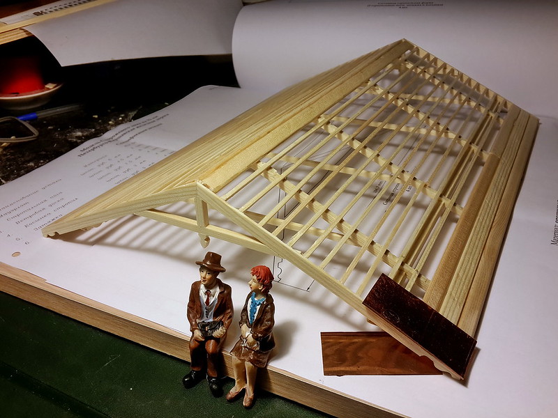

Manufacture of rafter farms (all them there will be 4 pieces).
The bilateral adhesive tape serves for fixing of preparations at assembly (gluing together) of rafter farms.

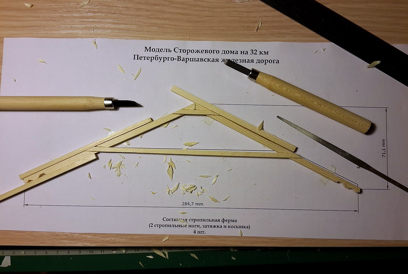

The drawing in scale 1:25 is printed out from a 3D model:
20160206_134309_ by Dmitriy Kudryashov, on Flickr
20160206_180248_ by Dmitriy Kudryashov, on Flickr

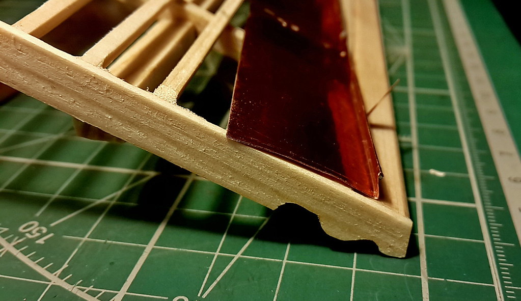

Trimming of unit of a wind board (all them there will be 2 pieces):
20160209_220726_ by Dmitriy Kudryashov, on Flickr

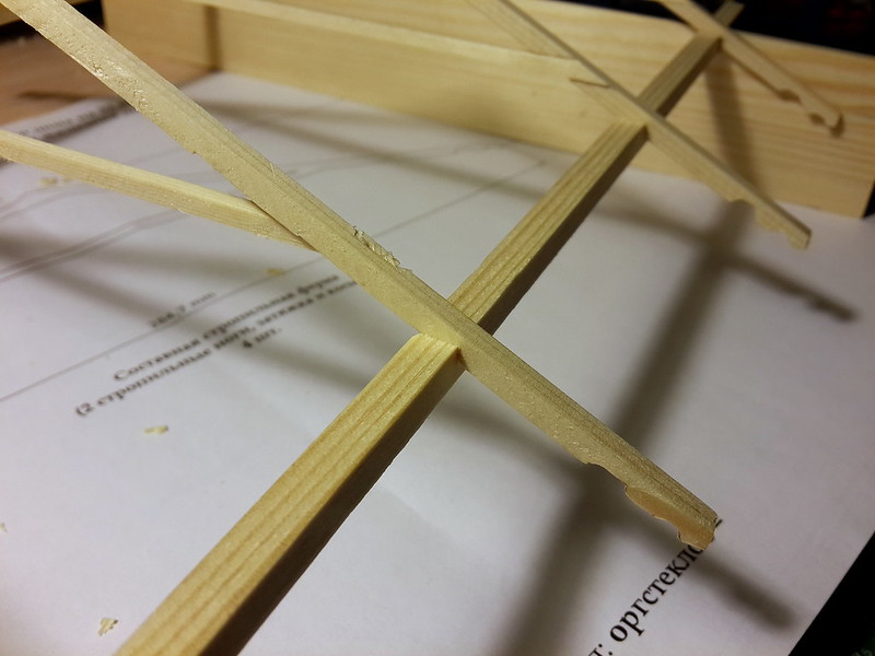

Insert and "fitting" of rafter farms on rafter plate (so far "dry"):
20160211_234435_ by Dmitriy Kudryashov, on Flickr
20160211_234449_ by Dmitriy Kudryashov, on Flickr

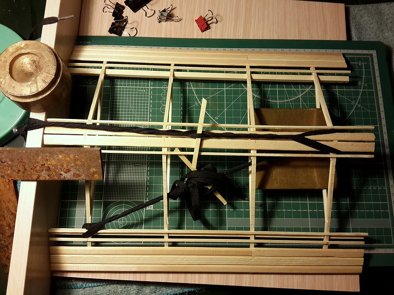

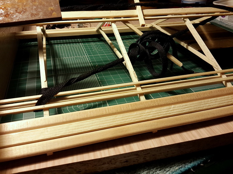

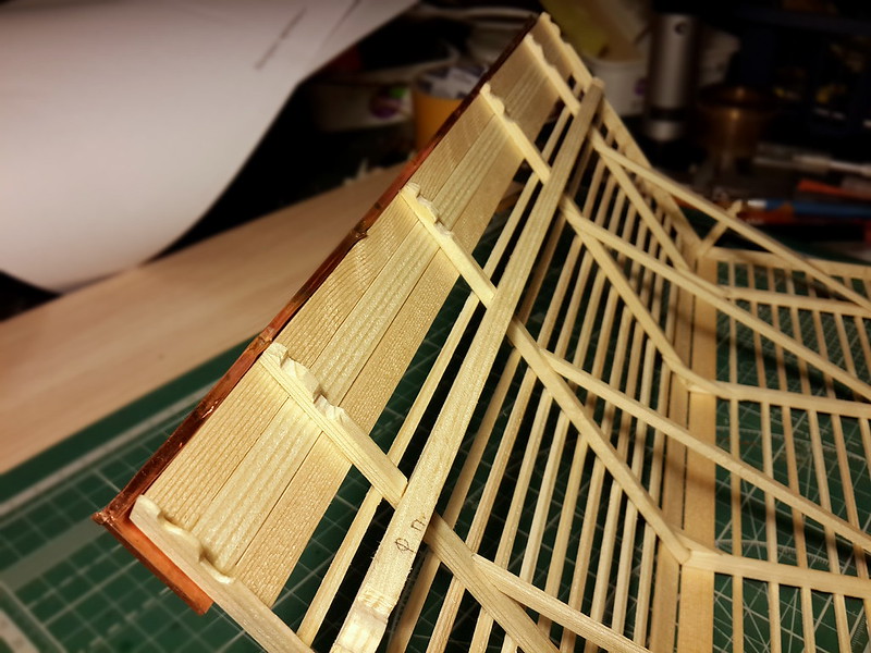

Assembly of a roof - filing of eaves, the device of an lathing of roof under an iron roof continues:
20160213_221659_ by Dmitriy Kudryashov, on Flickr
20160213_221722_ by Dmitriy Kudryashov, on Flickr

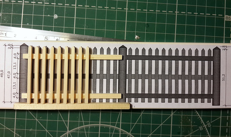

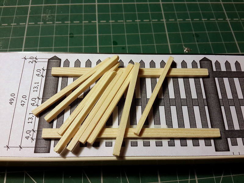

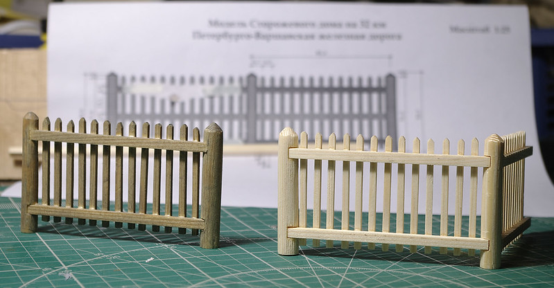

Construction of "estate" as it often occurs in Russia, is begun with a fence, more precisely - in terms of a century before last - with palisade :
20160121_231025_ by Dmitriy Kudryashov, on Flickr
20160121_232435_ by Dmitriy Kudryashov, on Flickr
As the model will be established outdoors, is planned to make impregnation of elements means of Pinotex Wood&Terrace Oil c use of the "homebrew" vacuum pump.
Result of impregnation.
Colourless Pinotex Wood&Terrace Oil is tinted at color No. 606 (gray-green):

Beautiful work with the trusses and picket fence.  I got a good laugh out of the use of a shoelace as a clamp in the photo of the roof assembly, very cleaver.

...  I got a good laugh out of the use of a shoelace as a clamp in the photo of the roof assembly ...
;) It was the closest string which appeared "near at hand".

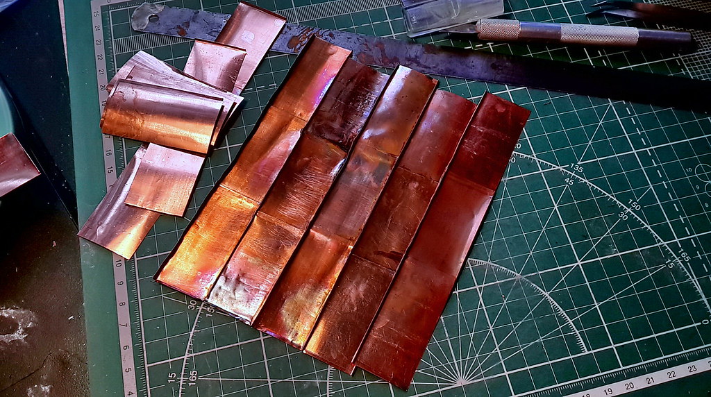

Roofing works are begun.

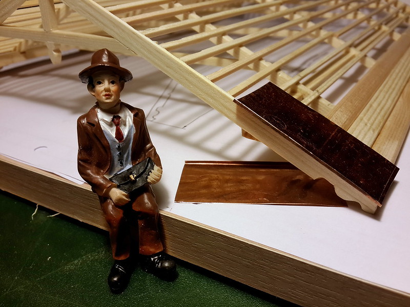

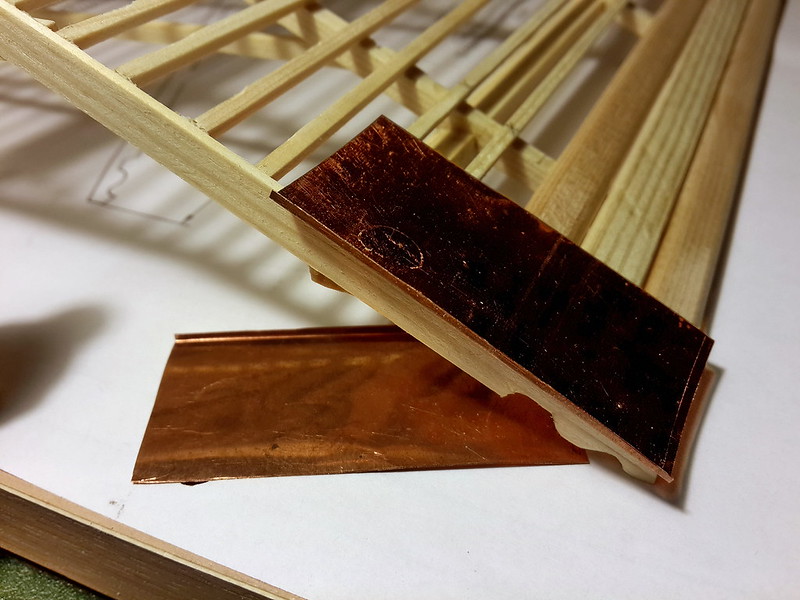

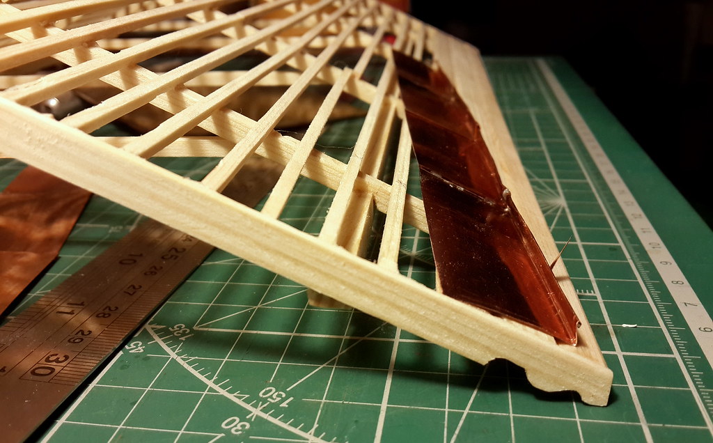

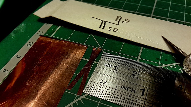

Cutting of sheets on a roof - a copper foil 0.1 mm thick
CM160217-19433802_ by Dmitriy Kudryashov, on Flickr

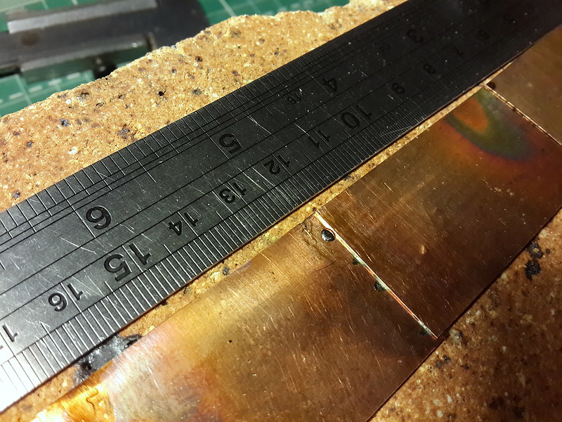

Assembly of eaves "picture" (sheet).
As well as the presents, sheets connect in "pictures" a lying fold. In view of a mesh size of a fold, "picture" follow-up are slightly soldered (on a photo - the joint is missed the mark with rosin and solder pieces are spread out):
20160217_205518_ by Dmitriy Kudryashov, on Flickr
After warming up the torch - visible that one drop of solder did not flow into a clink...
20160217_205623_ by Dmitriy Kudryashov, on Flickr

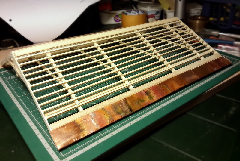

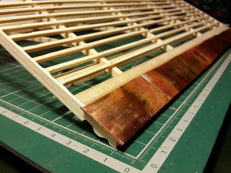

Fitting of eaves "picture" (sheets) on a roof:
20160218_001906_ by Dmitriy Kudryashov, on Flickr
20160218_001932_ by Dmitriy Kudryashov, on Flickr
20160218_002143_ by Dmitriy Kudryashov, on Flickr

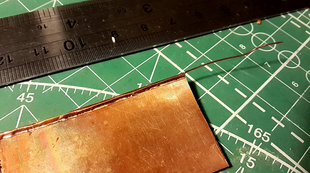

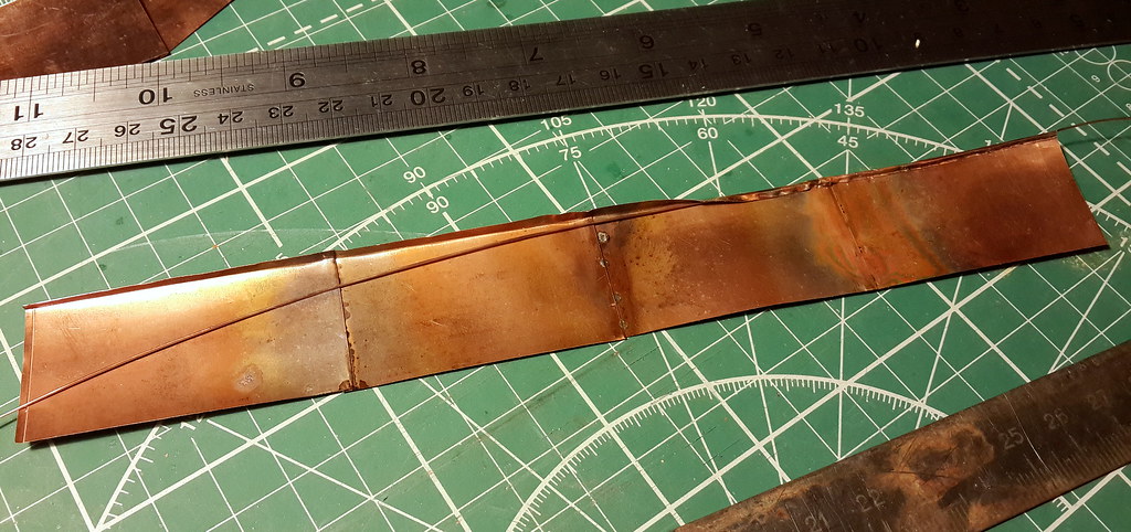

water waste trench.
For rigidity, we roll up a wire (0.5 mm) in an edge:
20160219_192322_ by Dmitriy Kudryashov, on Flickr
The created trench edge:
CM160219-19273203_ by Dmitriy Kudryashov, on Flickr

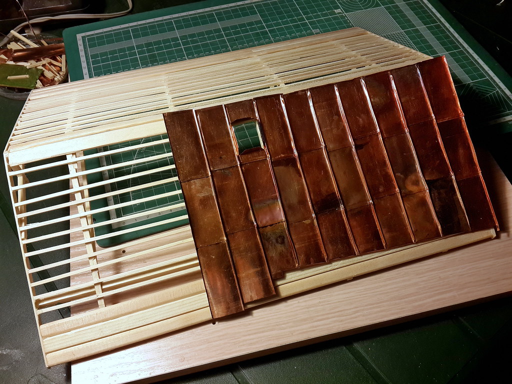

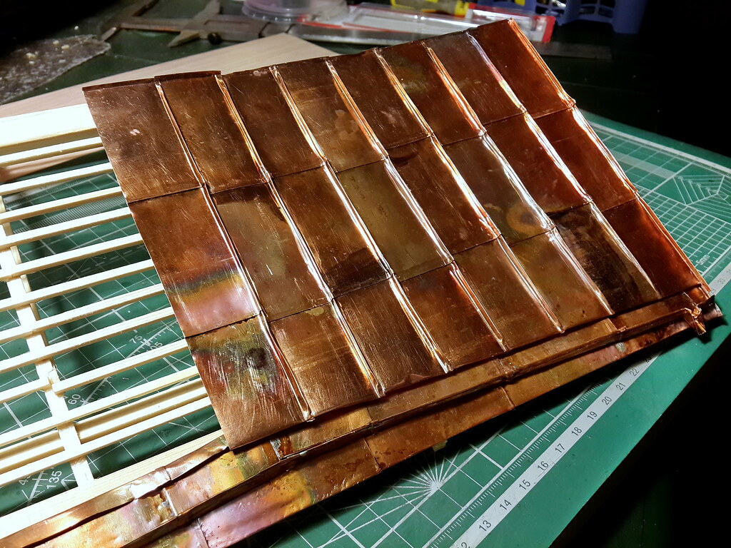

Ordinary covering of a roof.
Assembly of ordinary sheets of a roofing covering continues:
CM160227-17104802_ by Dmitriy Kudryashov, on Flickr

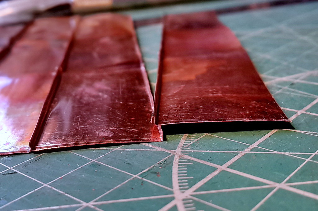

Single sheets of a roofing covering gather among themselves as well as at the original - by means of a standing fold:
CM160227-17153003_ by Dmitriy Kudryashov, on Flickr

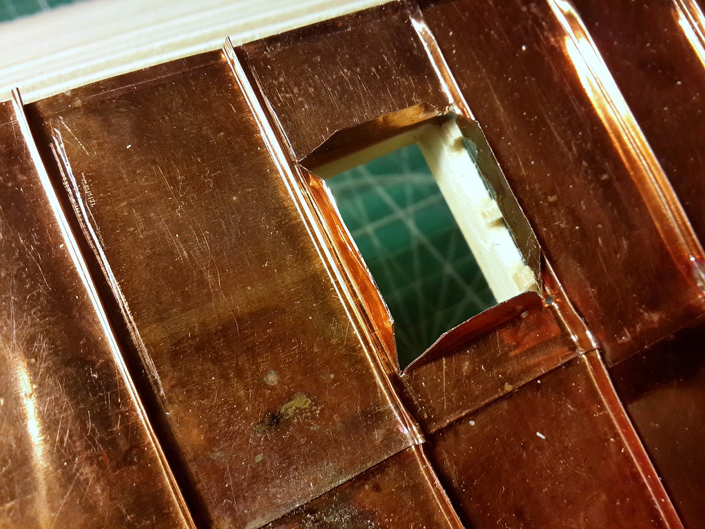

The roof frame and the roof is cut hole for the chimney:
20160228_195820_ by Dmitriy Kudryashov, on Flickr
20160228_195852_ by Dmitriy Kudryashov, on Flickr
