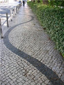

I too have been interested in replicating this type of pavement , although mine will based on some Lisbon pavements. I notice that the Lisbon pavements use much more regular sized & shaped stone and for this reason I have used Fimo clay extruded through some shaped dies  ......... Will post some pics later
This is a typical Lisbon pavement

Gordon, that walk in Lisbon also looks like it will be an interesting project too.

Gordon the Lisbon project looks fascinating. I am interested to see where it goes. Please post some pics.
