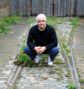

Looking at the cobbles under the bridge picture there are quite a few that seem to have rounded ends so I am thinking that a number of different cookie cutter type cutters that are dull to slice them off. The dull edge causes the top to pull down a little.
