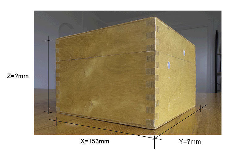

Those of you that have read my ramblings about buses will know that I am facing the challenge of making a set of scale drawings based on photos with a large degree of perspective. When you want to model pretty obscure stuff, this is a challenge that raises its confusing head quite often.
But I have never been able to figure out the exact procedure for removing the perspective from the photos.
In theory, it should be possible to make a scale drawing by constructing a  two-point perspective drawing "in reverse".
So I tried a little experiment. I wanted to see if I could calculate the correct height (Z) and width (Y) of this wooden box using only the picture and the length (X). I have made it a bit simpler for myself by taking the picture straight on without tilting the camera, so Z is unsharpened. So the challenge is to remove the shortening on X and Y:

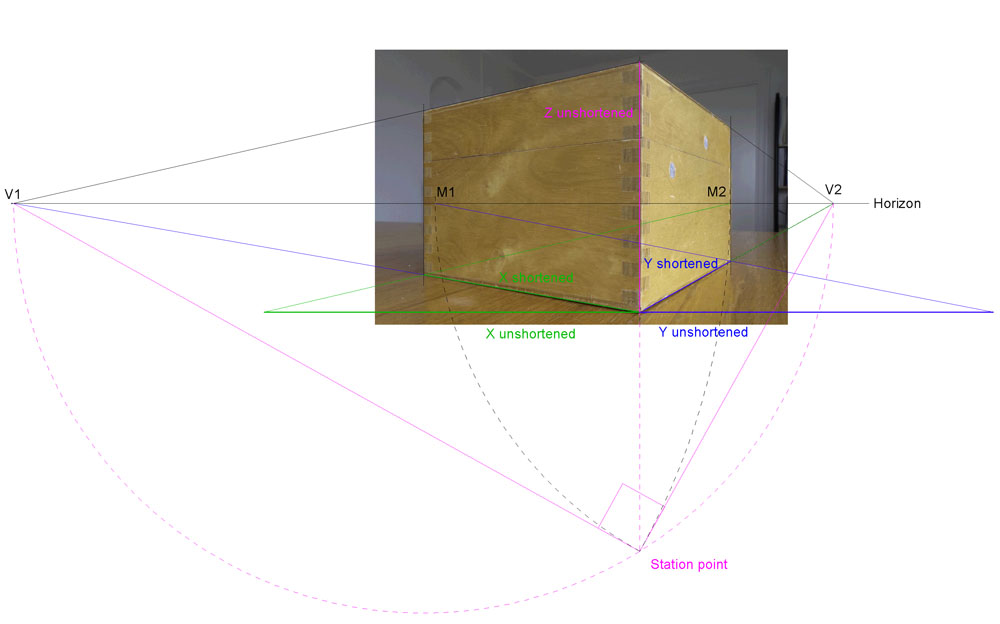

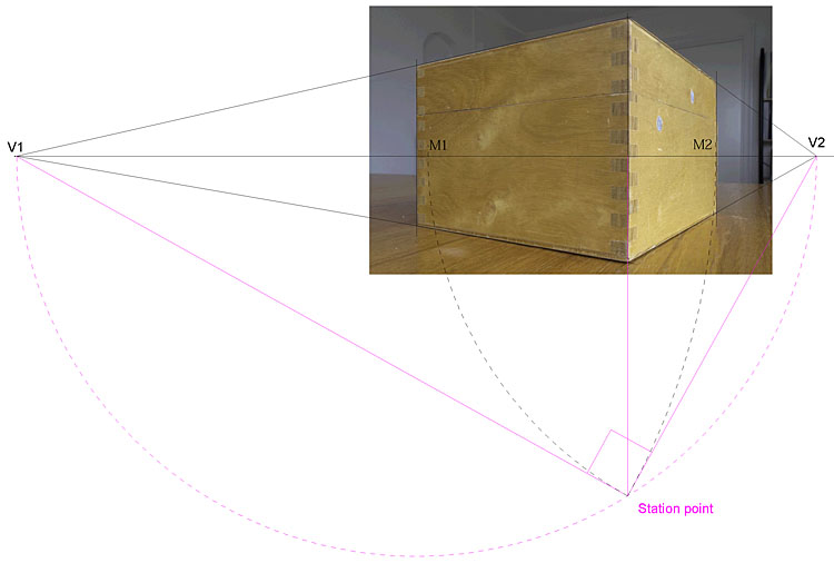

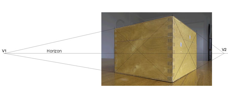

Using standard 2-point perspective drawing theory I established the horizon and two vanishing points:
Then I constructed the View distance, station point and measuring points:
Next step was making a measurement bar and finding the unshortened length of the X and Y sides:
Now it should be just a matter of scaling everything so that the width becomes correct based on the known X dimension of 153mm. This should in theory give the correct Y and Z dimensions.  And measuring the height on the drawing gives indeed the correct height within a reasonable margin. But the Y came out  too short, only around 80% of what it should be. I did the same experiment with a diffent box and  got the almost exactly  the same error. So I am doing something wrong. Does anybody have a suggestion for where I went wrong?

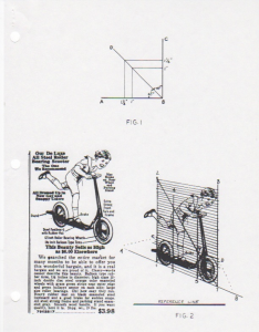

This is a method I taught in a model building class.

Instructions
To add second plane add base line E-F crossing A-B at7 out at an angle to the right to match the base of the object such as a box. Extend reference line to the right to establish all verticals up from the baseline as was done in the first plane.

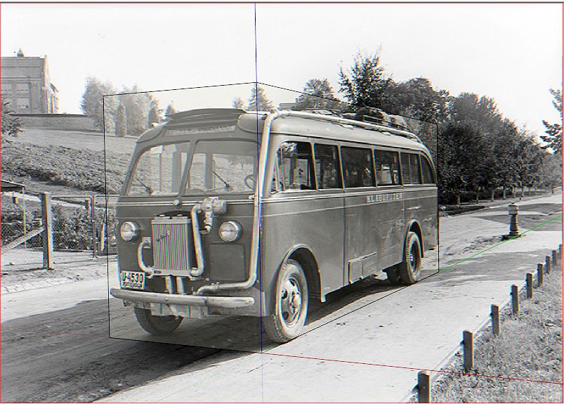

I brought one of the buses into Sketchup via Match Photo and made an attempt to align the perspective bars to it. Then made a 'box' around the bus so I could project the photo on to it.

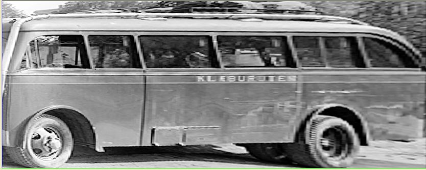

I projected the image onto the box and switched to Parallel Projection and viewed from right.

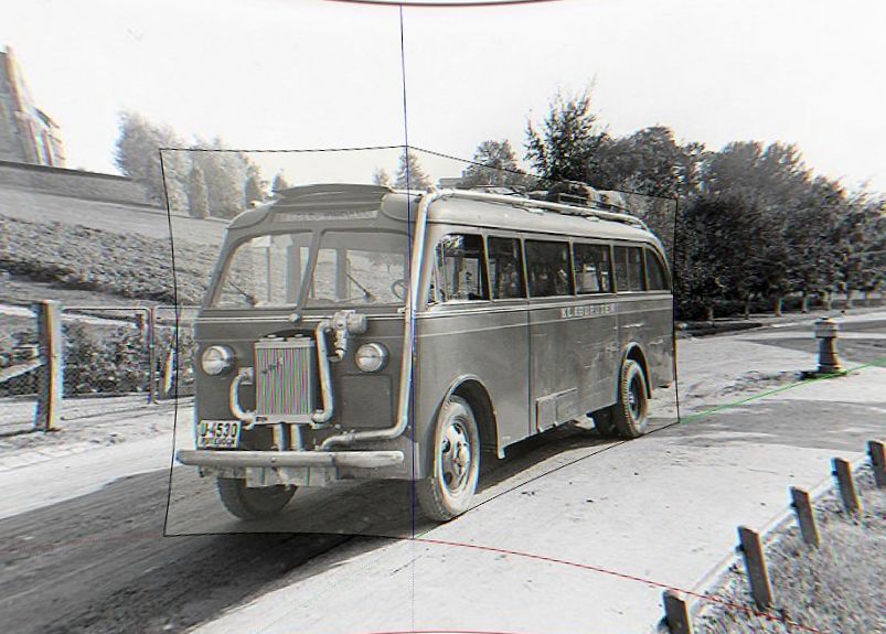

this was done 'on the quick' .. spending a little more time and you might get a better view. In Paint Shop Pro you can adjust/correct distortions by the camera lens .. Barrel, Fisheye and Pincushion. Someone who knows a little about the way a camera lens distorts photo can use that prior to using the Sketchup Match Photo and get better results. Here I applied a Fisheye Correction on the first photo with the box around it as it shows the correction made.
