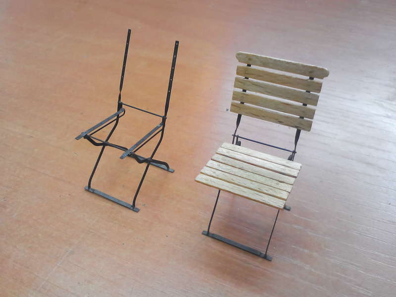

Hello everybody,
I myself have so what tinkering regards a Time Out inserted, because we have got a puppy and it is valid only once to provide intensive support and educate.
Without it did not work but I just needed time as a finger exercise for testing whether you still can.
Since much of me then I've still lying by Thomas Hey'l Germany the components for the garden chair.
There was just left lying times because missing holes in the etched parts.
The missing 0.3 mm holes I then drilled with a small drill by hand, was actually quite simple.
But see for yourself, as far as I am now:
Now for some details:
The chair frame left weighs 0.5 gr. And the finished chair right 0.9 gr. Or the total 0,0019841604lb
The nickel silver etched parts are made of 0.2 mm sheet and the visible wires of 0.4 mm spring-bronze wire.
The 0.7 x 2.5 mm wooden slats I even cut out a piece of beech wood.
On the chair they are aligned with 0.3mm brass wire sections and glued.

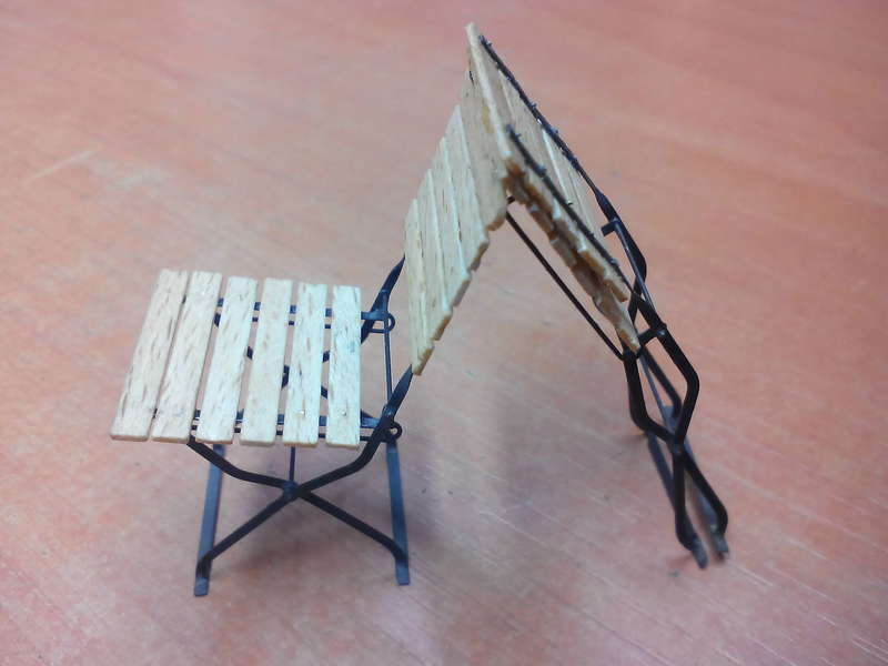

Of course, the chair can be folded together.
The whole thing is just an exercise chair to test techniques for a possible series for a model beer garden at my "Klosterstollen".
Carlo

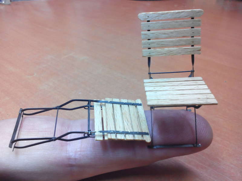

Chairs for size comparison on my finger.
