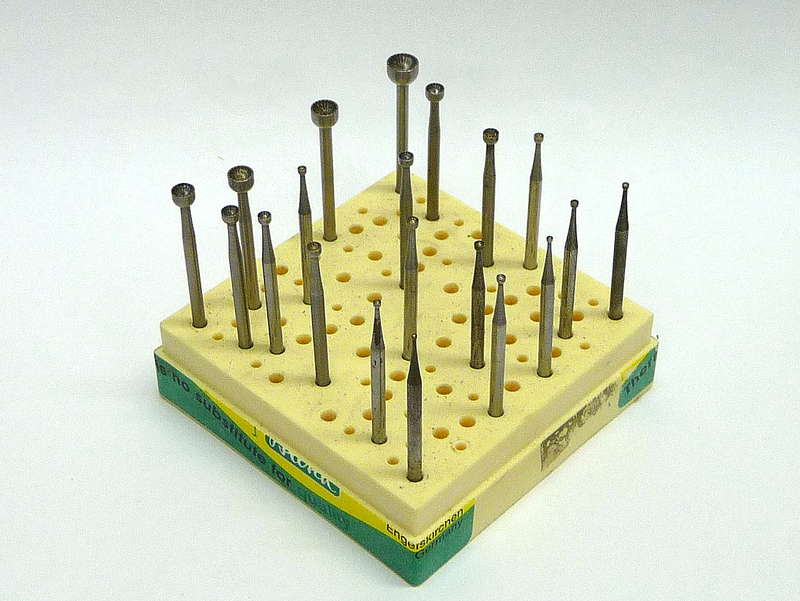

Hi Bill,
I own and use such a router, but use them in the mini drill.
"Hohlfräsersatz"  or in English, cutter for forming hemispherical ends.
The rivet heads shown here have been created.

Hi Helmut, I did a search for "hemispherical end cutter" with a few different variations in wording but kept getting a tool that cuts a hemispherically shaped hole instead of a rounded hemispherical end on a rod or wire, but I will keep looking, thanks.

Try searching for "cup burr."
From Rio Grande, one of my favorite websites to drool over peruse.
Thanks! That finds them. Will they work on styrene rod?

Hi Bill,
yes if you slowly, turn without much pressure.
The plastic must not melt.
I have a set - great tool!
use by hand on styrene.
works on brass and steel too (with a lubricant)
