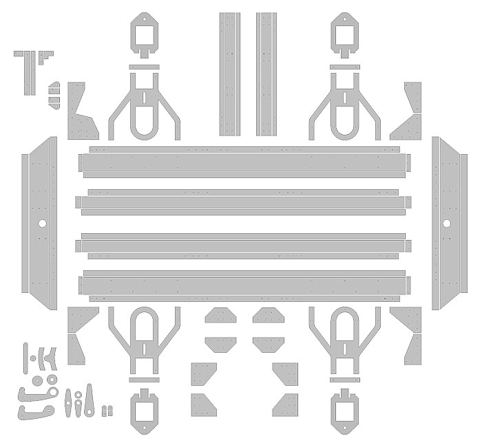

Some progress on the cars. The big hurdle to overcome is the etching artwork for all the metal parts. These are to be etched in nickle-silver. Not the most interesting image posted on this forum, but the screendump might give an idea on how I plan to lay out the parts:
By the way, the actual artwork will consists of two drawings, one for the front and one for the back. On the films they will be all black, the grey fill with black countours is just my "working colors".
Hauk,
are you going to rearrange the items to save space / material?
