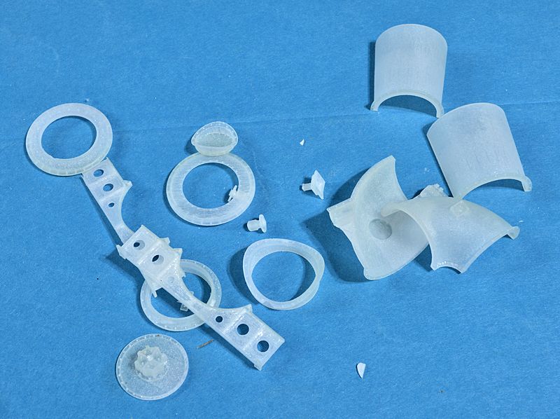

The printed bits and pieces .. literally. I was trying to get too 'cute' and made some of the walls just too thin. Hey .. it's a learning thing. I also made the holes for the rivets .015 in .. and the 'studs' on the Tichey rivets/bolts are .020 in. Ooops! I also forgot to add alignment tabs/pins .. the parts in the upper right were warped slightly and had to use masking tape to align. Still .. ok .. like I said .. learning.
