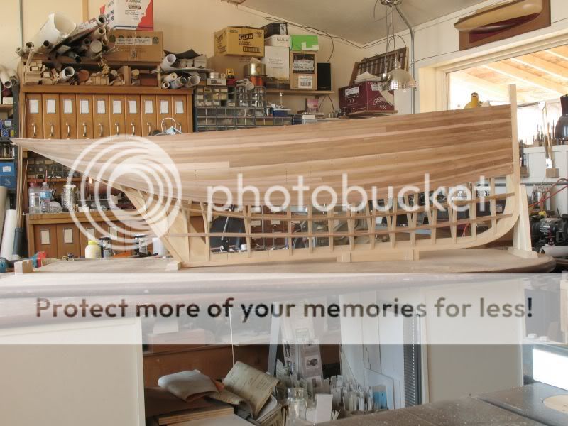

Definitely graceful ... but for some reason, the photos are making me crave spare ribs!  ;)  -- Dallas
Ribs?
I was thinking standing rack of lamb?
Anyway beautiful just as it sits!
I think once you finish just the ribs set up a proper background for a beauty shot!

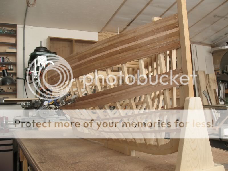

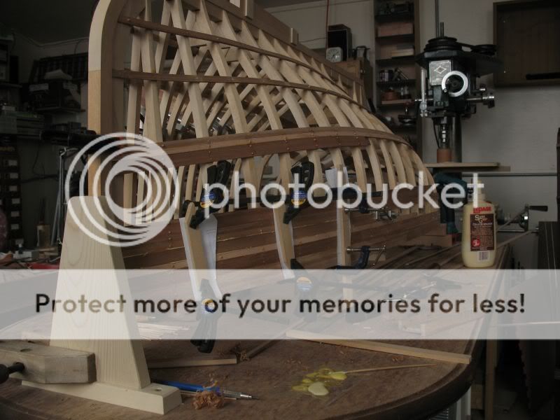

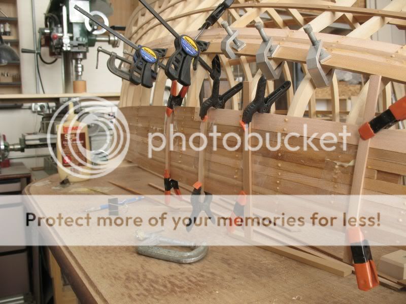

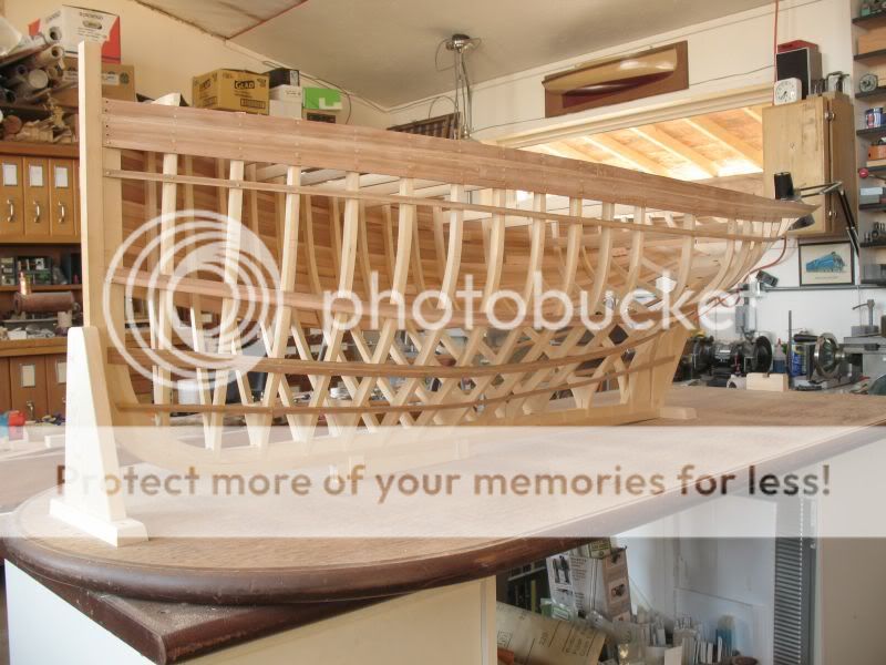

here are a couple of shot of the work to date it is an interesting journey to say the least.
I hve changed the building board and have reworked a number of the frames to get a smooth shape to the hull. the planks are being pegged as I go along. they are certainly taking a while because I have to wait for the glue to set before moving on to the next plank. This will end sometime, then I can fair the planks and proceed with the second layer which will be at least half the thickness of the first layer, and more traditional in appearance. then a few coats of sealer to help to get the hull waterproof.

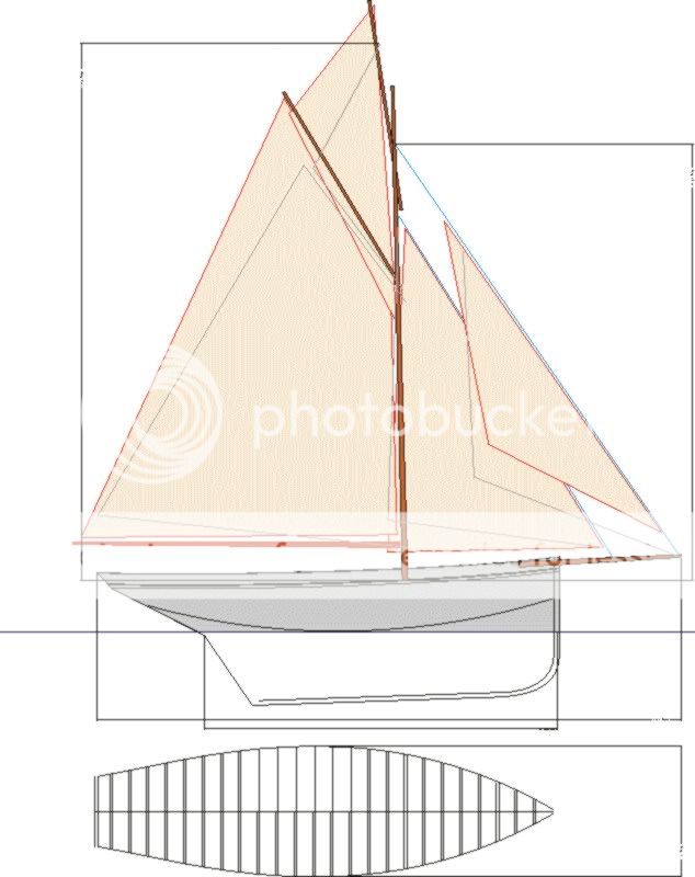

this is how I hope to have the finished boat look.

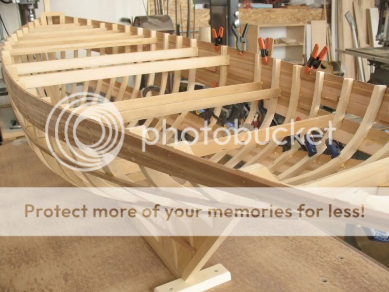

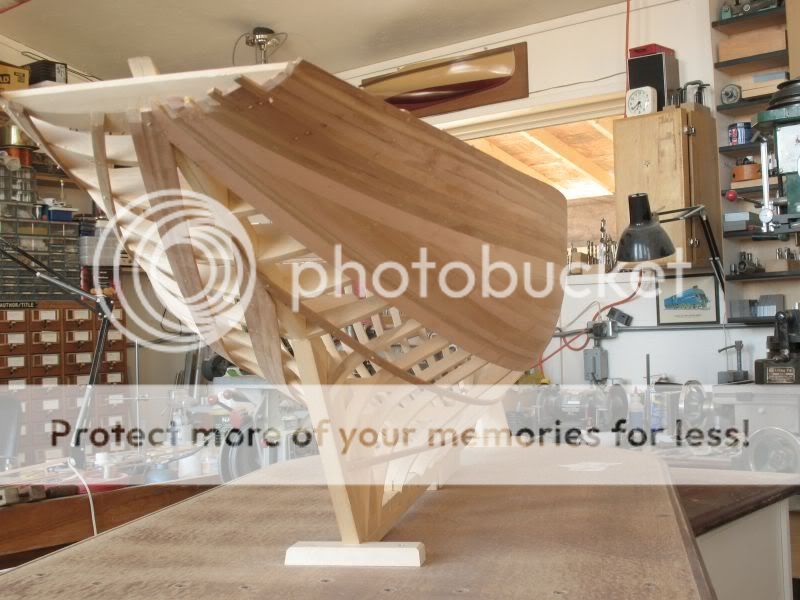

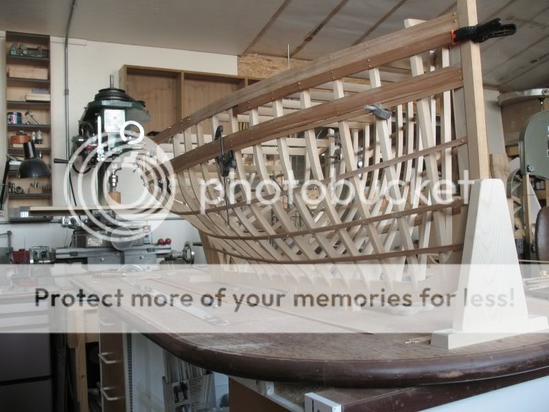

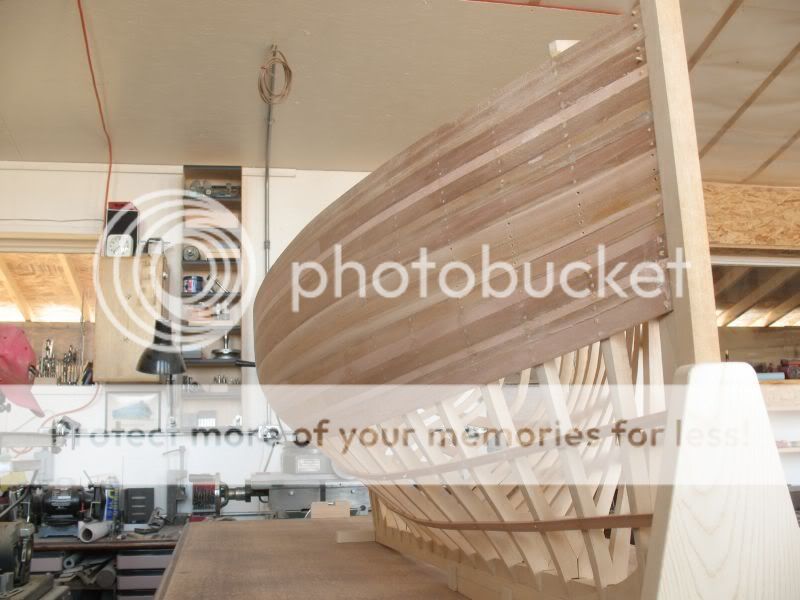

A bit more work on the planking.
and this is only the first layer!
After this first layer is finished and faired I will be overlaying the dress planks which will be done in such a way to imply the caulking on a real boat. Now there is my real challenge, this is where I get into Marc and Chuck Doan territory, scary indeed.
