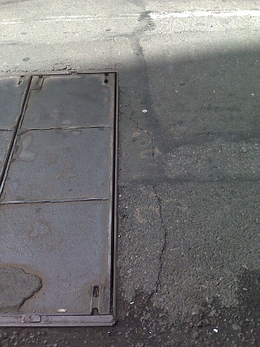

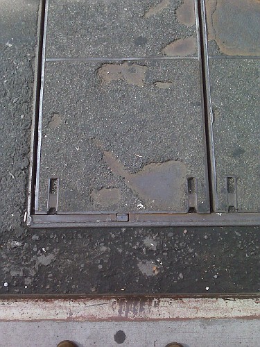

I've decided to make a model from outside MoMA that I saw on 08-08-08. Here are some crappy BlackBerry photos
The street has since been repaved so I have only these, my sketches and images from Google Maps...who would have thought I needed archive photos from only three years ago.

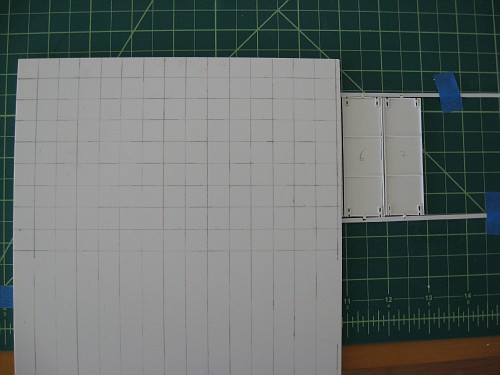

I started by making a small small sketch to nail down the composition followed by a scale plan on ragboard

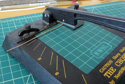

Then I started making the plates. During the process the Chopper was invaluable. The plastic is 10 thou and 5 thou card. The metal is brass that has been folded to give the correct scale thickness and then annealed on the stove burner.
I'm this far on two of the seven plates. More details to add and some tidying up to do, but its taking shape.

I'm working on how to replicate the crusty/flaky look of the steel. I have a few experiments to carry out. As soon as I have results, I'll post some more updates.

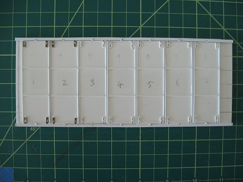

Time at the bench has been scarce for all kinds of reasons, but I have made some progress:

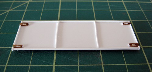

I finally made seven of these plates. The first two I made with brass parts but it proved to be so fiddly that I gave in and went with styrene:
Then I had to make the edge retainers with the notches in exactly the right spot. That took a lot of thinking time, and once worked out went very smoothly:
And then I ruled up a sheet of 80 thou plastic to use as a base onto which I assembled the access plates
glued the retainers in place and cut it to approx size
