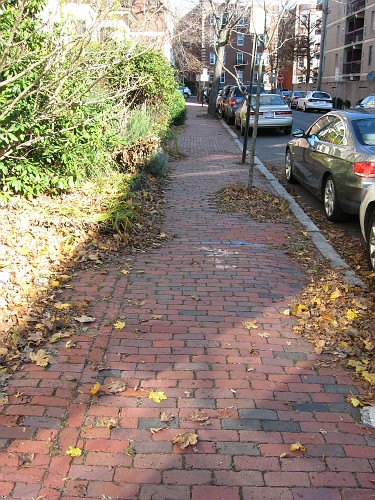

This build is of a section of Bigelow Street outside a friends house in Cambridge MA.
this is the street in question

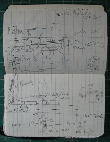

I usually takes lots of refernece pics (around 100 in this case) and also make doodles in a note book
And then make a full size (1/24 scale) drawing so that I can work out composition etc

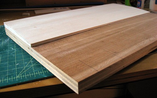

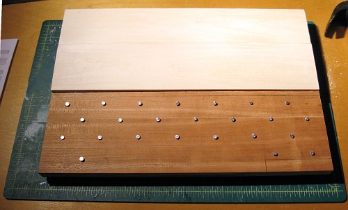

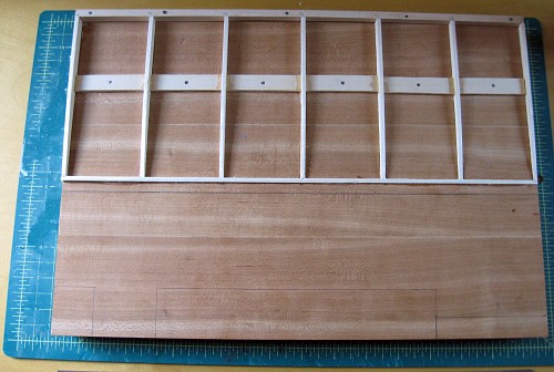

The measurments are then transferred to the base (3/4" plywood) and I start adding internal supports for the contours. These ribs are to give the road a crown.
And on the back I add some risers which will allow it to hang on the wall and also give it some height so that it "floats" rather tan looks like it sits flush.
And the road contour is then planked with basswood making sure to give it some more height at one end

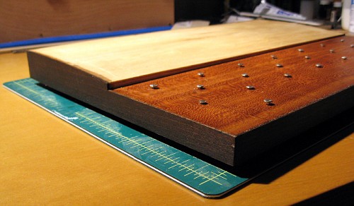

And flat headed tacks are added (a la Hamilton) to hold plaster in place where the brick sidewalk will be

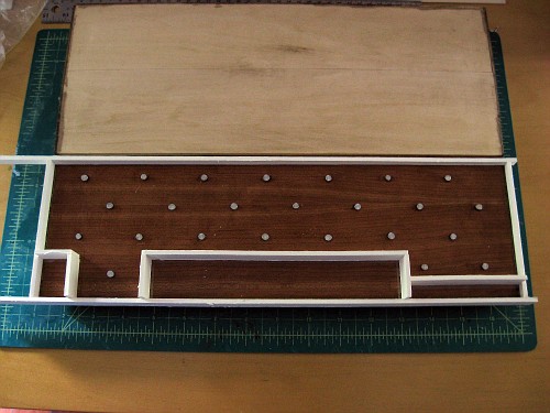

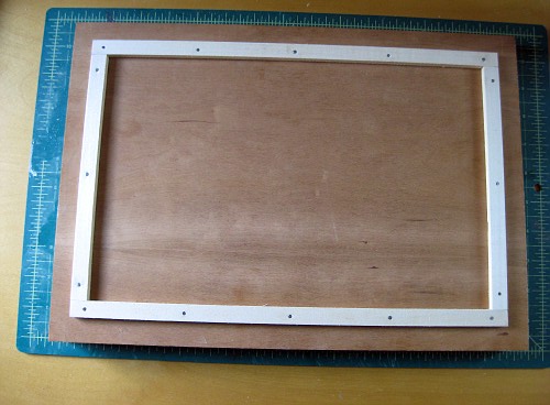

I gave it all a good shellacking to stop corrosion on the tacks and the seal the wood and added edging strips around the base

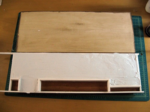

then made dam walls for ther plaster out of cardboard
and poured away
which was followed by the messy business of carving the plaster to follow the contours of the sidewalk

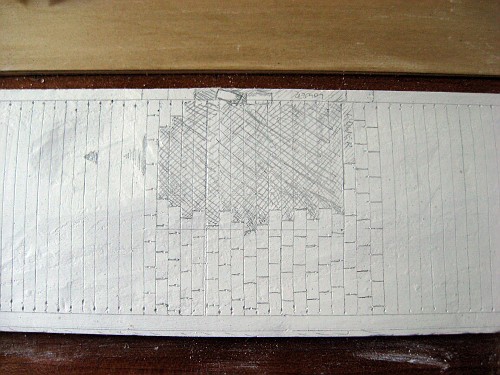

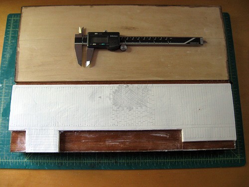

And which was followed by drawing on the locations for each brick, which is trickier than it sounds.
And the lines were then scored using the back of a No 11 x-acto blade

Christian, excellent how to , so far.  Takes grit and determination to layout and score that hydrocal and produce what looks to be a fantastic side walk.

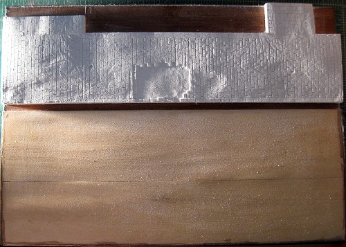

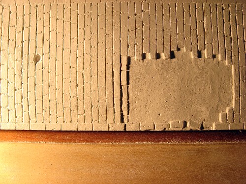

Her are some details of the brick carving to give some more 3-d to the surface and create spaces for the tree-planter, gas hatch and water valve.
I used oils to paint the bricks. They gave a nice long working time and I have found I can control the surface from matte to a slight sheen which is what I wanted
I then had to give the bricks some texture so I placed a piece of sandpaper face down on the plaster and burnished the back of it. Then I stippled the surface of the plaster with a wire brush to give an appearance like this
I know that some dark washes will take care of the exposed white plaster.

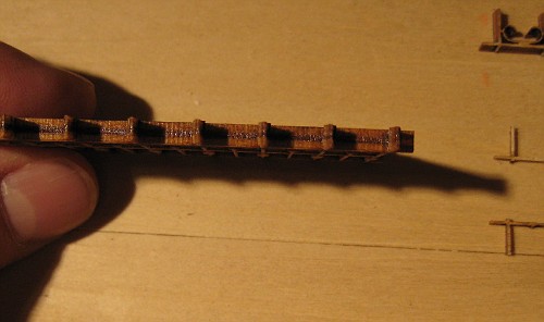

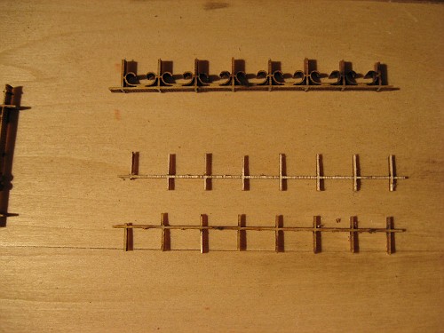

The edging to the garden gave me a headache for quite a while. The prototype has a specific fleur de lis style top to it and I was not able to find anything that gave the right look. This was when I wish I had some CAD skills...any advice on this subject is welcome (what programme to buy autoCAD, Alibre etc etc, and how to learn to use it).
I found some dollhouse siding that had components that seemed useable
But it was 3x thicker than I needed
so I soaked everything in superglue and started cutting it up and then in half lengthways
And then I glued it all together to give me what I wanted which was 95% (at this point I had to give myself a perspective reminder) true to the prototype
