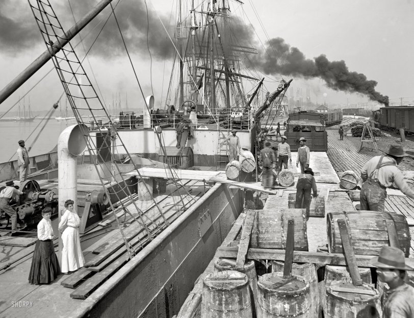

This photograph, recently featured on Shorpy.com, shows barrels of pine rosin being loaded onto a ship.  Note the distinct shape and size (smallish, barely tapered with an almost cylindrical side profile) and the reinforcing boards across the heads.  Rosin barrel construction varied from year to year and from producer to producer, but the barrels in this photo are pretty close to the archetype.

Man, those barrels in the Shorpy pic are some of the worst barrels I have ever seen. They look like they were made by half blind ferrets!

Marc, you're right, these barrels could only be used to store very solid things.
(Apples in the Treasure Island of Stevenson, maybe).

QuoteMan, those barrels in the Shorpy pic are some of the worst barrels I have ever seen. They look like they were made by half blind ferrets!
If by "half blind ferrets" you mean "half-drunk uneducated backwoods peons" you'd be correct.  There wasn't much motivation for craftsmanship since the pine rosin was basically a solidified crystalline mass that water would not dissolve.  It was expected that some of the melted liquid rosin would ooze out of the cracks between staves when the barrels were filled.

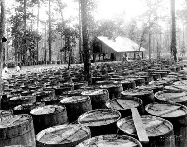

A few more inspirational photographs-- rosin barrels after packing at the still:

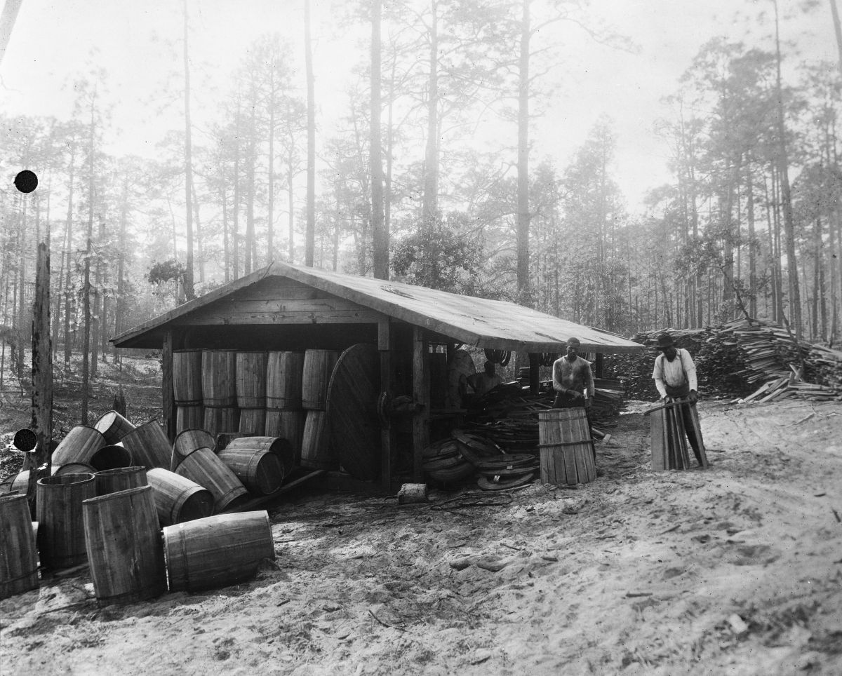

Backwoods cooper shop, note the stacks of staves and prefabricated heads:

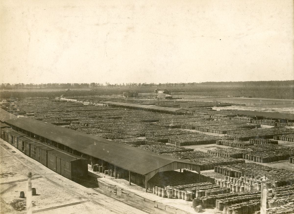

Rosin yard at Pensacola, Florida, showing what I'd be up against if I were to attempt modeling this end of the industry:
That last shot reminds me of the warehouse at the end of "Raiders of the Lost Ark"!
