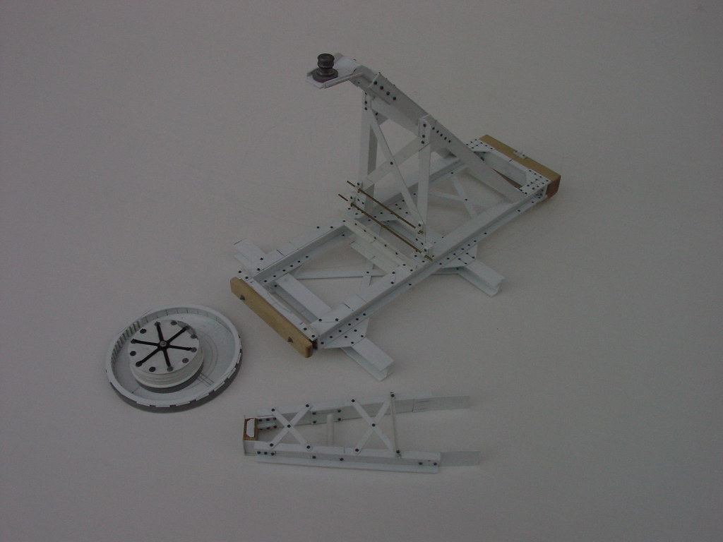

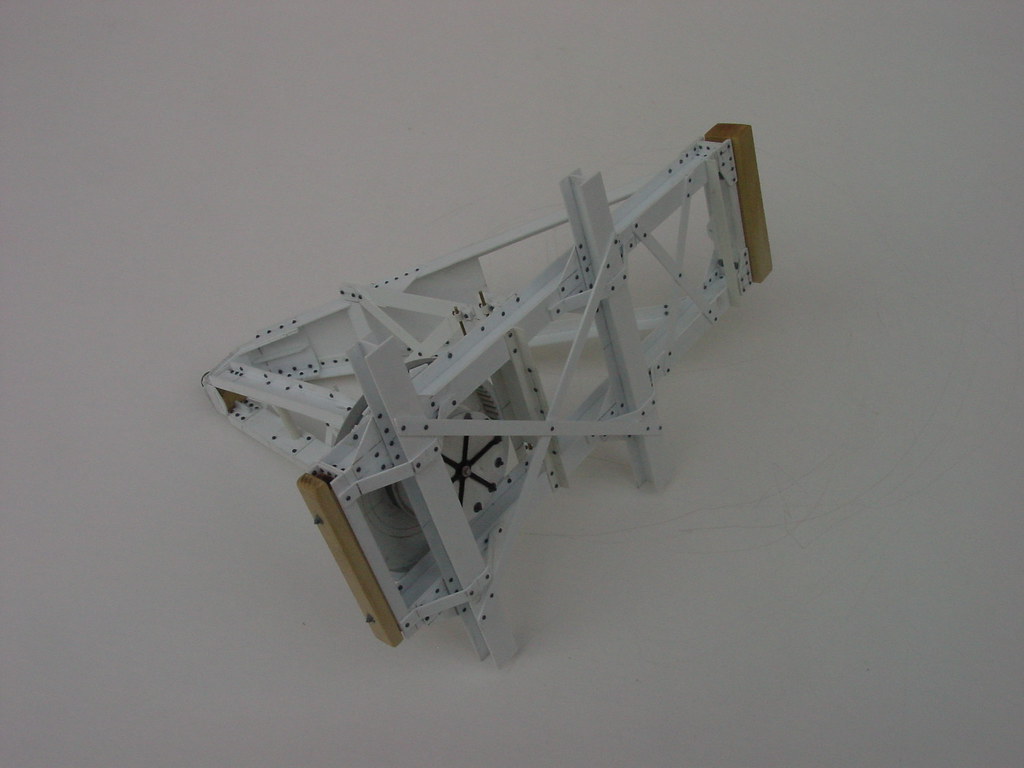

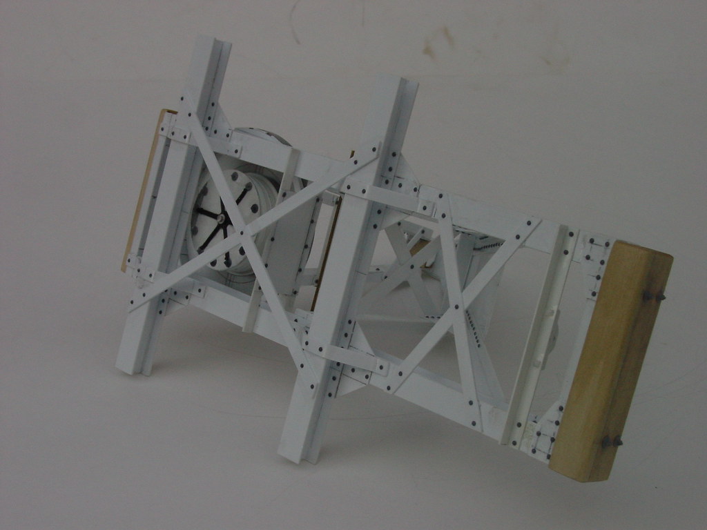

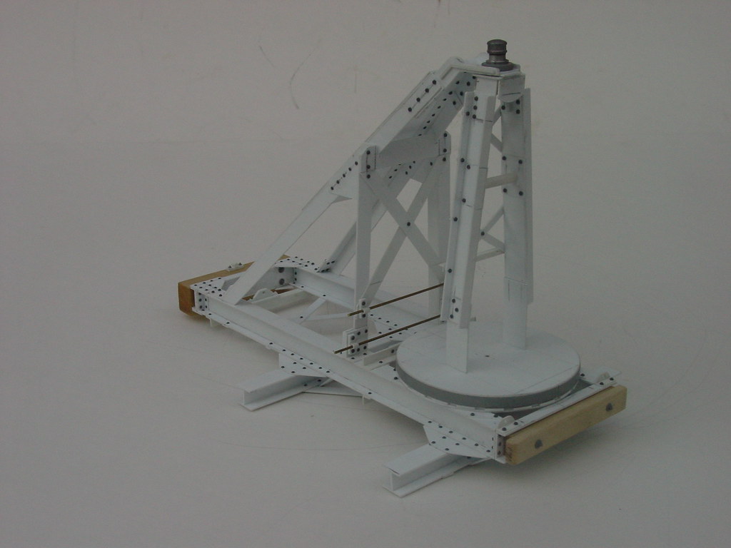

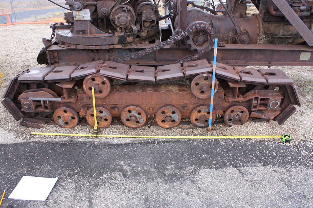

I will start this out with these four photos of the prototype

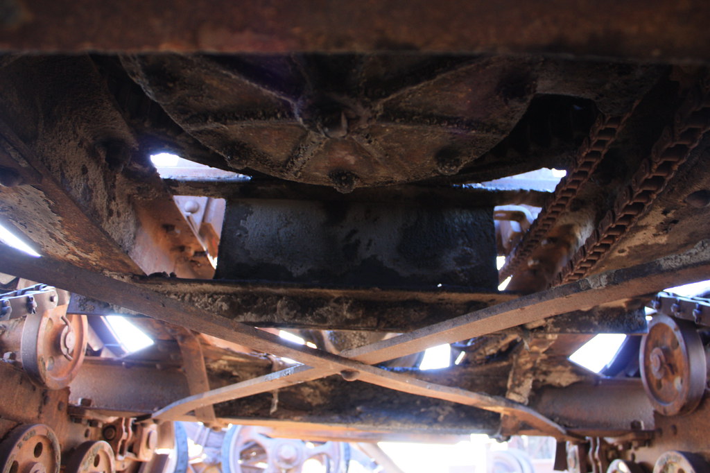

Lots of underbody details I did not know about.
How do you do the neat, crisp, clean 45 degree bends?
the usual hot water and bend?
Not having good luck with .010" x .100"............
Great stuff Gordon. Like the precise rivet work particularly.
Marty, I just did a cold bend on my strapping work, but I'm working with a 030" x 188" piece of styrene. The 010" x 100" styrene is just to small to work with without having problems. It's the same deal as the tension rods on the boom. I would go with brass but then the brass is harder to glue. Your 1:48 scale stuff is wonderful, but I think that the large scale bug needs to bite you a little harder.
