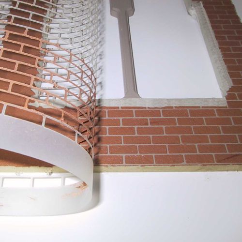

I was looking at these Dolls House stencils. Available in Brick, Stone etc. The website says that they are made from a "tough plastic/polyester" material. Curious if you can cut them. The ones on the website are 1:12/1:24 .. evidently you use a stencil adhesive spray to hold them to the surface and then glop on the brick/stone compound. Looks kinda neat. Would be cool if we could get something similar in the smaller scales.
