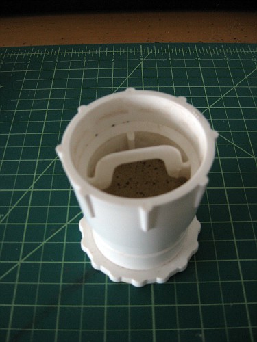

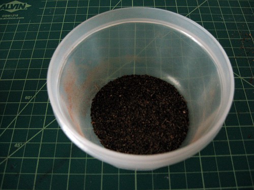

I needed to make a lot of very fine debris to fill the cracks between the bricks. I did this using tea from teabags that I saved and dried out after they were used to make tea.
I ground it up and sifted it to get the very finest particles

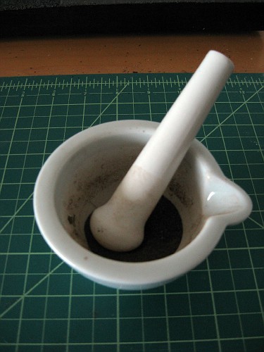

and ground it again with a mortar and pestle to make the particles ever finer

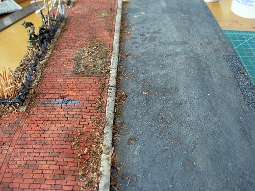

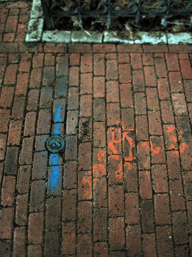

And then I spinkled it into the brick surface and rubbed it into the gaps with my finger. I also installed the water and gas panels andf the little sign post bracket (that are everywhere in Cambridge and which trip you over all the time) and added utility marking and weathered a little. I did change the place of the orange markings to improve the composition...I'll call it artistic licence.
The utility markings are a nice touch of extra realism.
I'm really impressed with the details.
The markings are perfectly done  (I checked....I have a bunch in front of my house ;) )...so is the cast iron acces cap.
If I didn't know better I would say the phot with the blue marking, was the real thing.
nk
Thanks for the comments. Much appreciated. The utility markings are always there in Boston, its like the Big Dig never ended...
