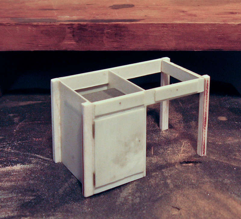

I'm quite sure you meant something like that  ;):
This is going to be the desk for the janitor. Please forget about the picture quality; i'm happy to have at least this one from building it ...
I'm going to add more interior when the entire surrounding on the module is finished. And to think that it all started out as some little exercise ...  ::). The module would fit in my car with buildings. If I fix them (and I guess I'll do it) I have to built an additional wooden frame or box for protection during transport.

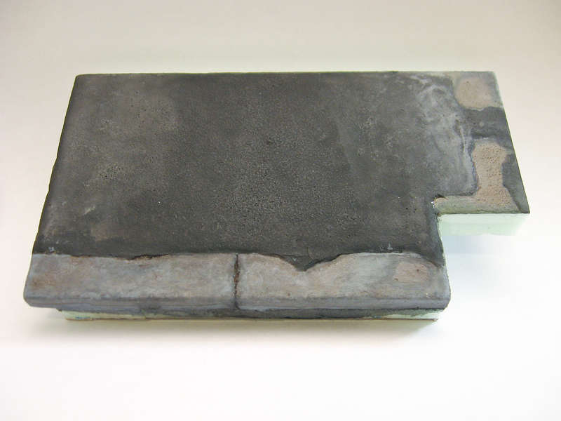

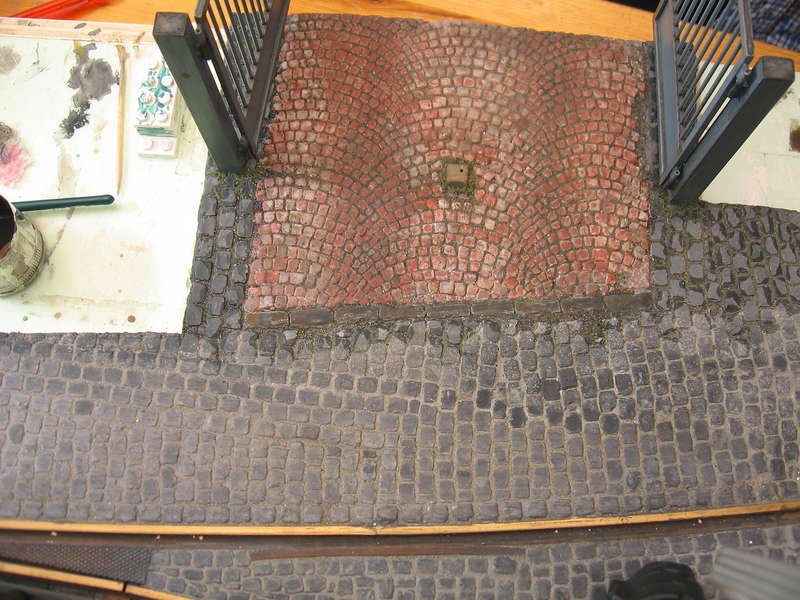

thanks for your words and attention, too - and I'm not going to disappoint you: This is the curved cobblestone of red quartzite (what the heck is Segmentbogenpflaster in English?) at the companies driveway.
This is the mastic asphalt at the gatehouse's passageway.
Please excuse the sloppy work.
Quote from: Hydrostat on February 01, 2013, 01:08:31 PM
Segmental arch pavements ... sectional arch stones ... arched stone sections ... arched sectional stones, etc ...
Basically, Segmentbogenpflaster = "curved cobblestone" just as you started to say!  ;D
And it looks darn good.  8)  -- Dallas
I particlarly like the stone in the middle , for the gate anchor.
What did you sue to make the asphalt? Looks good. Is this Narayan's method?
Dallas,
thanks for your translation. Nice to hear that you like it.
Marc,
its a similar method to Narayan's but I used other materials. Some voice is whispering in my ear and urges me to say: I'll write about it in detail in the next Modelers' Annual.

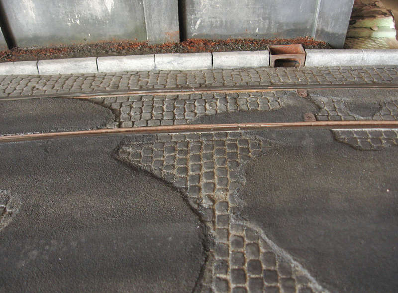

After preparing the cobblestone road I started with the asphalt. I tried Narayan's method described here with silicon carbide F60, glued with a mixture of PVA, water and some detergent. The material doesn't smooth out well neither dry nor moist. I have therefore spread a first layer which is a bit wavy. After drying, I applied some finer material F80, smoothed with a spatula (which is now possible because of the leveling is done by the substructure from first layer).
The points at which the tires roll received some basalt grain 0.1-0.3 mm (0.004' - 0.01') for a smoother surface. It looks like this:
The grit still seemed too coarse and the glitter too strong to me. So I spreaded grain basalt and black porphory dust and grit over the entire surface again and glued it. After drying, I'd spread the tire rolling areas with slate dust dissolved in PVA and water and diluted it sidewards with water up to zero. This last step can be seen here.
After drying, the surface looks credible, but not the color.
So I treated the road with black gouache, which was applied on the tire rolling areas almost covering whilst on the other areas very dilute. After drying I swept some black porphory dust over again and fixed it with a special modeling glue by KS Modellbahnen, which doesn't darken like PVA does.
Franck Tavernier
Well done!
Realistic asphalt effect with cobblestone under road  ;)
Franck
Wow, very cool.  I love the textural variations in the roadway.  Good sense of old and new with the different surface finish.
