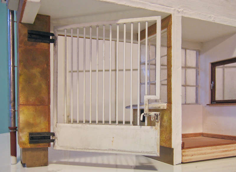

I added a gate to the gatehouse:

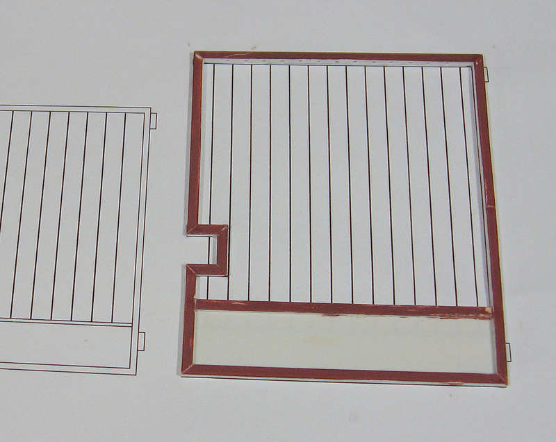

After I had decided on a welded construction, I started with a full-scale drawing, where I could place the surrounding frame of polystyrene 2.5 x 3 mm. (0.094488'' x 0.11811'') The even hole spacing I received by using a perforated plate with 4 holes that I've moved farther center starting each time until I arrived at the border.
The hinges are consisting of a brass plate, brass angle section, two brass screws imitations and rounded 0.5 mm (0.019685'') wires.
The chatter on the angle sections and the tinning are somewhat fierce ...
... but after burnishing no longer so.

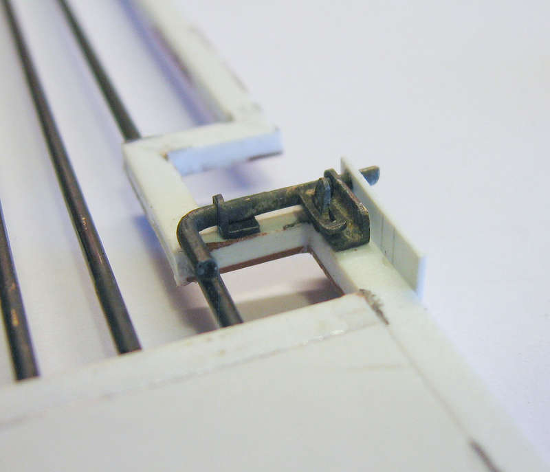

A bolt came at that. Ingredients: 1 mm (0.03937'') iron wire, some nickel silver and brass angle section. The slotted member is brazed to the wire.
The gate then got a paint with white gloss paint from a spray can. The hinge bracket and the stop I have left black. I think another gate had hung there before. Then I aged the gate with very dilute water and emulsion paints. Meanwhile I reduced the rust beneath the bolt; it's a bit too much as seen here.
Fantastic detail!  Especially like that little bolt ... a common, ordinary little thing that's seldom modeled ... captured beautifully!  Notched design of the gate is another very nice touch.  -- Dallas
I agree with what the others have said.
Just lovely. Great eye for details that are so often missed, or ignored.

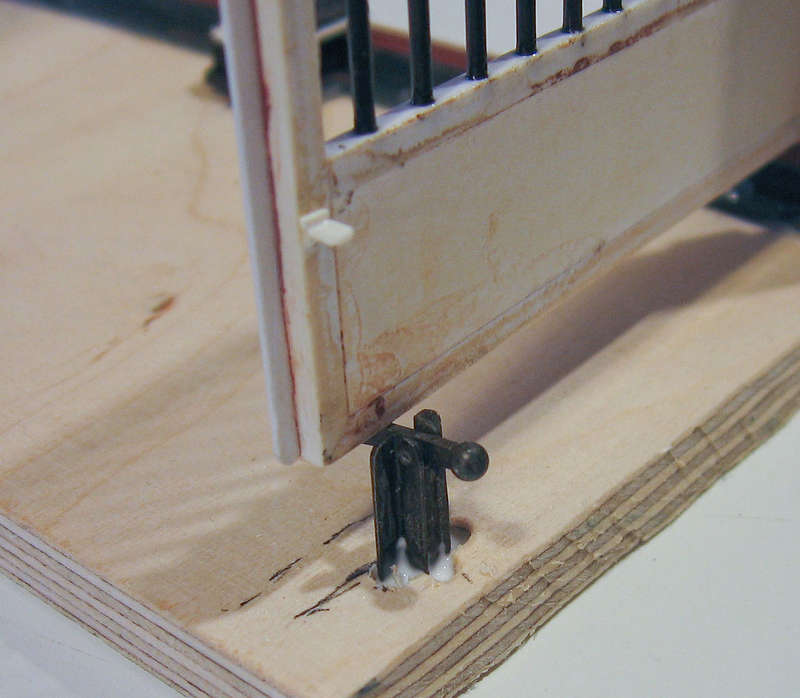

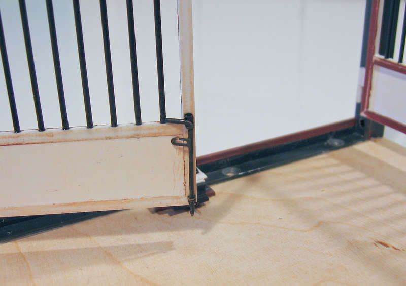

I finished work on another gate for cars that will be placed between the administration building and the gatehouse.
The construction is similar to the one at the gatehouse. Only the loaded plates are created from cardboard and not from PS. And I'll show you some "prototyping for the poor" after getting you bored with a few pictures of latch, hook catch and run-up support.

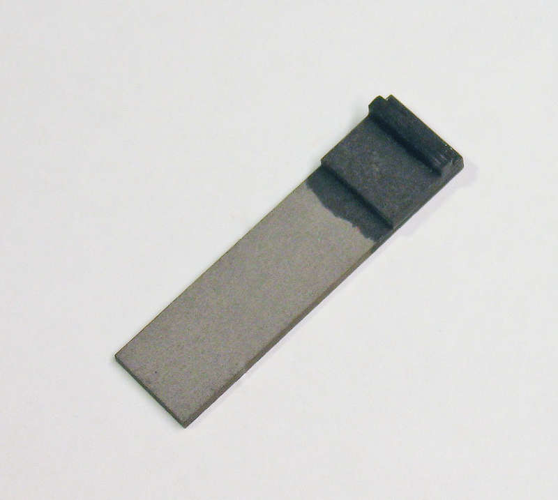

And that's my "prototyping for the poor". The layer thickness is 2 mm and the layers are joined and sealed with superglue. And it's all handwork. ;)
File and sandpaper then take the final shape. No, seriously: it's a fast and cheap method for little detailed parts with mostly straight faces.

This shows the future position of the gate ...
... and the following pictures show harmful effects of industrial precipitation.
Unfortunately, I did not seal the loaded plates in the lower door area with superglue. Since weathering the doors are a bit warped ...
