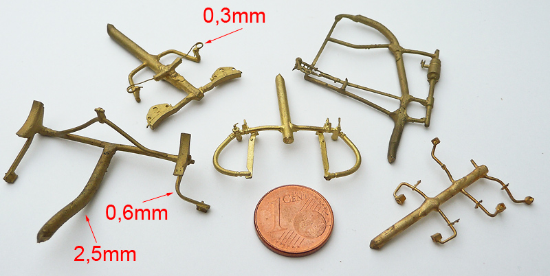

On the other hand your 0.7mm wire will go a bit closer to 0.6 mm. Smiley
When I made the master for the axleboxes with leaf springs, I allowed for 4% shrinkage, and that worked out pretty well.
I will probably make a casting of the valv/airhose, but I wonder if I should include the hose with the actual connecting hardware. Since there was several different implementations of this valve/hose, I will make a long, straight casting that can be bent into shape.
Anyone that have tried to bend cast brass? Is it too brittle to bend  into a curvatere like the one onmy hanbuilt parts?
From what I have seen, it is possible to cast brass in remarkably long and thin sections.
Regads, Hauk
"I believe in the wasted years of work." -Wislawa Szymborska
Posts: 120
« Reply #149 on: April 03, 2012, 07:25:11 AM »
Brass casting can be bent quite. I've just tried again. Even 2.5 mm can be bent, if a bit arduous!
Those parts from my G20 model ...years ago as I had built in scale 1:43,5.
