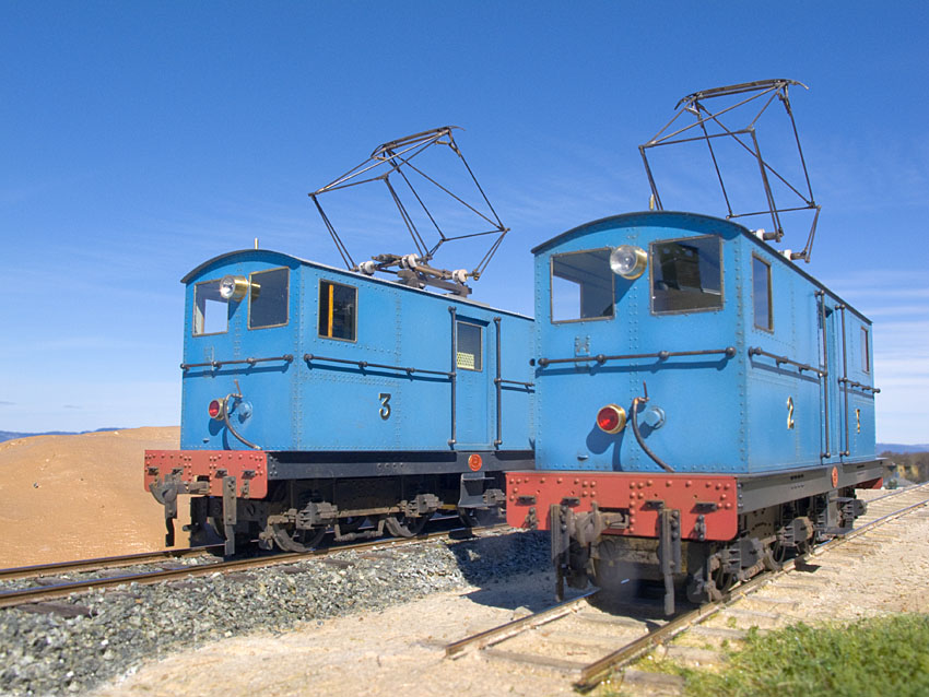

just great! Now two overhead lines, extending the rails at the front right, a figure behind the pane.... and  you've got a 150% illusion. The perspective is great! Five stars!
Are they run capable meantime?
Quote from: fspg2 on August 23, 2012, 10:27:10 AM
Hauk,
Yes, they are wired to run on regular two-rail power. If I dont go DCC in the near future, I will probably use the overhead for constant lighting.

I like to think of this prosject as making a custom kit rather than scratchbuilding. I think the second engine took one tenth of the time. The third one might go together even faster.
