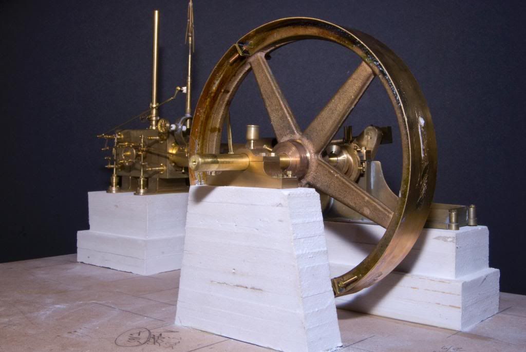

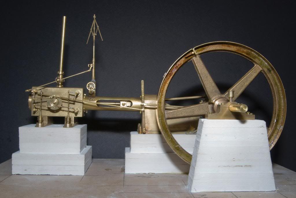

« Reply #171 on: January 19, 2010, 03:22:19 PM »
WOW
I just looked at the start date of this, * months.
Alot has changed since then....
Anyway she's all done, the machining anyway, just need some 6mm brass balls for the governor.
Wonder how long it will take to color it?! Huh Roll Eyes
« Reply #172 on: January 19, 2010, 03:32:01 PM »
Wow  Shocked, That's just a beautiful model...visually and technically. Congratulations!
I think you have found your niche........"Scratch-built Brass Models".
Posts: 5687
« Reply #173 on: January 19, 2010, 04:24:18 PM »
Not bad overall. You are beginning to get the hang of basic model construction. -- ssuR
Philip Smith
« Reply #174 on: January 19, 2010, 07:54:28 PM »
yep . Give me a small pinch of your skillz.
awesome build!
Philip
« Reply #175 on: January 19, 2010, 08:49:06 PM »
Marty:
It looks fantastic... excellent job. It probably says somewhere in the thread (ut I'm too lazy to go back and search for it), but did you cast the wheel core yourself or did that start out as part of something else?
The plaster bases look much better than your initial experiment. Really looking forward to seeing how you colour this....
« Reply #176 on: January 20, 2010, 06:44:26 AM »
Thanks guys,
Marc, F*$K that!  Angry I am going back to styrene and wood-much faster to build! Wink
Paul, The wheel center is the only store bought part  Sad It is for a live steamer, found it on that auction site.
Working on taking a movie of it in action.
