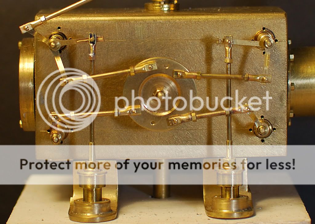

Holy moly!! That looks beautiful! And very complex.
Is this going to be a working model?

And yes the linkage is all functional. ;D ;D ;D ;D
Real nice work!
For the working links, how do you obtain nice, tight rivet connections that are not locked up?
I have been dabbling with rivet connections for functional linkages, but I find it hard to obtain consistent results.
Do yus any special tools?
Regards, Håvard H

I'll have to paint it, it is silly to make a scale model and then leave it as a "toy"
Dont worry though, there will be plenty of brass showing  ;)
Gil / Ray,
This will be a "dynamic" model; it will operate but i will use a small electric motor hidden somewhere.
Once I get it going I will shoot a movie (then figure out how to post it ???)
Havard,
The connections at the links are not rivets but bolts.
I can see how they look like rivets in the picture.
The originals used acorn nuts so that is what I will use, just have not ordered/installed them.
Sorry for the confusion!
I wish I could do rivets in .030"!
I would think using a .032" tube and flaring the ends with a die of sorts would work.

Quote from: lab-dad on January 05, 2010, 05:01:36 AM
Havard,
No kidding?
I could have sweared that you must have used rivets to pin the four arms to the solid wheel in the center...
I would be very interested in where you can obtain such bolts, maybe I could substitute my rivets for bolts in some situations. Are there hexnuts on the back?
Regards, Håvard H
Havard,
QuoteI have been dabbling with rivet connections for functional linkages, but I find it hard to obtain consistent results.
I solder rivets keeping moving parts together. I learned the trick from Pete McParlin of Backwoods Miniatures.
Punch a hole in a piece of printing paper and put it between the 2 parts. Push the rivet through and solder the rivet to part closest to the end of the rivet. File solder joint nicely round and remove the piece of paper. Has worked for me with H0e linkages of BM's Fowler and for the On30 Mallet I am building at the moment. Works much better than the shoulder rivets from Weinert, etc.
Havard,
The large disc (wrist plate) is drilled and tapped, the bolts come through to the front and then I will attach the acorn nuts.
These are 1mm, scale hardware dot com has functional "bolts" down to .5mmhttp://www.scalehardware.com/
They are only 10 miles from me but I still just mail order.

Good tip Jacq. Another method is to use graphite as a barrier. You can actually do this with a soft pencil or NeoLube, just draw or brush a line at the outer perimeter of where you want the solder to flow. It won't flow past the graphite unless, you're using way too much solder.
  Paul,
  what is important with the piece of paper methode is the small clearance ( 0,3mm) enabling free movement around the rivet of the linkage part.
  I have used barrier material preventing solder to penetrate too deep, but it resulted nearly always in a too tight fit of the parts.
  That piece of paper is just enough to take care of tolerances associated with the linkages.
