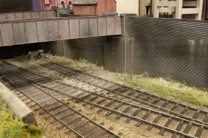

So, I have revisited this area of the layout to get the effect back. Also to make the canal look a little more downtrodden. I have used a thin layer of clear resin and the same baking soda in wet varnish trick as I used originally. Results are seen here

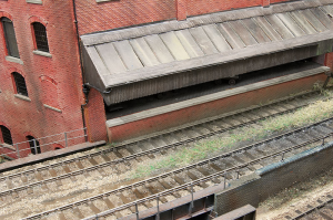

Now this is properly subtle. I have revisited the layout with some Tamiya smoke and AK wet effects to see if I could increase the wet look a little. The smoke provides the darkening  effect of the rain.
It a little easier to see on the light walls of the pub.

The thing is I know its darker because i knew what it was like before. In order to give fresh eyes something to compare it with I needed a few areas of contrast.
By the warehouse i can leave the area under the canopy dry to give the contrast I was looking for.
At the other end the areas shaded from the rain by the bridges. Its important to make sure the rain falls in the same direction. So the buildings don't have smoke applied to the sheltered walls.  Its the area above where I feel the effect has come out best.
