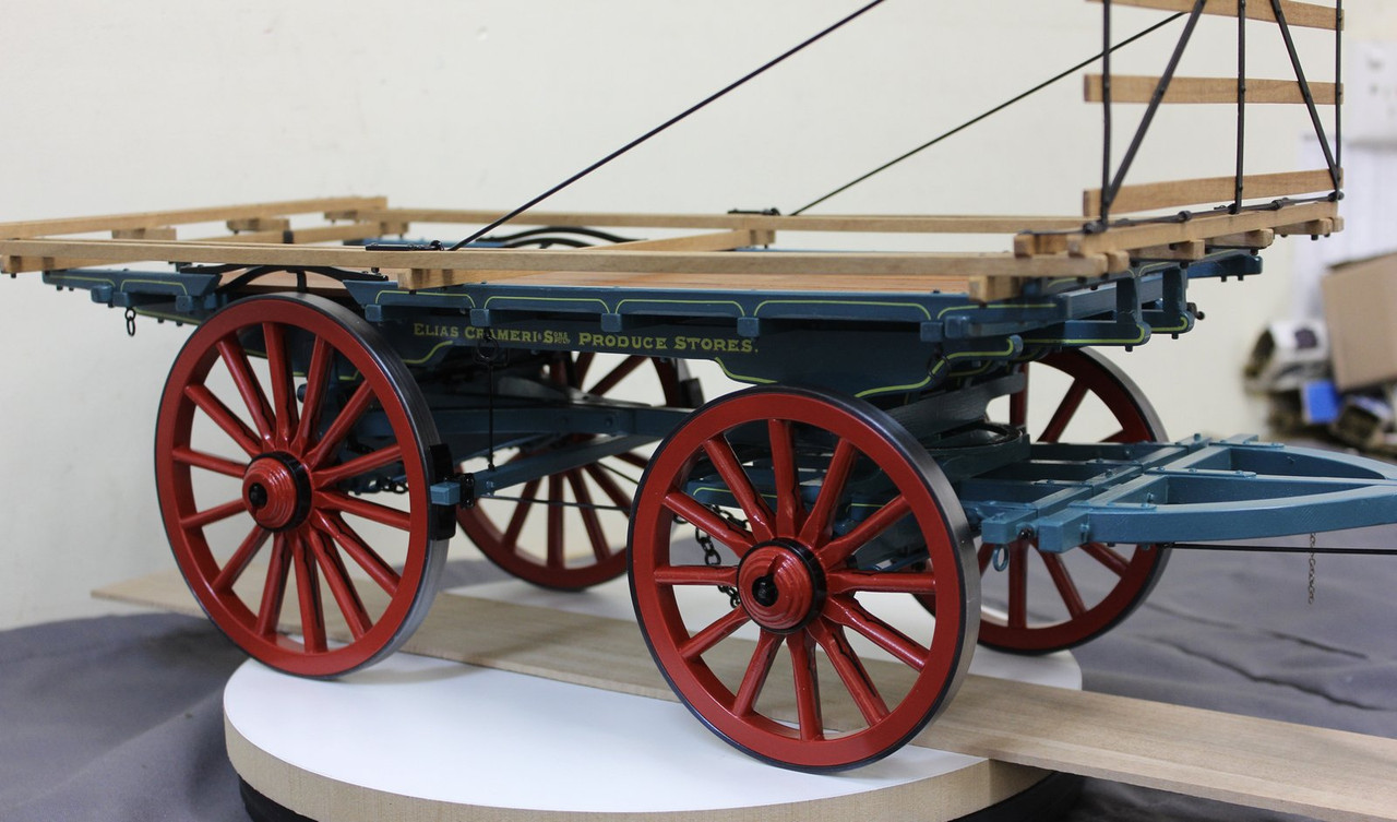

Question for you-
For the pinstripes on the rims of the wheels of your Concord buggy, are those a single decal, or are you applying it in sections?  I'm trying to imagine handling a single decal that large while trying to keep it concentric.
Eric Zabilka
Lexington, Kentucky
greenie
G'day Eric, the decals for the rim of the wheels are made up of 4 sections, so once printed and then I will apply two of the sections to the rim, think 12 to 3 and 6 to 9. Apply these two sections to all wheels and after they have dried and stuck to the rims, then do the other two sections to complete that circle on the rim. Try doing them one after the other is fraught with danger, as each bit is still floating and they just move all over the place, voice of experiance speaking.

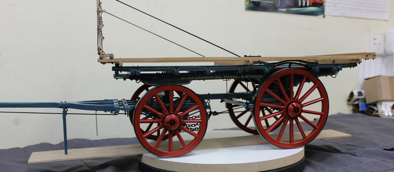

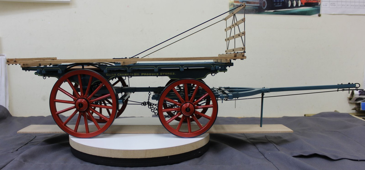

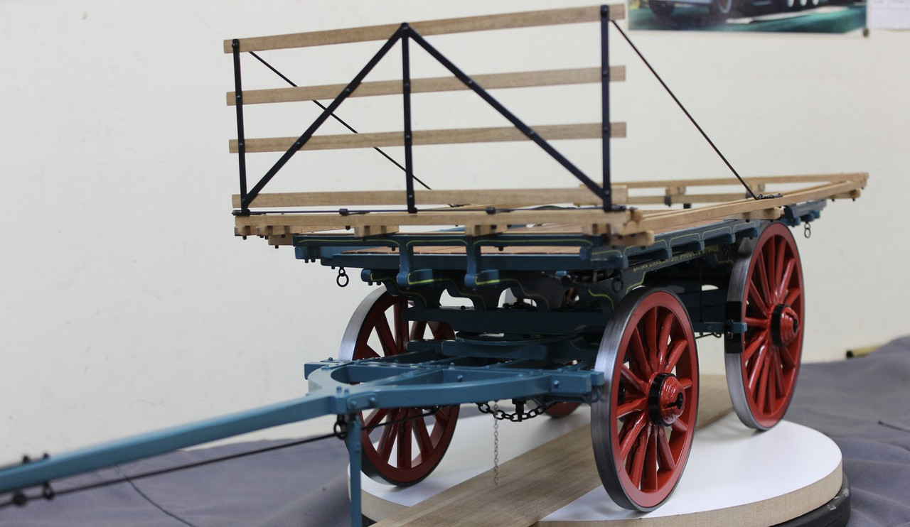

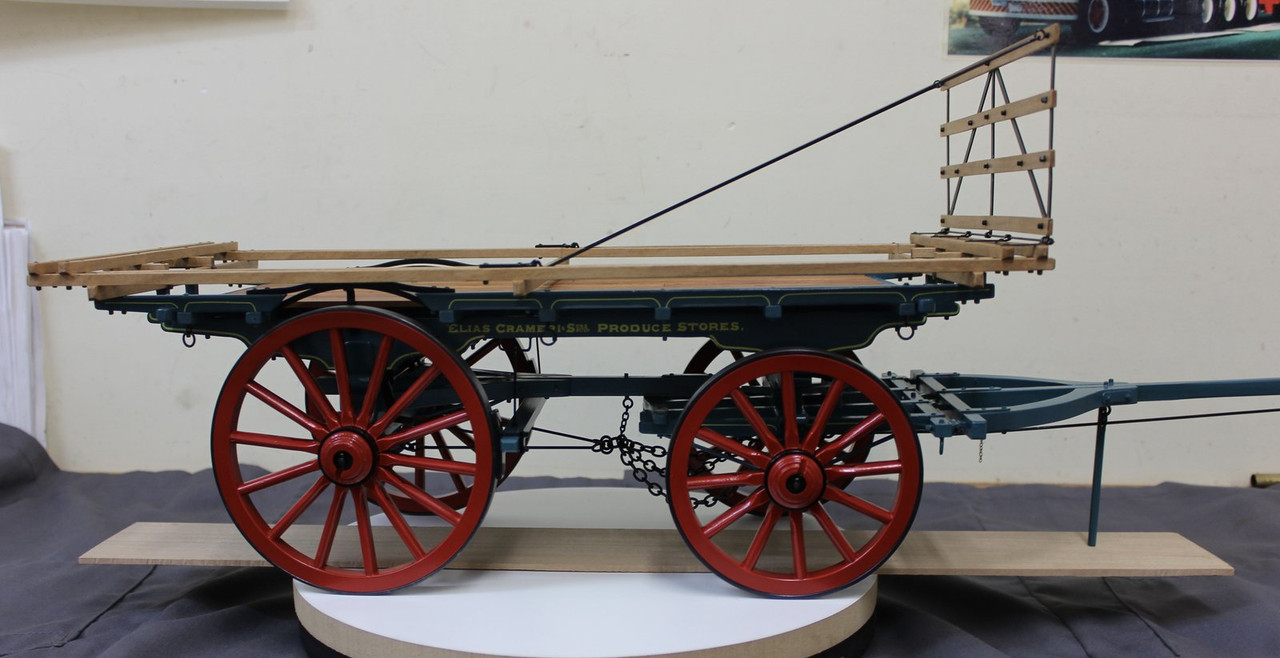

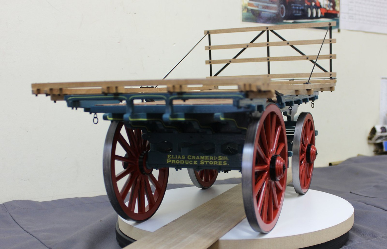

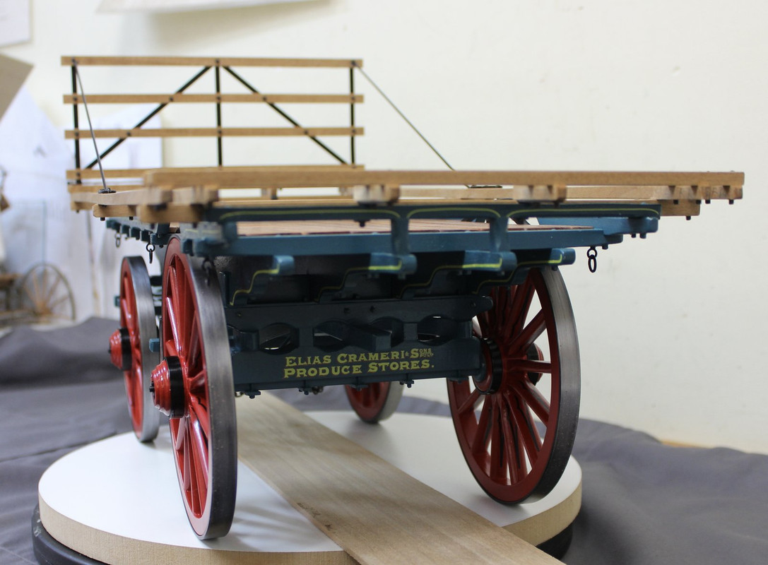

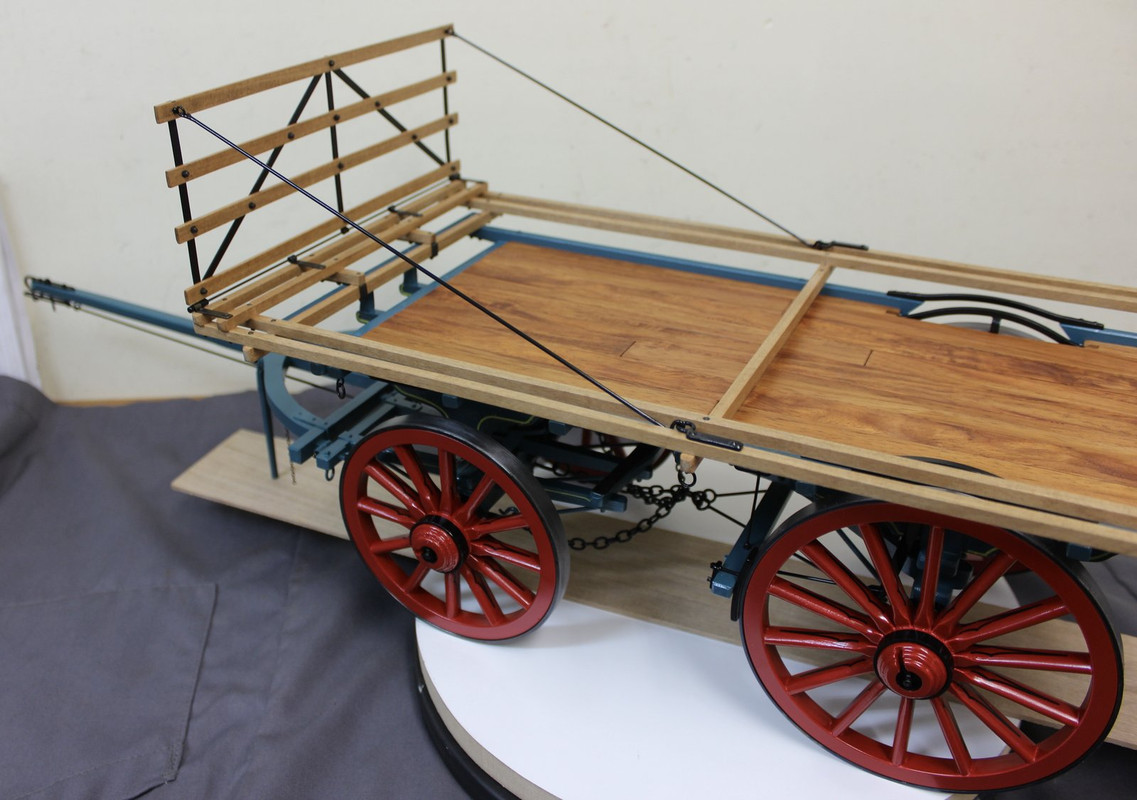

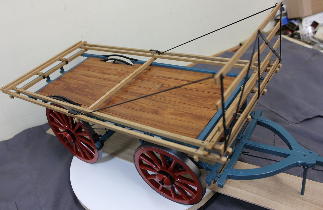

Another one bites the dust, this time it is a Table Top Waggon, or a Platform Waggon, made once again to 12th scale, using the drawings which were published in "The Australasian Coachbuilder and Wheelwright, Oct, 1916".
The only thing changed from the original drawings, was that I turned it into a Bullock Waggon, by changing out the shafts for horses, then adding a Bullock Pole so it could be drawn by Bullocks.
This model has Hungry Boards on it as called for by the drawing, these Hungry Boards add MORE width and Length to the Waggon, allowing a lot more load to be carried.
First photo shows the rear end of a Waggon with Hungry Boards fitted and you sure can see how much more loading you can fit onto the vehicle, when it has the Hungry Boards fitted. Why call them Hungry Boards --------- because the owner of the vehicle is a "Hungry Bastard" for the extra money that they will get for carting a bigger load.

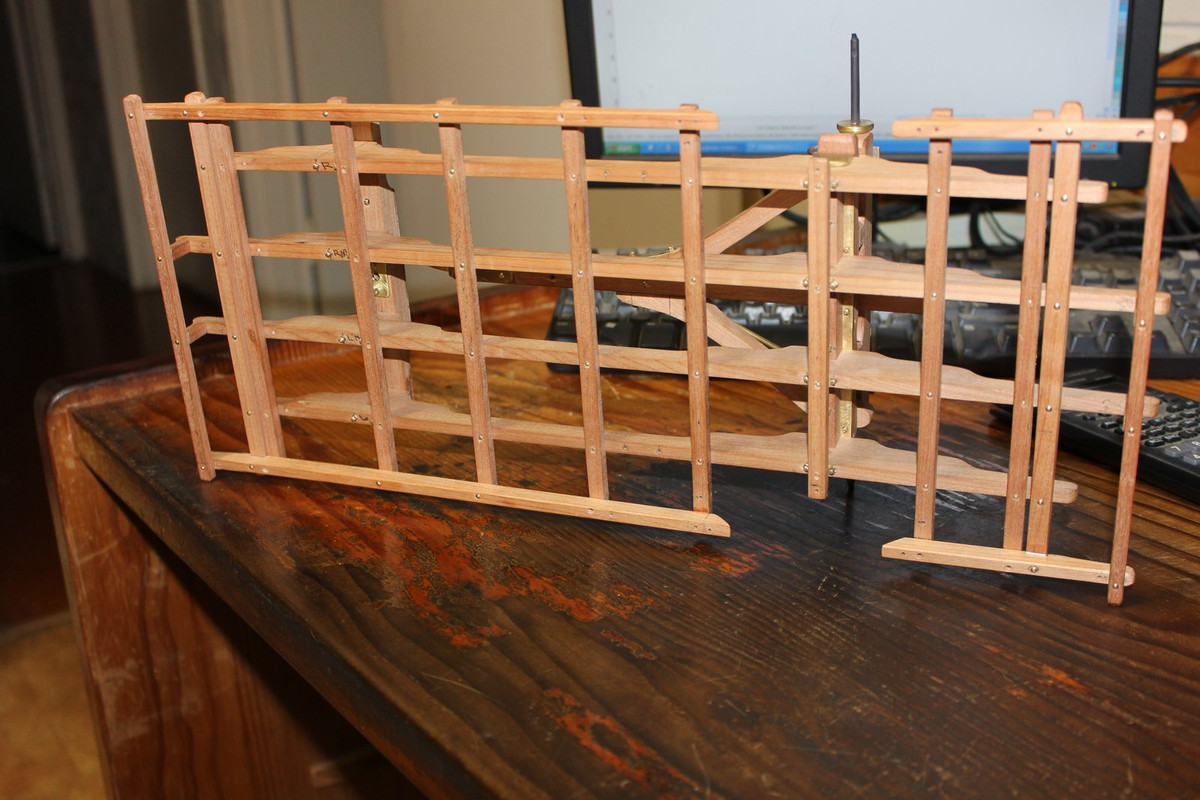

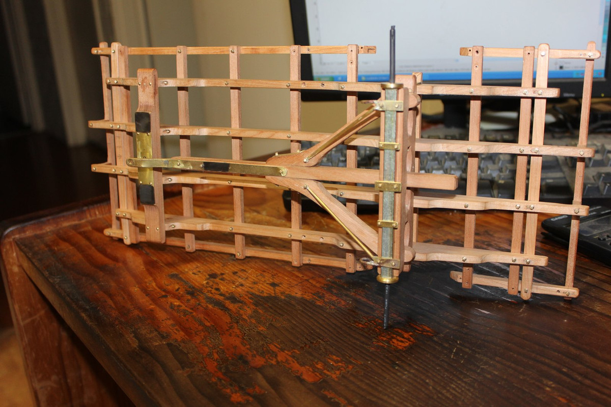

Other photo's show the making of the model and then lots more photos showing the finished model.
Any questions, then please ask.
