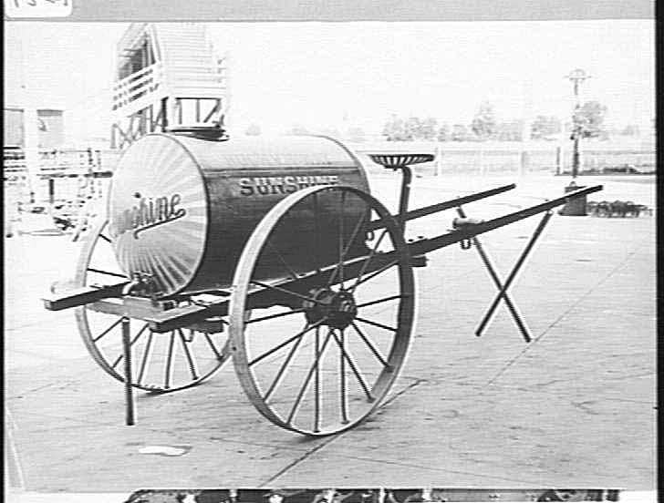

Another Water Cart, this time it is a "Sunshine" Water Cart. Made to 1/9th scale so as can be comparable in size to the Furphy Water Carts.
Started with just a photo, as that is the only one that anybody has ever seen.
Think it might have been made specially for a show and then that one pic was taken, as NOBODY has ever seen a Water Cart like this one in the photo.
Bit different to the way a Furphy Water Cart was made, I somehow think if it was going to made as opposition to Furphy, then it would have cost a lot more to make, as the simple ideas that Furphy used were far cheaper compared to this Sunshine Water Cart.
So the one in the photo somehow might have been the one and only ever made.
Usual methods of construction use in making this model, brass for the wheel rims and spokes, wood for the shafts and cross-members and aluminium for the tank.
The end caps were made from 3mm sheet red acrylic, by another gentleman by the name of Ian Stewart-Koster, he used a laser to burn out the shallow yellow bits, this left the red highlights, then he used a heat gun to soften the acrylic end caps and pushed the domed shape into them whilst they were hot.
 I had to splash a lot of yellow paint onto each end cap, then scraped the yellow paint from the red highlights, even had to paint the inside rear of each end cap white, to make the red acrylic colour stand out.

That's beautiful! Great model, and I love the colors.

Looks like a relatively easy model given your skills and yet another superb beauty. -- Russ

Just used the standard colours that Sunshine Harvester Works used on all their machinery, predominantly red and yellow.

Greenie, another great looking cart. You have presented it very appropriately for a one-of-a-kind prototype show piece. Like the colors.

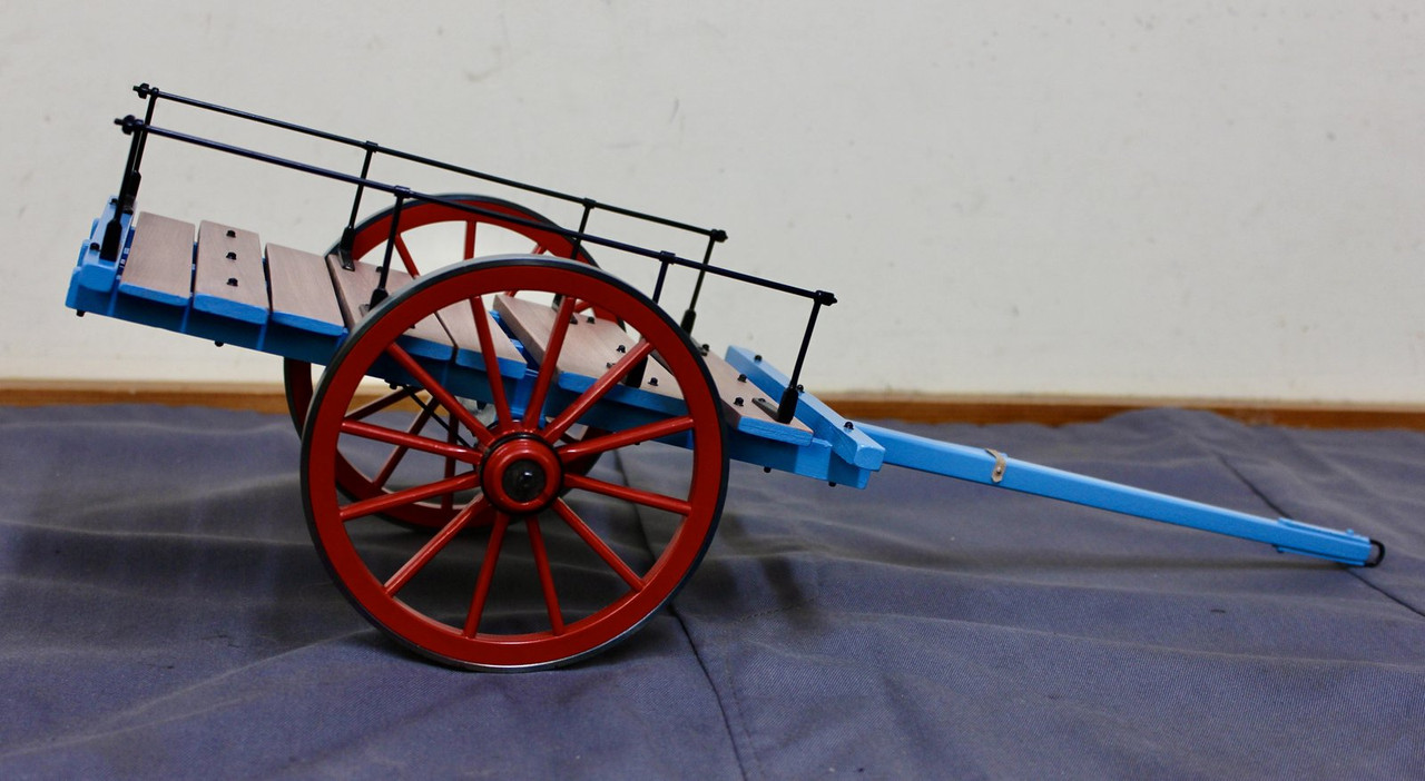

Here's the next one, it's a a Bullock Dray, made to 1/12th scale once again.
Saw the full sized vehicle in the Cobb & Co Museum at Toowoomba and used the full sized vehicle for reference to make this model.
Took lots of photos and lots of measurements, then drew it to 1/12th scale and made the model direct from the drawings.
Used all the usual methods for the construction of the model,  and the full sized vehicle is of a very simple construction, as are most bullock Drays.
OK, the model is cleaner than the original, but it aint anywhere near as old, eh. :-)
 First photo is of the original at Toowoomba, followed by photo's of the model.
