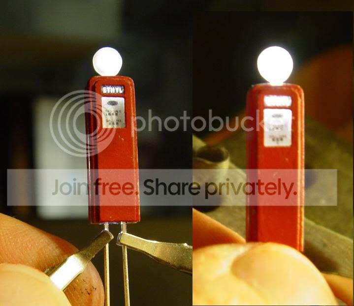

Project resurrected due to an "aha" moment that gave me an idea I wanted to try.  On the previous version, I wasn't happy with the uneven light spread inside the globe, and the clear frosted "glass" of the globe.  On the originals, the globe is milk glass brightly and evenly lit inside.  Something very difficult to do in 1/87 scale, as I found out!
Also the meter face should be slightly recessed, and lit from the front top.  Previous version was flush with the front and back lit.  Not a lot of room in there, but I figured out a way to focus and bounce the light around to where I needed it. The globe is lopsided, because I yanked it from its mold too quickly, also still needs decal, nozzle, etc.  Just a test shot so far!

I've been experimenting with miniature lighting special effects for a couple of years now, its difficult because, unlike oil paints or styrene, you are dealing with strict sets of limitations.  And those are in addition to the strict limitations set by 1/87 scale.   Like Scotty said on Star Trek, I can't change the laws of physics.
Plus there isn't much information, or respectable aftermarket parts.   The science fiction guys have done some very nice work, but most of their applications don't translate well to civilian real world prototypes.
That's my thumb again in the photo, lower left.  This sign will hang over a storefront.
