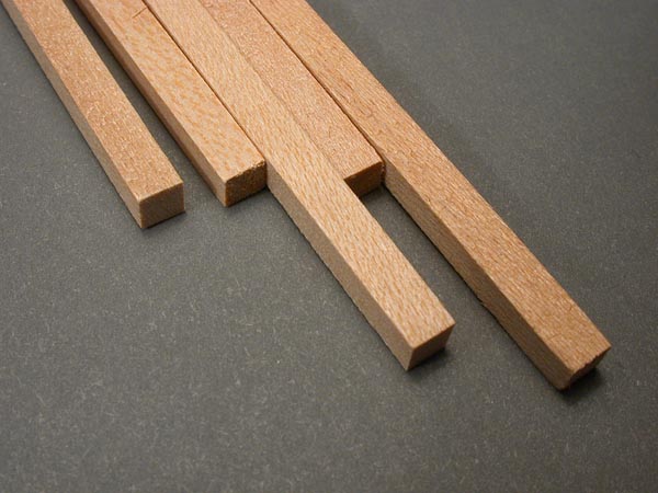

We had a discussion earlier about the quality of different stripwood brands, and I expressed that I was happy with my Kappler wood.  But I am getting  some doubts. See the closeup on the saw table. There are some "leopard spots" that are not due to sloppy staining, but they pop right out after staining with  silverwood. Annoying. If the Mt. Albert Lumber does not have this problem, I will consider a switch.
The problem seems to be that there is some variation in the wood, in lack of a better word:
You can see it on this close-up of some untreated pieces:
The piece second from the left is worst affected.
Paul, maybe you can give a better explanation of what I am talking about?

Wow... that's some of the nastiest looking raw basswood I've seen in ages... Shocked It's no wonder you're having problems staining. Those leopard spots are either the ends of grain fibres, tannin deposits or a combination of both. It would appear that the stock in your photo was cut on a bias (rift sawn) or from very gnarly stock with interlocking grain. The  tannin deposits are again an indicator of poor stock (at least for this purpose). Since we know that end grain absorbs more liquid along its fibres and channels (referring to the gluing method post), the same problem occurs with staining. The ends of the fibres draw in more stain than the surrounding face grain areas and appear darker. Tannin deposits can react in a similar manner depending upon the chemical makeup of the stain. There is really no solution for this as far as staining is concerned, unless you're trying to achieve a very dark color, in which case the spots ultimately blend in to the surrounding wood. Wood like you've shown in the stock photo is best used when applying a painted finish rather than a stain. Your saw table looks quite impressive. I expect when completed and detailed, the leopard spots will not be so visible. You might also be able to disguise them with future weathering, saw dust and so on.
The primary medium in Silverwood is Isopropyl Alcohol. Either that or denatured alcohol will dilute it, though it's very dilute to start with. MEK (methyl ethyl ketone) will remove some of the product if you have an area that's too dark, but not all of it as Silverwood is a penetrating stain.

Do you have the ability to cut your own stripwood? If so you might want to consider other woods: Lime (often thought of as the European equivalent of Basswood), Holly, Pear (my personal choice) or Cherry (I believe Jacq used Cherry on his sawmill). Boxwood is another excellent wood, very dense, hard with no visible grain, machines to precise dimensions like metal, but it is extremely difficult to stain. None of these are available in scale stripwood sizes so you would have to cut your own.

I call that grain "speckle grain". I don't use pieces with it if the speckeled side shows for the very reason you see. Mt. Albert wood occasionally has some in each bag, but mostly not. It has been something to watch for from all basswood suppliers over the years. I find Midwest has the least problems with it, but they don't have the largest selection of O scale wood, so you have to use fractional sizes or cut your own from sheets (blah).
