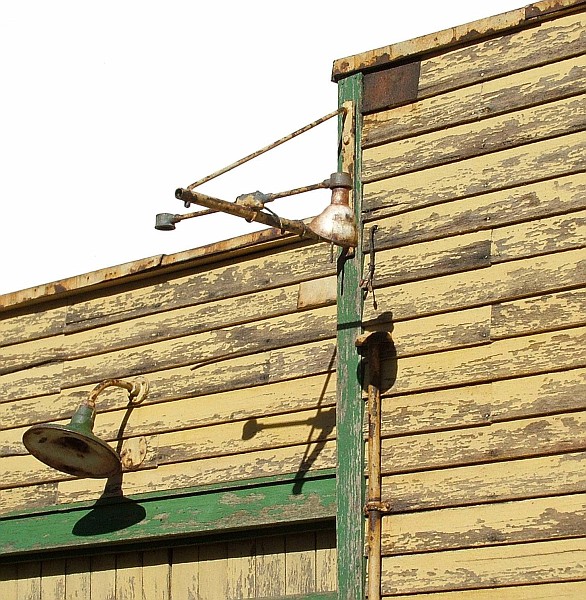

  John,  ill let you poke around for old bottles and magazines......while ill be looking up in the rafters for then old porcelain signs....NOS gas globes still in there orig box...oil cans....and calling a tow truck to pull out that old pickup thats behind them old doors ;D             Chuck you got to put a sign  on that pole ;)         Craig

Thanks for those pics, Craig-just the kind of weathering I was looking for. I was just sanding the parts for the lubester last night. 20 min tops, and I was ready to assemble. Still beats scratch fab time and gets me to my favorite part of modeling faster. Even the pump is cleaning up easy and so far I haven't broken the pipes off.
John, the layer lines are inconsistent so some are more noticeable than others. The penny pic above shows a part just primered and the lines do show. But they look worse than they are. They sand off easy and I think a light sanding with a coat of Mr Surfacer would make it go even faster. The lines go thru the part, so in the pic of the meter box, it looks worse than it is-some of what you are seeing is inside the part. If you go with really crusty weathering then maybe even less sanding required!  Russ, don't be afraid of a little modelling work!
