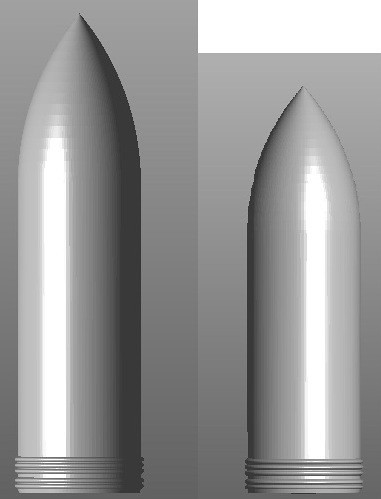

It's already in the stl.file. With my clumsy CorelCad program I am able to modify the system variable up to the ratio «10» (normally I am working with the ratio «6»).
This increases the file size noticable, but in this case the outcome remains the same...

Hm. Have you looked into Autodesk Fusion? Its free for Hobbyists, and the free version have al the bells and whistles we need for making 3D drawings for printing.
Is this something that pops up in the STL, or is the problem already visible in the native file you are working with?
You might have asked the Oracle yourself, but here is what ChatGPT-5 have to say on the matter:

Peter_T1958
Havard
Thanks a lot for your input. Up to now I never used KI to search for solving problems. Seems so I should change that habit... ;)
For CorelCad the advises are :
- VIEWRES = 20000
- FACETRES = 10
- Chord Height ≤ 0.01 mm
- Angle ≤ 1°
Although the commands are a bit different, I tried them out. Some were working orther failed. So I couldn't adjust the «chord high» and the «angle». Alas the result remained the same!
In my 3d-Tool viewer it was very easy to smoothen the curves, but (of course) this doesn't influence the original file.
Perhaps I sould try to find a solution with "blender"!?!
Lawrence@NZFinescale
I'm not sure how simple Blender would be assuming you started with an .stl.
I had a quick play myself and it wasn't easy. Very easy to smooth curves and to keep the desired edges sharp, but not both at the same time.
Starting with a quad based model would be easier I suspect. You really want to be sorting faceting before converting to triangles.
Lawrence in NZ
nzfinescale.com
Peter_T1958
Quote from: Lawrence@NZFinescale on August 09, 2025, 05:55:28 PMI'm not sure how simple Blender would be assuming you started with an .stl.
You were right, that approach did not work! However, a brief look at the today's delivery showed, that things are not too bad. I removed the supports relatively roughly and especially the big fundation elements are still bent out of shape. At least it becomes obvious, that this would become a big gun...
The imperfection is barely noticeable and paint may further camouflage it. I also wonder how resin castings from such a master would look. In our little modeling society perfection is always the goal so I hope you devise a way to achieve it. -- Russ

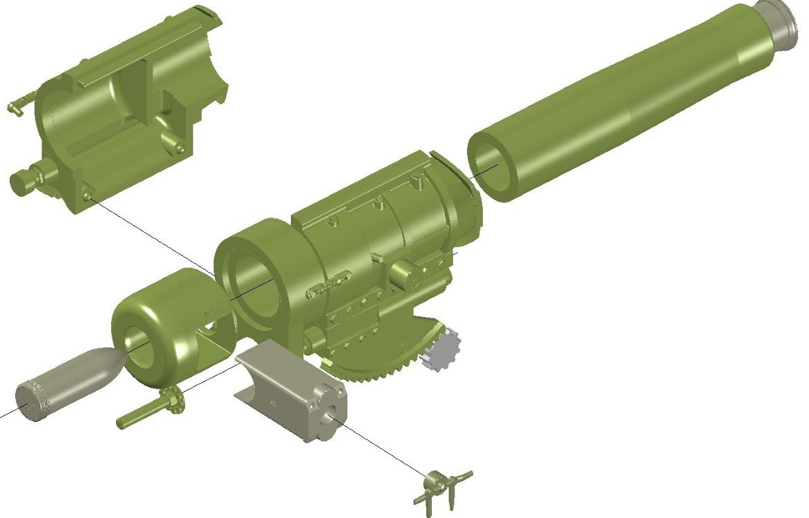

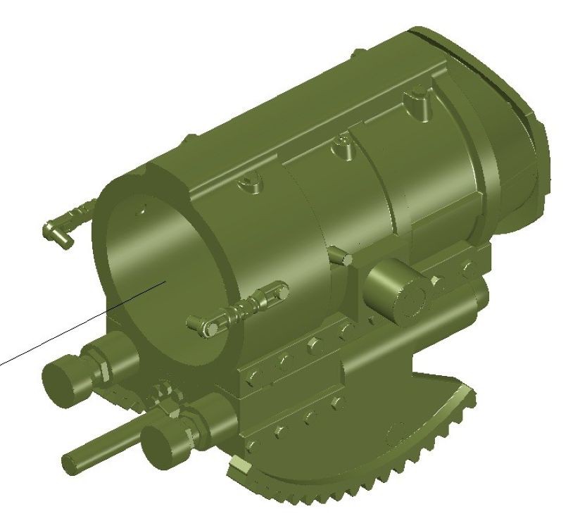

I found some time to continue on this project. That thing gets bigger and bigger. One point that is often overseen in kits, but at a calibre of this size it is  absolutely necessary to replicate : the rifling. My idea is to print the inner lining of the barrel separately to avoid supporting structures.
Peter_T1958
Ok, the gun is fished, ammunition is also available. So I am ready for a first test-shots!
Seriously now! Designing any subject in a CAD program is only one part of the whole task. Each part has to be re-thought as a kit part. Wall thickness, printability and assembling had been a huge problem for me at the beginning, but with increasing experience it becomes much easier.
And if I am uncertain, I create a «plan B» right from the beginning. Changings later on are always more labour intensive. That's why I made two cradles , a complete and a half shell one.
Please post a video when you fire the canon. And remember to fire it outdoors to avoid blowing up your house! -- Russ
