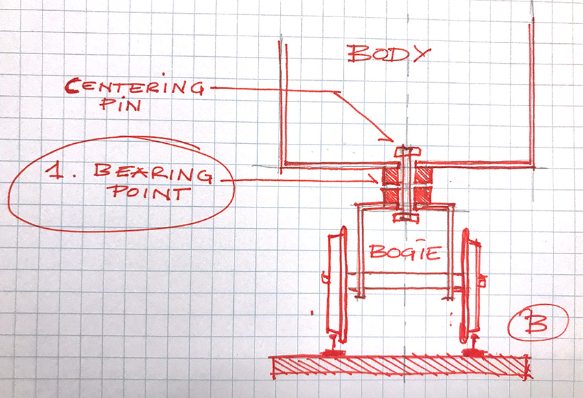

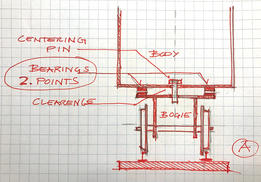

Regarding the attachment of the trucks (bogies) to the body; I used the "three legged stool" principle for my Westinghouse engines.  One bogie (A) is allowed to rotate freely in both planes. This is just like the drawing you postet right after I first posted this message!  The other (B) is allowed only to move in the horizontal plane.
I use that same principle for the wheelsets. One axle is fixed to the bogie (two "legs"), and the other is allowed to swivel sligtly (one "leg"). This works well for my bogies, since only the fixed axle is powered. A more elegant solution for making sure that all the wheels are in contact with the track would be to use sprung axleboxes. Unfortunately, mys skills are not yet up to that task.
When it comes to the wheels, have you compared the prototype wheel profile against your chosen Slater Wheels? I dont know If you you are planning a stand-alone model or have plans for more rolling stock and perhaps a layout. If the latter is the case, you should consider a complete set of standards. This would include wheel profile, back-to-back, exact track gauge, check gauge etc.

@ Harvard
It may well be that I am slow on the uptake, but I do not really understand what you mean with the first sketch. How exactly should I interpret that bearing points? Sorry!
Anyway, I have to point out, that the space between the upperside of the motor/gear unit is limited due to the motor located very (!) close to the centerin pin...
