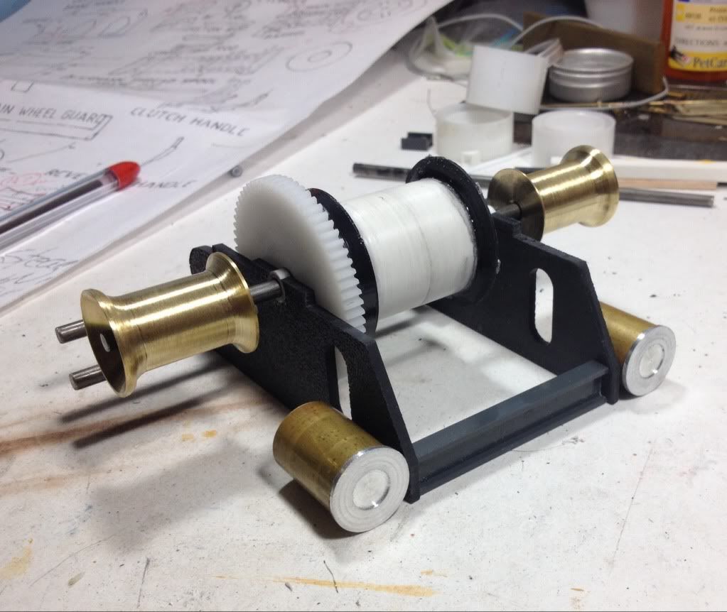

After you dye the parts will they then hold paint?

The dye does not make them hold paint, it just colors them.
If you guys recall I have used a few of these gears previously.
Not to worry.
Got the large capstans fabricated.
They started life as 1 1/2" long pieces of 1" bar.

Your usual fine machine work.  They look great.

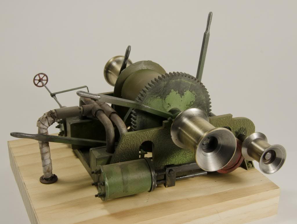

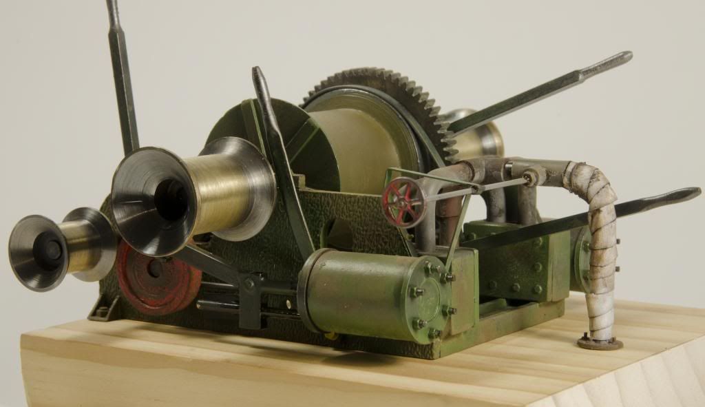

Anyway, I am finished with the winch.
I'm happy but not excited about the end result.
I think not having any good plans or reference photos really killed my enthusiasm.
I had to make a lot of "assumptions" which I don't like to do.
Hopefully my knowledge of steam donkeys may have helped?....
Thanks for looking.

Well You should be that is beautifully done!!!
But what am I missing, I don't see the steam exhaust?
You could have done worse. -- Russ
Max Corey
Looks very good and very feasible.  You have the plumbing right and the brake and clutch levers right my only thought...
The main side plates seem strange.  Every donkey or hoist I have seen used a cast iron side plate and it had openings and ridges around the edge and openings cast in.  But you probably know more than me.  Looks like a live steamer and could work.

Looks very good  8)

Looks great to me.  Glad your going back to the Shay!!!

Norcal - the steam exhaust is closest to the main drum and goes straight down.
Max your right, i should have added the perpendicular plates or ridges.
Hauk I dipped the brass capstans into a blackening agent, they went really dark!
Must be a different type of alloy (free machining naval brass I'm told from the supplier)
I could not get the effect to work on any other brass I have.
They are the best part of the model - I think!
