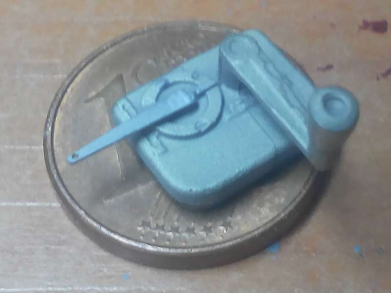

So I got down to the travel direction selector lever.
The lever is made ​​of 0.2 mm spring hard stainless steel sheet.

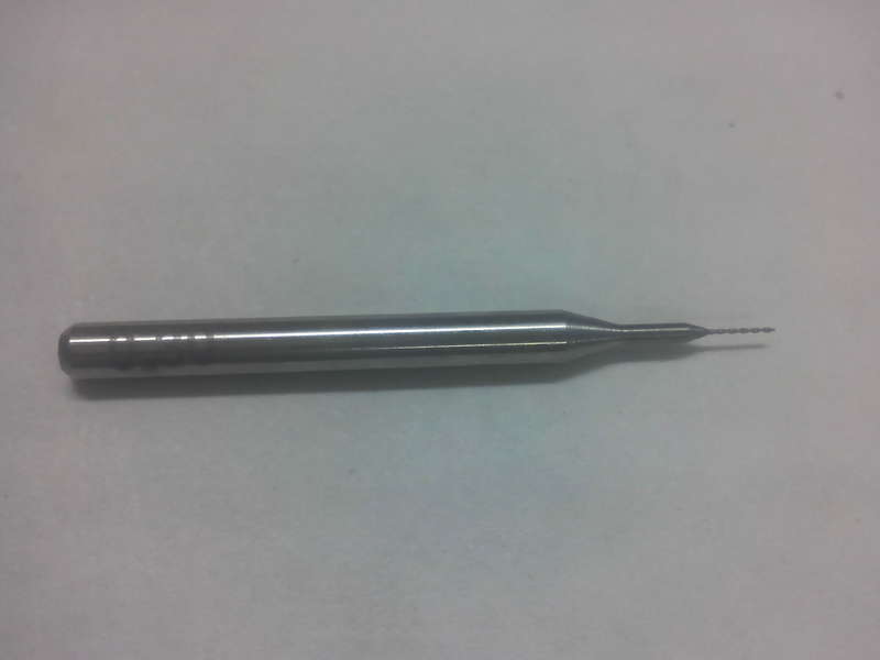

The first challenge was the 0.3 mm hole.
What came with this 0.3 mm drill.
On the travel switch, I have the travel direction selector lever then soldered easily.

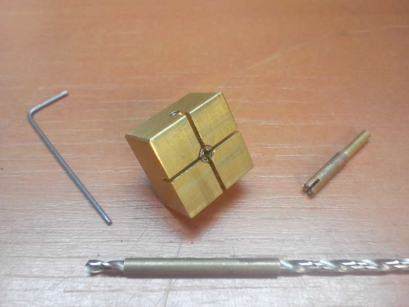

Parts and tools for the seat frame production.
Since there is no extra-thin-walled tube, I drilled a 2.5mm tube with an extra long 2 mm drill.
So I could make the double tube for the seat frame.
Thus, it holds better and was more stable, have I gotten support angle in the pipe.
These had to cross two slits are cut into the pipe.

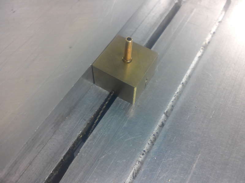

In addition I have taken a brass block and centrally drilled a 2.5 mm hole through.
So that the pipe I have not twisted when cutting a 1.6 mm hole drilled in the side of the block to the middle and cut M2 threaded into it.
With an M2 grub screw the tube can now be held during sawing.
Now just need the slots are cut crosswise on the table saw with a thin blade.
