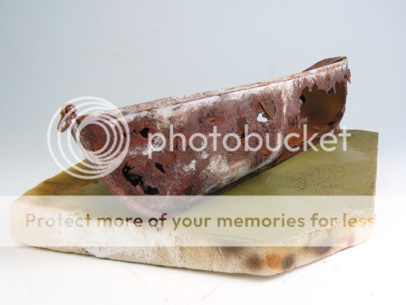

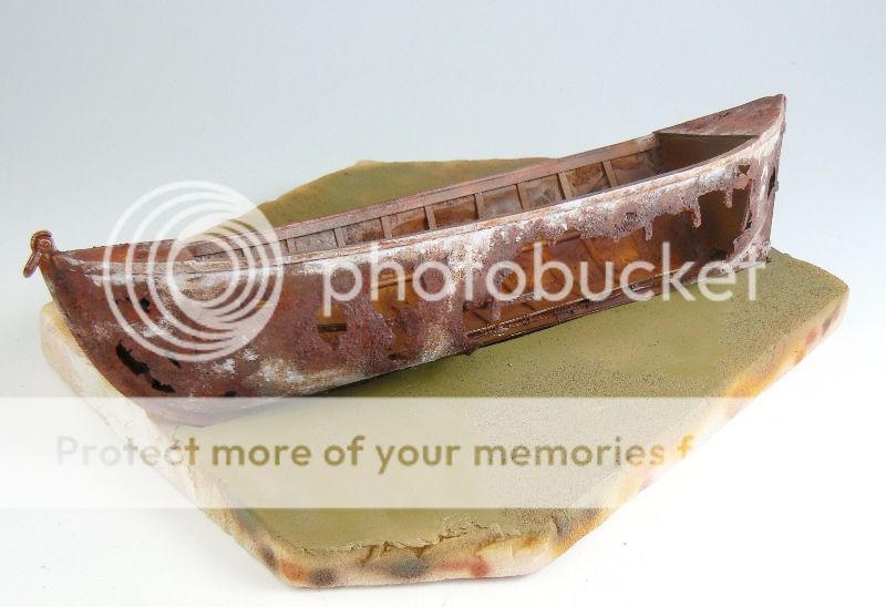

Trying at the moment to complete a finished piece based on some of the learning ........ should be a an old rusty boat have sunk into a grass  salt marsh , at the moment one side has been maybe 70% painted and the interior has been started , the inside is planned to be silted up probable with some grass growing in it as well
its a working base/cradle its sitting on but that is the planned angle of sit and the real base will probably only be fractionally bigger

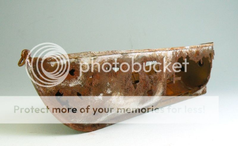

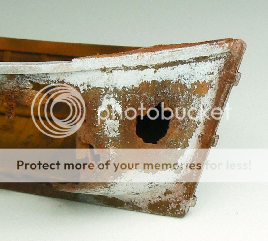

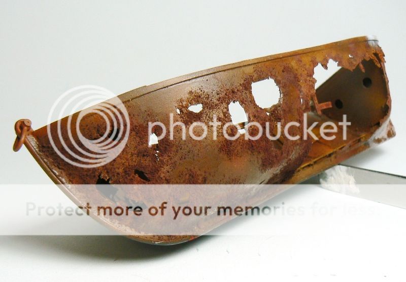

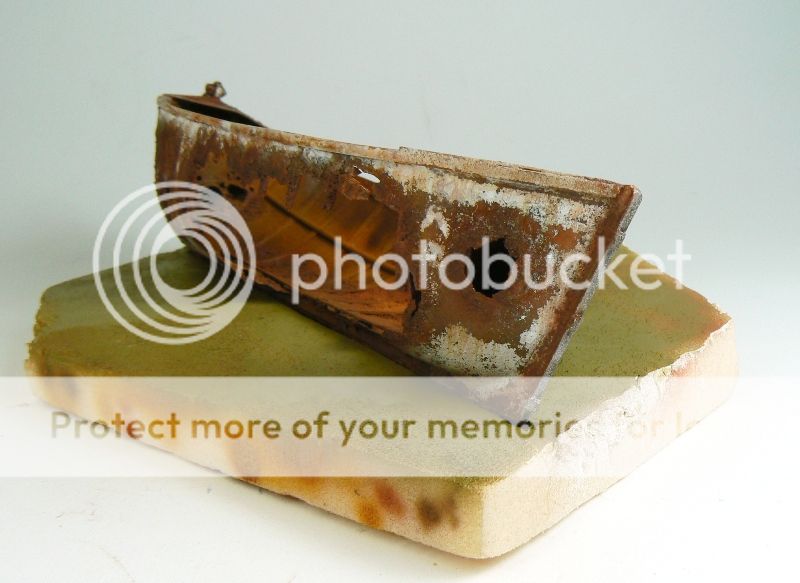

Thanks for the positive feedback.
Will attempt to give some info on the rust ;-

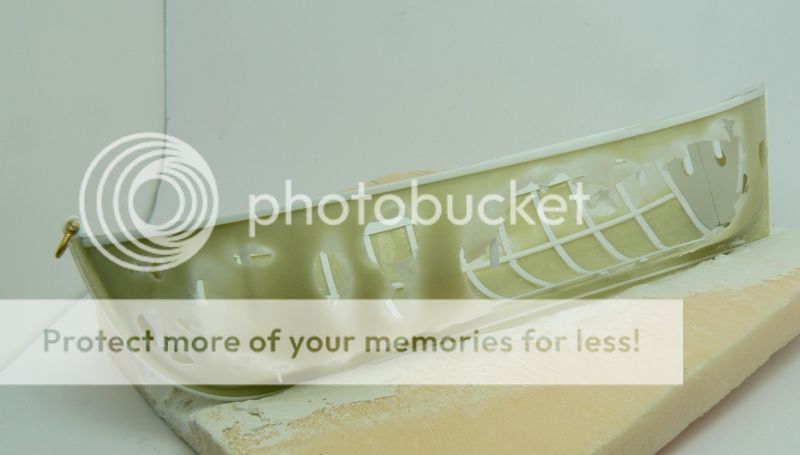

The origonal resin boat shell was detailed with plastic strip after some pretty radical thinning with the old dremel and grinding bit

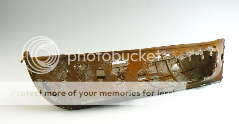

The shell was then given a mix of various rust shades using Tamiya paints and sealed with a light spray of dull-coat ..... this was just to provide a hard wearing base . Because my reference photos showed that under salt water rusting the metal showed serious corrosion , delamination of the metal + bubbling under the paint decided I had to add some texture. This was done by fixing some fine sand around the main rust areas

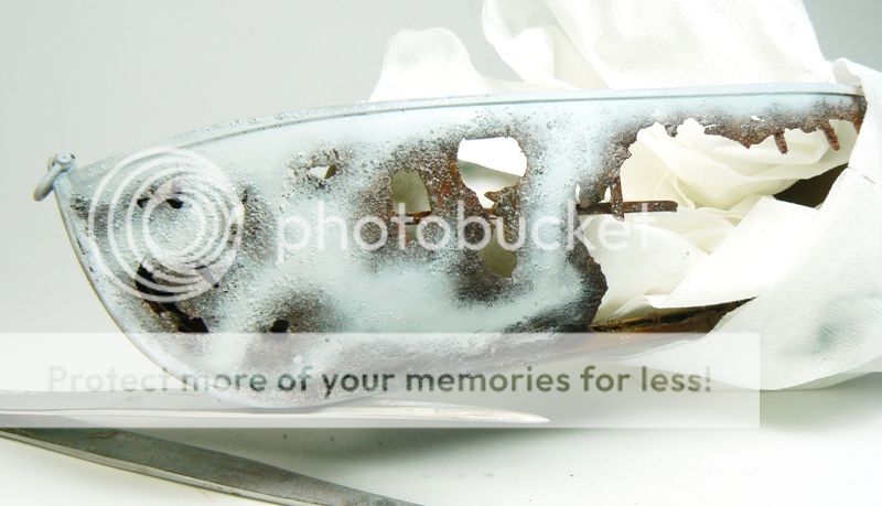

this additional texture was then used to hold the rust pigments which were then added and held in place with fixer, then a couple of coats of hair spray  were applied before  some colour was sprayed on.
After the majority of the paint was removed with water and stiff brushes, a light dusting of assorted pigments were added and finally a thinned mix of MIG rust oil paints were wicked into the rust pigments.
Hope this helps
