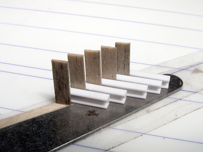

How did you build it? Did you use a jig for the stairs? For H0 scale it looks very good to me.
Quote from: Hydrostat on November 03, 2013, 12:52:12 PM
I  used a very simple jig for the stairs. Here is a an image taken during construction:
On a smooth surface I drew some parallel lines, and one line with the angle of the stair (a little less than 45 deg.) across. Using double sided tape I attached one stringer along this line. Close to the stringer I taped a piece of steel with the Sam thickness as the stringer. On top of this piece of metal I taped down a length go double sided tape. Then I started to glue down the steps. I used pieces of styrene channel as spacers. These were held I place by the two sided tape. The steps were aligned by eye using the parallel lines as guides.
A bit crude, but it worked Ok.

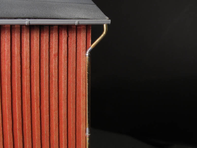

You write that the gutter is eched brass.
Where did you get the etches for the gutter?  How were these etches bent and painted?
Have you thought about using thin fuze wire wrapped around the down pipe?   Mount these to the building wall.  This is used to hold handrails to locomotives.  The fuze wire would be nearly invisible.
I read back through the thread concerning the roof.   I live in the North East USA.  I have been inside many old building and barns.  Most roofs start to sag when the foundation decays and the base sills of first floor beams start to rot and  structure sags.  Barns and old homes did not have good foundations  The only other reason is the roof starts to leak and the subfloors and joists start to decay at the upper floors.  Keep a roof and foundation  tight and the structure will last a long time.
Quote from: glaskasten on February 07, 2014, 02:13:10 PM
I got them from a swedish company called Teknobygg:
http://privat.bahnhof.se/wb616757/
They make a lot of nice detail castings and kits in different scales.
The etches are already bent when you buy them, but they need to be straightened a bit. I insert  a 1mm diameter pianowire into the gutter, and use a pair of pliers with broad, smooth jaws to press the gutter snugly against the wire. The gutters are painted with Tamiya grey fine surface primer. Then a dark brown wash from Mig products. I finish with some pigment powder. Nothing fancy, in other words!
