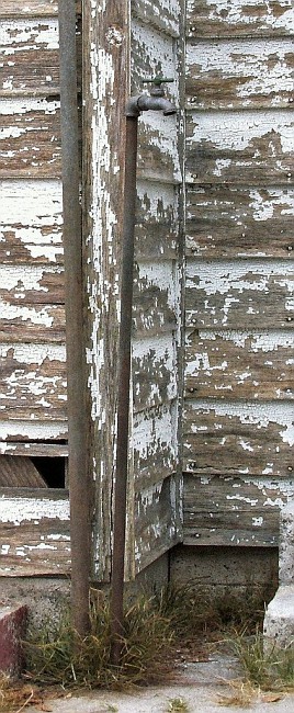

Here is the faucet installed (in a non-printed scene):
Chuck, that's totally disgusting. Nobody should be that talented! -- Russ
billmart
There's just no way for me to tell if that's a photo of a full-size building with plumbing, or if it's a photo of a model.  Absolutely outstanding work, Chuck.

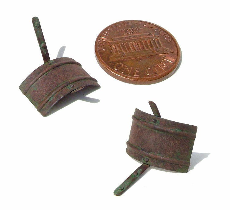

And now for more miniature mundanity:
Common hose rack made from Evergreen half-round styrene rod glued to .01 styrene sheet. Then  rubber banded around a socket wrench and dipped in boiling water to heat form the curve. Mounting bracket is .015 x .06 brass strip. Tichy model RR rivets and Grandt Line hex bolts complete the basic assembly.
Primed with Testors Flat Black spray followed by a coat of hairspray and then Dullcote spray to seal. Then thinned acrylic green was brushed on and when dry, a stiff brush was used to chip away the paint.  Then rust colored gouache and pigment powders were applied to the exposed black followed by a spritz-from-a-distance coat of Dullcote spray to mottle.

Chuck the "spritz-from-a-distance" dullcote, is that when the spray is kind of broken up, because it was just a quick burst leaving a spotty coat of the dullcote?
Sorry if you've explained it elsewhere and I've missed it, thanks in advance. Cheers
John in Australia
#385
Exactly John. I usually hold the item below the can maybe 10-12" away and do my best to give it a quick burst or two. I find it can be redone with a new application of powders if unsatisfactory.
I think you might have to put in the old quarter or penny in the next photo.
