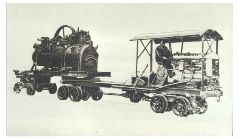

Here's another Fordson for you, Gordon:

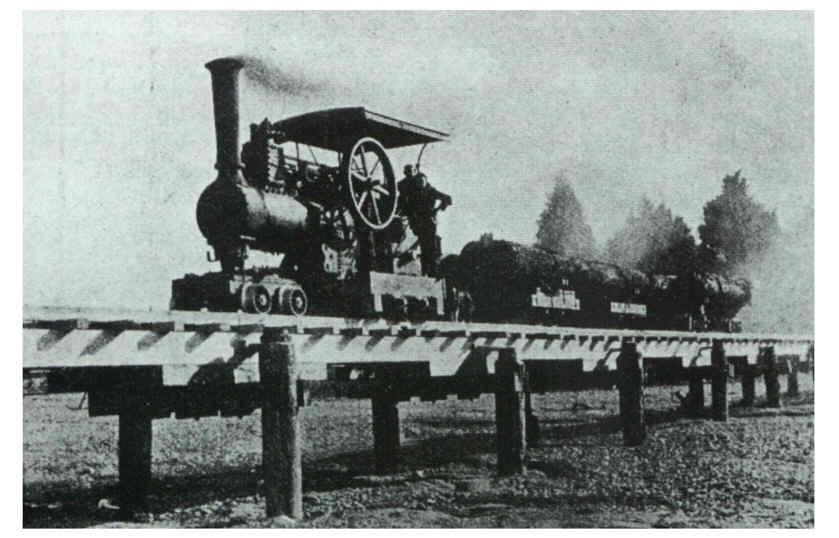

This is a great shot, of some amazing traction engines:
http://www.flickr.com/photos/27712868@N05/2817299342
