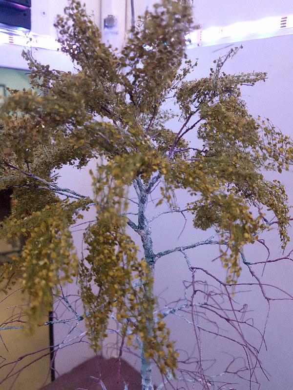

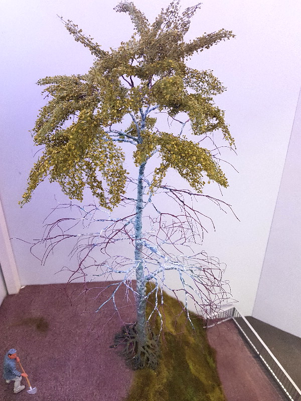

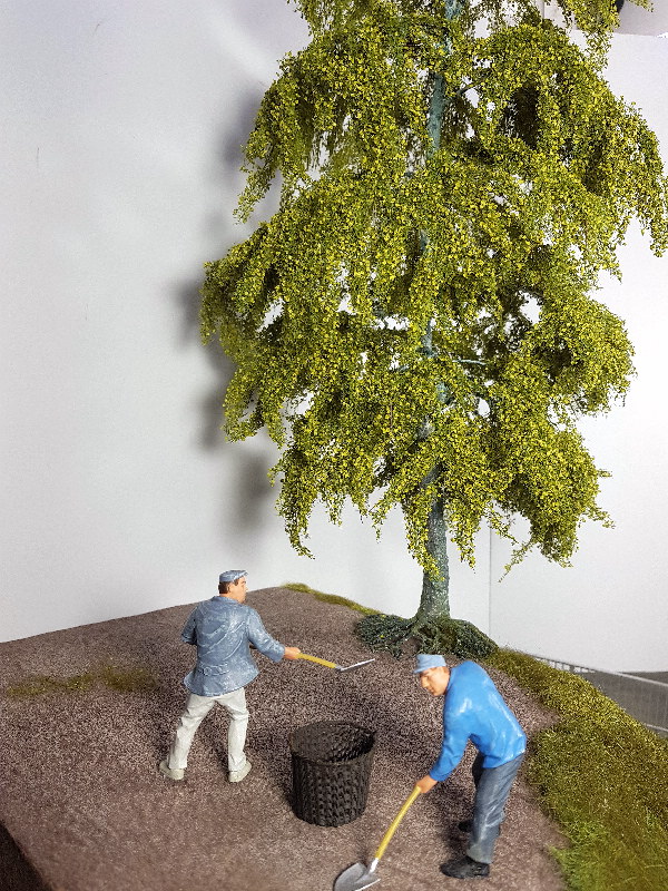

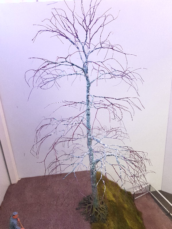

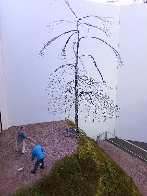

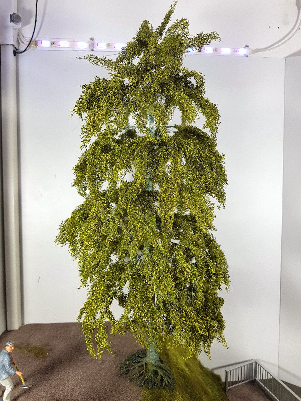

Happy,
I have never built a tree before and after I wasn't satisfied with everything there was to buy, I set out to build my very first tree.
Here, 170 m 0.4 mm connective wire is in the works for a tree blanh of 500 mm height.
After the finished turn out, I soldered the twisted wires.
Then I sheathed the trunk and thick branches with a flexible terrain spatula and then painted it.
The birch trees at the monastery tunnel had a strong moss growth and, of course, even stronger on the weather side. I took that into account when painting, of course.
I started unloading at the top, as it can be seen less in the complex later.
For the unloading, a matte birch holiday used spring from Mininatur for large scales.
From the mat I cut myself in fiber direction about 30 mm wide strips.
From these stripes I cut off the right piece for each individual branch and glued it to the branches with tesa multipurpose glue.
The adhesive is solvent free and water soluble. I consumed about 0.3 m ≤ of birch leaves.
The construction of my first tree has given me many happy model building hours. This means that the afforestation of the Klosterstollen model can continue to be operated.

No green vests. That's a Health and Safety violation.  10 minutes in the penalty box (corner). Tongue
Posts: 6096
« Reply #247 on: January 21, 2019, 01:38:30 PM »
Why are those little men trying to bury your beautiful tree? -- Russ
Posts: 875
Klosterstollen
« Reply #248 on: January 21, 2019, 03:31:16 PM »
Hello Lawston, in Germany needs to be worn in work without machines, on plots, no warning vests.
HI Russ, the workers are supposed to dig planting holes, for another greening.

Helmut, That's a very good first tree! I need hundreds of bare winter trees for one side of my layout. I am planning on making a few wire trees that will get the attention of the viewer but the others will be less detailed so that there is a chance of completing them all.
I meant to ask earlier. Is that a 3D printed basket that the workers are using or is it a real basket?
Posts: 875
Klosterstollen
« Reply #250 on: January 22, 2019, 07:19:33 AM »
HI Bill,
Thank you for your feedback and the basket is woven from 0.2mm copper wire in 2 gorgeous relaxing days and then brooded.
The basket belongs to a crab cutter and serves there at the mast as a daily signal of trawling fishermen.
The twisting and turning of wire is about a third of the work, another third is needed for the coating, molding and dyeing of trunk and branches.
« Last Edit: January 22, 2019, 07:28:01 AM by Design-HSB » Logged

     The wire armature for the tree is certainly an "old school" method of making the core of the tree.  I have recycled electrical cords which have reached the end of their useful life because of the fine wire in them which makes them so flexible.  A touch of heat and solder near the base keeps everything from unraveling.
     Once the core is roughed out, I cover it with brown florist's tape and then pose and paint it.  The tape gives a good base texture for the bark and unless it is close up fine enough for me using a mixture of artist's paints and Gesso I just paint it.  Still need to be able to carve a heart and initials into the bark in 1:48 scale.

thank you for the recognition and suggestions. Yes twisting wires is old school and I still think the best method. Since I had no old copper cables I took iron binding wire that I had. This goes very well and even has an advantage of the thin wire is not quite as flexible and 0.4 mm wire fits very well with me on a scale of 1:22.5. Only I have built a birch and the cracking in birch bark goes ehr not and beech seem to me most suitable. Since all the trees on the "Klosterstollen" actually have their wildly total, there are actually no beech trees.
