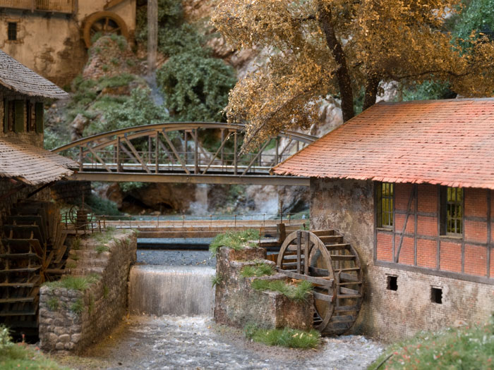

I remember a thread of an exhibition. The Dutch modelbuilder Jacq Damen showed the following scene.
Maybe it can inspire you a little!
Here  are some more pictures from this layout.
Do you know this provider of real stones in 1:32.
Furthermore, a speedy recovery for your hand!
Frithjof, the starter of this topic (Jacq01) and the Jacq Damen you mentioned in your message are the same ........... Grin Wink

 Frithjof,
Quote
 memories, memories.
  Building the 3 mills in H0 was a challenge in concept and use of materials. I hope the adventure in 1:35 will give me as much pleasure and challenges as the H0 layout did.
