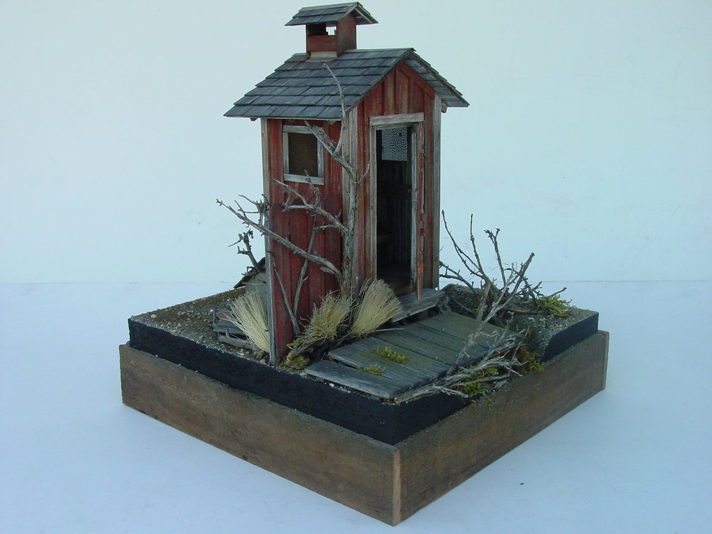

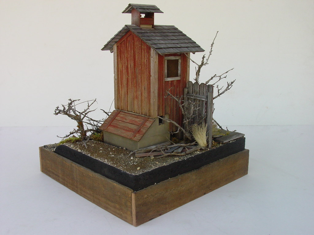

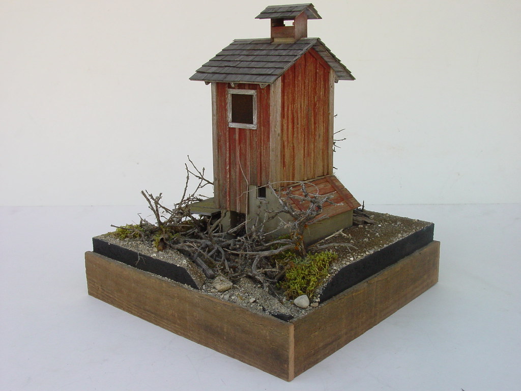

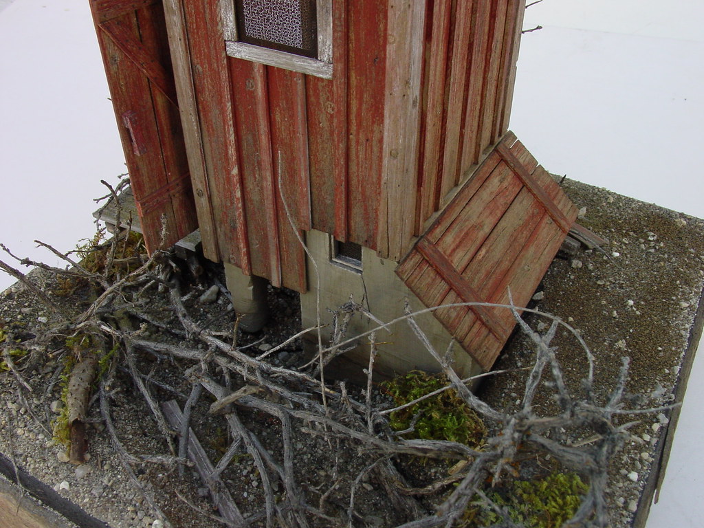

Here are 3 photos of my third privy:

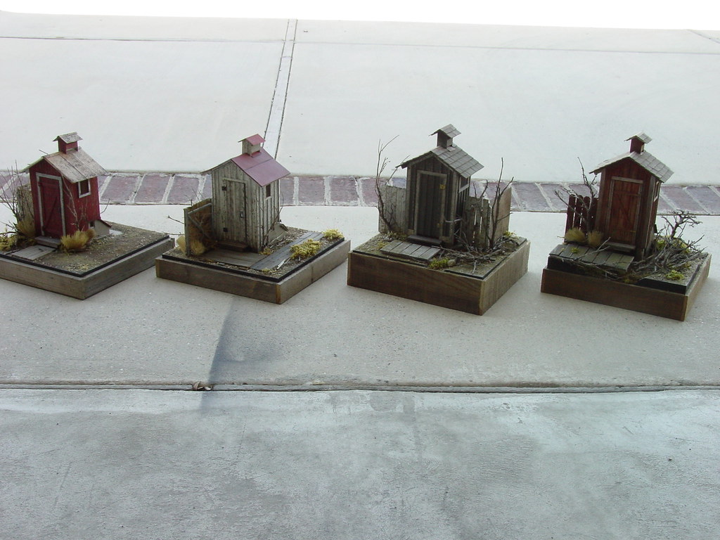

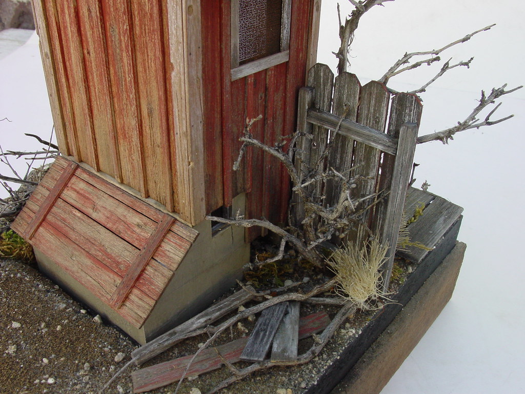

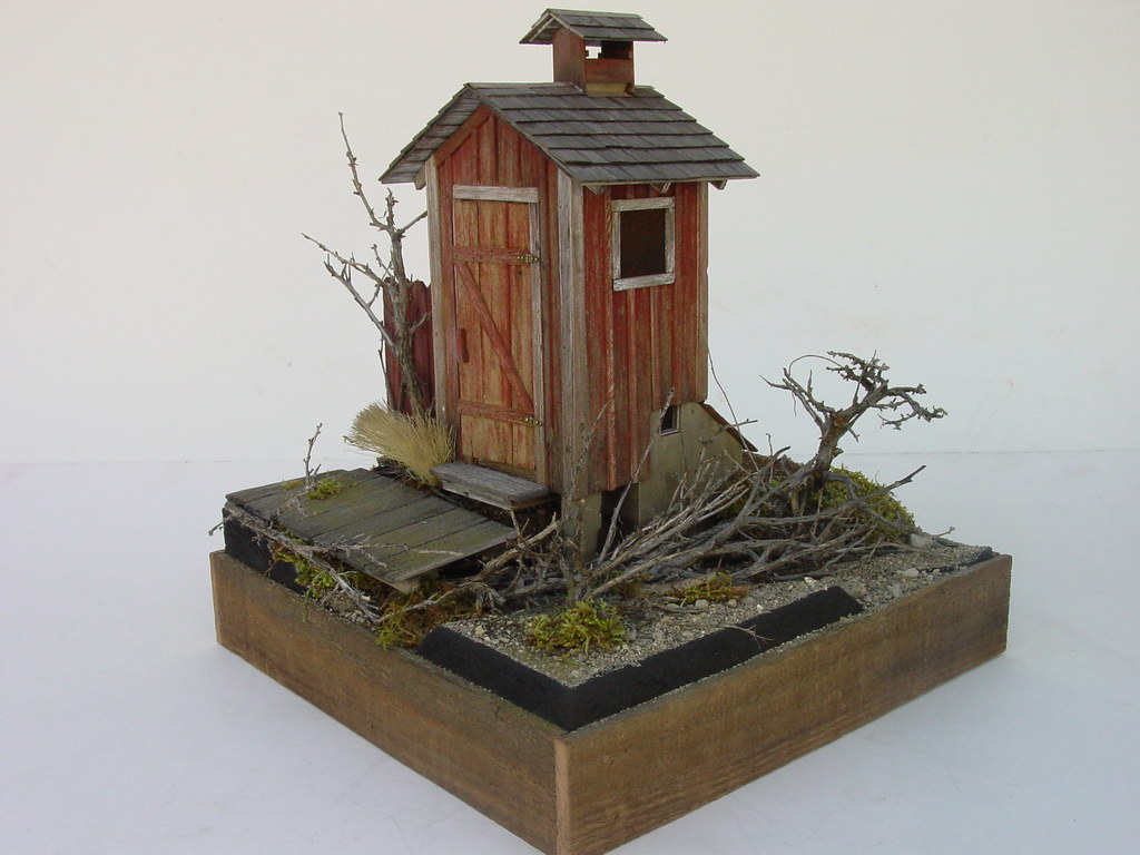

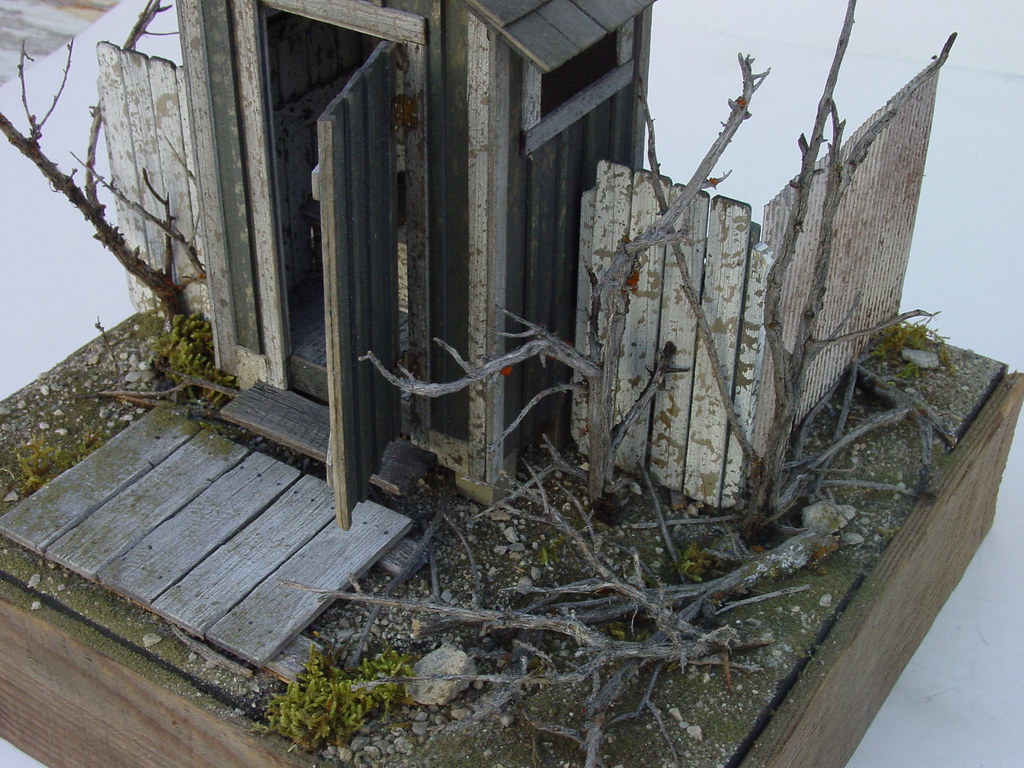

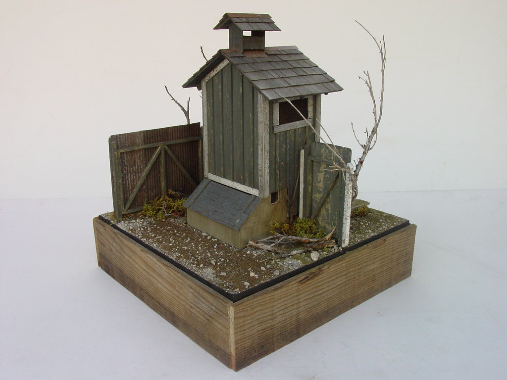

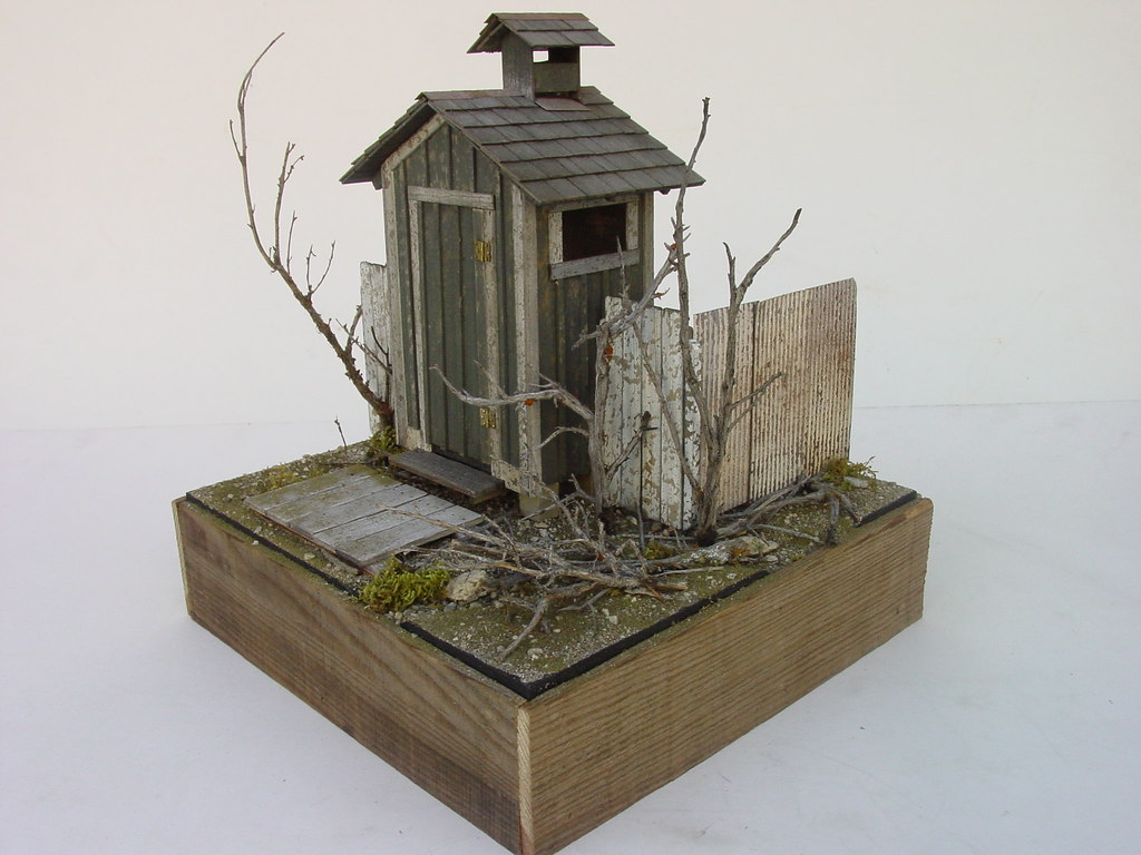

Here's 4 more of the fourth:
On the fourth privy I used a no-paint technique where I used wood stains and pastels. I'll have a step-by-step soon.

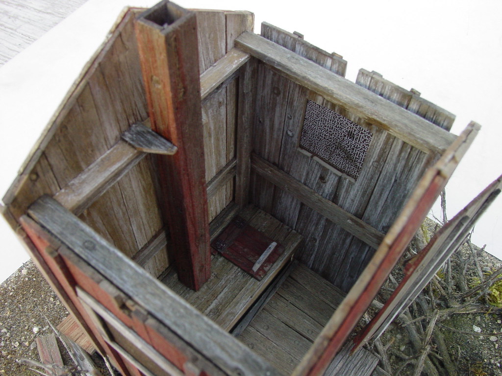

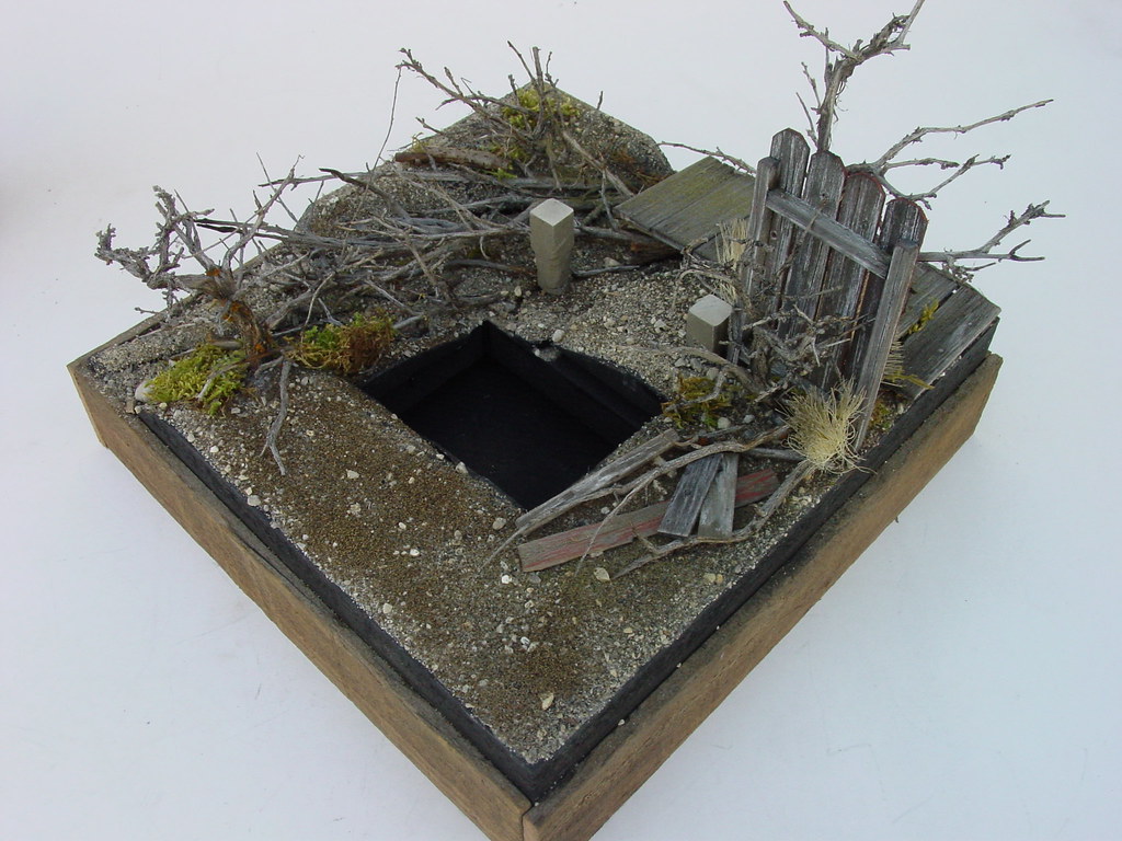

Guy's start out buy distressing a little or a lot. In this large scale I'm using a round battery terminal cleaner brush and a hobby knife. For the knot holes, I punched them with a short piece of brass tube. The nail holes are made with a steel pin.
I used both Silver Wood and weather-It on the privy. I started out with the Silver Wood but ran out before I finished. The Silver Wood are the lighter areas.(The doors, the back wall and interior) and the Weather-It are the darker areas. (the boards under the windows.)
Now using a HARD pastel running it with the grain pressing down hard or softly.
I applied a light coat of Dullcote from a rattle can to fix the pastel. There is no problem in doing any of these steps again if you need to darken the grain with the stain or add more pastel. After the last coat of Dullcote has dried , I did some light highlights on the corners without fixing the pastel. If this wears off you can always do it over.
The shingles are tapered using sandpaper.The grain is added with my battery brush. I covered all the surfaces of each shingle with a coat of Weather-It. After all the shingles are on the roof. I applied a few coats of Silver Wood. finishing with a coat or two of Dullcote. For more photos of the forth privy and some test boards go over to my Flickr page.
