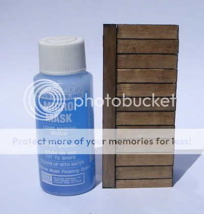

Was browsing through the web, and came across this on a German forum.....the idea is not original....I think it is the method Marcel Ackel employs.....but the results that were achieved by this modeler are not bad.
The original item:
This was then stained with an Oak stain (being on a EU forum it was likely water based stain). The entire piece was then covered with masking fluid (brush applied)
The whole thing was then brush painted with white "emulsion paint"? (Dispersionsfarbe).....and then peeled using masking tape.
....I am assuming the scale on this was 1/35, or larger.

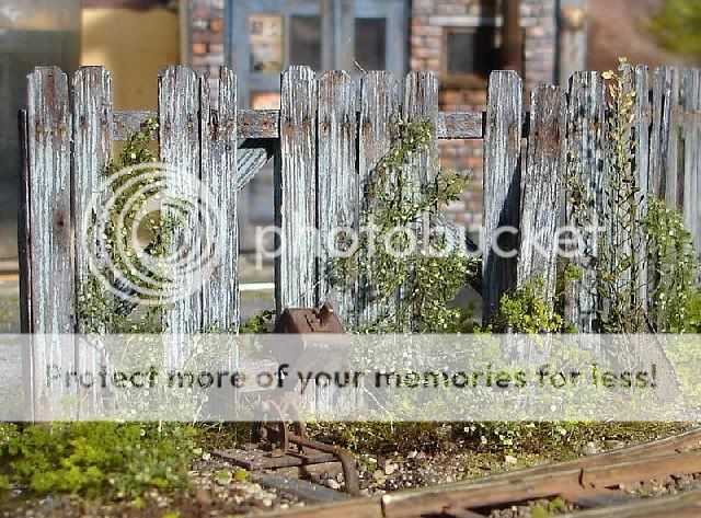

may be I got it wrong but as far as I know Marcel is using Gum Arabicum when he weathers wood. He is only using watercolors to stain the wood prior to use the Gum Arabicum as a barrier layer.
Harald
Harald,
You are correct...I was mistaken...I was sure he used the masking solution, but I found his fence thread on Modellboard.de, and he notes he used Gum Arabic.
A photo of Marcels fence for those interested:
HA...I knew I was not going completely senile  ;)...apparently he uses the masking solution as well.
Here is a photo from one of his SBS threads:
...here is the link to the thread:
