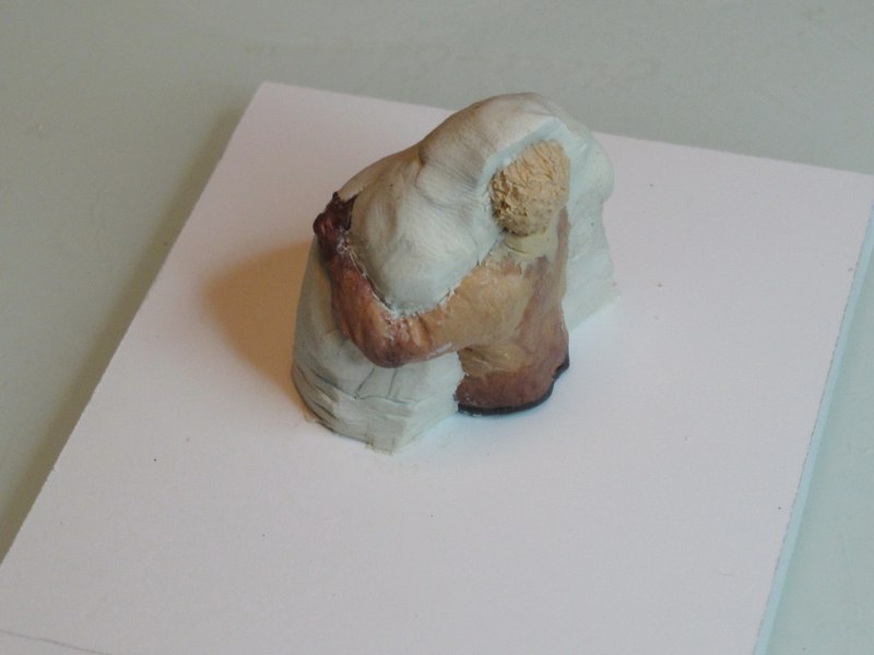

Here's another little project I've got going. I've sculpted a figure of Cris' grandmother, who is 104 years old. This figure will be seated in the back of my rail bus, so I eliminated the lower legs in order to clear the electronics located under the rear seats.
Anyway, I decided to try making a mold of this figure, so I can cast resin copies. This will allow me to replace the figure if it ever becomes damaged or faded. I'll also be able to make duplicates to put inside buildings or passenger cars. If this works out, I will do it with all my future figures. (I can't do it with existing figures because they're painted, which fills in some of the finer details.)

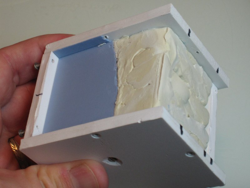

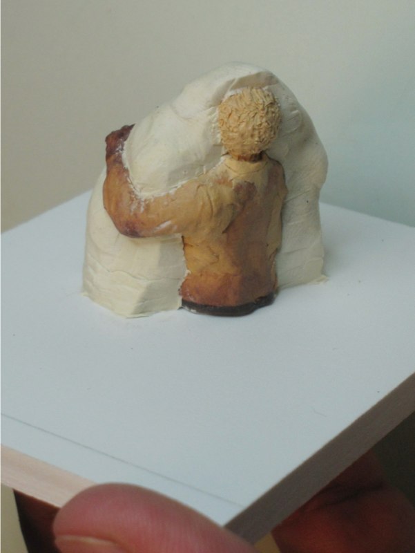

I mounted the completed figure to a piece of 6mm Sintra PVC foam board. It is secured by a screw from underneath. Then I started adding some plasticine clay to divide the mold. It is important to use only sulfur-free clay, to prevent contaminating the silicone molding compound:
At this point I built up a box around the figure, using more of the 6mm Sintra. No glue was used -- it's all held together with #2 x 3/8" stainless steel, pan head, sheet metal screws. This way the box can be assembled and disassembled as needed:

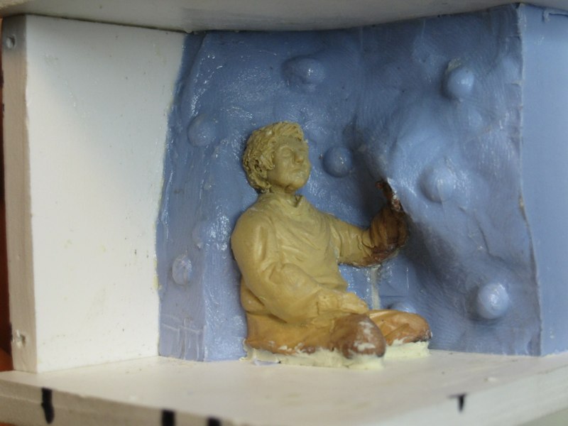

Then I started packing in clay to fill the area which will become the second half of the mold:
I smoothed it as best as I could, then used the end of a paint brush to press small dimples into the clay. This will help to keep the two halves of the mold aligned during casting. After I shot this photo, I decided to add a strip of styrene from the arm's elbow, down to the base of the form. This will help prevent air getting trapped in the arm, and allow the resin to get all the way into the arm and hand -- I hope!

The next day, I opened two sides of the form and starting prying out the clay. I used a small screwdriver to gently dig at the clay. The clay doesn't stick, so it pulls away from the figure pretty well:
I replaced one of the sides on the form, and removed another for better access. Then I removed the rest of the clay. There was a tiny gap under part of the figure, so I smeared a little clay into the gap to keep the silicone out from under it:

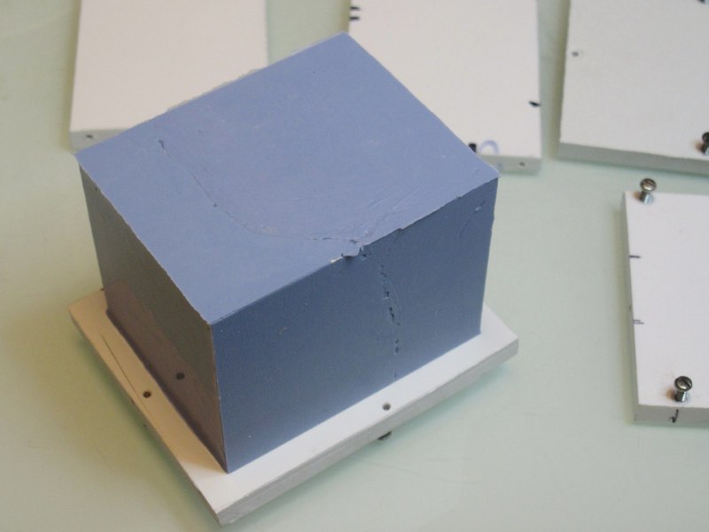

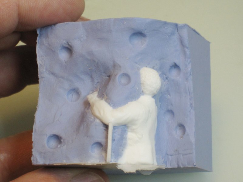

Then I replaced the side of the form and poured the silicone molding compound into the open end. I let it cure overnight:

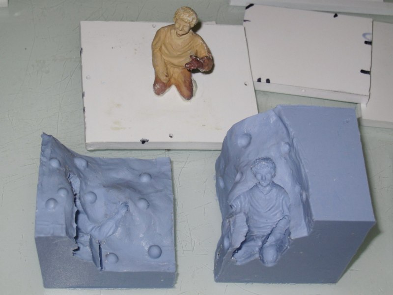

The next day I disassembled the form, and pulled apart the two halves of the silicone mold:
I coated the mold inside and out with a mold release spray that I bought at Michael's, and let it dry:

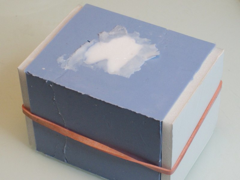

The mold was held together with a rubber band and two pieces of foam core art board. Then I mixed the resin (Smooth-Cast 300) and poured it in. I placed a small scrap of wax paper over the opening and held it in down with a flat weight:

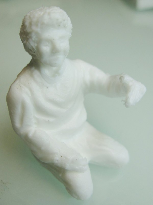

This resin sets up after just a few minutes. I opened the mold, revealing the first casting. Looks good so far...

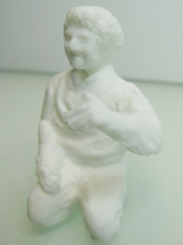

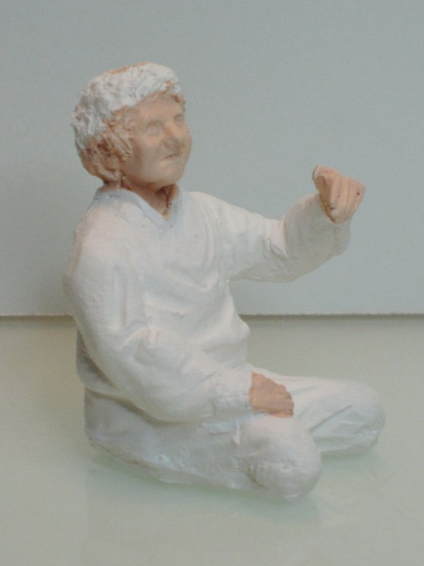

The good news is that there is minimal flash, and the arm and hand turned out well. However, the first casting revealed a couple problem areas. Air trapped in the face area caused large gaps in the nose and chin. Now that I know this, I can correct for it on the next casting:
When I made the second casting, I didn't put the two halves together right away. Instead, I mixed the resin first. Then I dabbed a couple drops into the face area. Only then did I put the halves of the mold together, and pour in the rest of the resin. This made a big difference.
The second casting has only a couple very small surface bubbles, which can easily be filled with modeling putty:

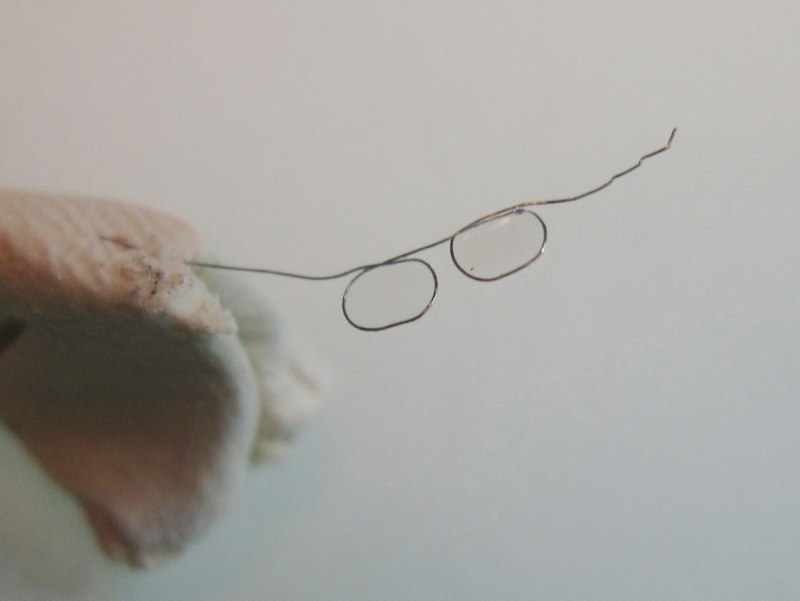

Before i get into painting, I'll show how I made the glasses. I started by putting together a form. This was made from two .080" styrene rods, with a .040" x .080" strip as a spacer between them. I wanted to see how fine a wire I could use for the glasses frame, so I found a grain-of-rice bulb that had very thin stranded leads. I separated the strands and used one for the glasses, wrapping it around the form to get the basic shape:
After removing it from the form, I used tweezers and a needle-nosed pliers to adjust the shape as best as possible. Then I stuck one end in a small blob of clay to hold it in place while I added the "lenses". These were created by dabbing a tiny smear of gloss, acrylic medium to each opening in the frame:
The wire is almost as thin as a human hair, so handling and manipulating the glasses is a real challenge! Here's the finished piece next to a penny:

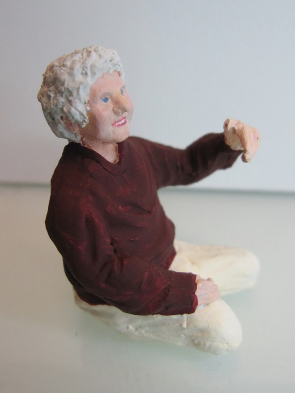

Now, on to the paint... I started by spraying the casting with a coat of white primer. Then I used craft acrylics to paint the hands and face, beginning with a basic "flesh" tone:
Next I added some very subtle shading to the face. I mixed a tiny bit of red into the flesh tone, and applied it to the cheeks and other areas. A slightly yellower flesh tone was used on the sides of the cheeks and on the forehead. Then a faint bluish tinge was used to create some shadows where needed. All of this is extremely subtle and probably not noticeable except in an extreme closeup. Anyway, then I painted the teeth, the lips, and the eyes:
I painted dark maroon base coat for the shirt, and painted the pants vanilla white. The hair was painted a slightly gray off-white color:
I dry-brushed a faded red-brown onto the shirt. Then I gave the whole figure a very thin wash of dirty black (black with a touch of brown). I used the tip of a brush to sop up excess paint from the wash. When this dried, I dry-brushed some white on the hair to add highlights. Finally, the figure was given a couple coats of Kyrlon UV-resistant clear matte.

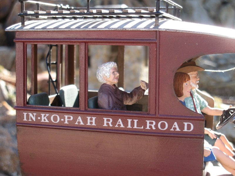

At last, the figure was mounted in the railbus and secure with tacky poster putty:
As far as the sculpting goes, this wasn't my best work. I should have spent a little more time on the face to get a better likeness. But it's close enough.
